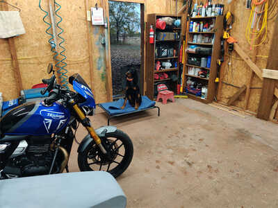

Some outdoors pictures.
Matched the hood line with the rake of the bike. This will help when matching the paint lines between the bike and sidecar.
Ground clearance.
Tire wear slightly inset. Added a bit of lean out to the bike after returning to the spyder's den.
Still to do is adjust the sidecar tire camber.
Spyder Monkey wanting to know what "victim" means...:D

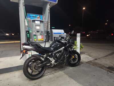

Here is what i have been wasting some rather limited (lately) free time on.Β  A "free" Yamaha 2008 Yamaha FZ6.
A good friend gave it to me, when his BIL offered to let him haul it off, 6 years after it tried to kill him in LA traffic with a wheel lock up at 70 mph in the left lane.
Rumor had it that the engine/transmission was seized, and it was a parts bike.Β  Sat near a warehouse, under a tarp for 6 years.
Free bikes are a lot like free puppies... the fun began with figuring out why it wanted to kill its prior owner.Β  Much therapy was required!
Turns out the front brakes had developed a nasty habit of locking up at highway speed due to dragging seals and a plugged up port in rhe master cylinder that didn't allow pressure that built up to bleed off.
Once rolling, found a few issues with fork seals and a blown pressure regulator in the FI system, but all fixed now.
It's current mission is lane splitting on a 26 mile daily commute with several long stop lights. Knocks 30 min off a 1 hour commute, each way.
Thinking that a really light HP sidecar might be fun, in it's future, but still mulling that around.Β  It is a lot of fun to rip around on as a solo bike.Β  100 hp, 450 lbs wet.Β  R6 4 cyl engine, but set up as a sport tourer vs track bike.Β  14k redline.

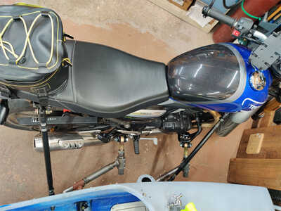

Wow!Β  🤩Β  The FZ6 is an awesome bike.Β Β
Something to ponder.Β  I specifically built Speedy & the Spyder so that the Spyder could stay in it's web, while Speedy and I have two wheeled fun.Β  I'm betting you could design something even better for the FZ6.Β  Like the Speed 400, the FZ6 has a steep rake, even less trail and a short chassis.Β  So it's a good one to work with without the need to modify the bikes geometry. 😎Β  Β
Speedy is as simple as removing the two upper clevis bolts, two lower Joint bolts and two electrical plugs mounted on the bike. Cleaning up the appearance is a matter of removing four bolts on the front lower bracket.Β  Everything else is pretty discreet.Β
Mounted Up

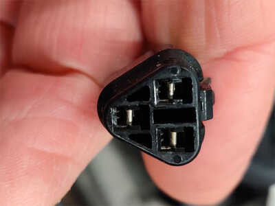

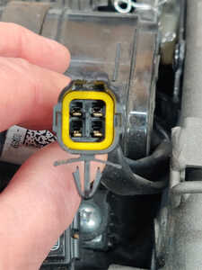

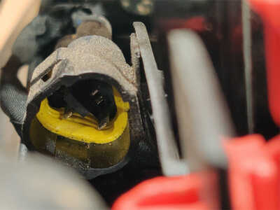

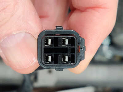

Trying to figure out what connectors the Indian mfgs use can be exhausting.Β  Ran into the same issue on the old KTM 390 built by Bajaj.Β  Now it's round 2 with this Triumph.Β Β
The goal is a break out harness for Brake, Running, Right Turn, that plugs into the existing harness connectors. Along with searching through all the regular suppliers (Eastern Beaver, Cycle Terminal, Kojycat, etc.), I've even run through all the automotive suppliers I've used in the past.Β  Β
Harness is made by a company in India called Dhoot Transmission Pvt limited.Β  It's like they make their own connectors, which makes no sense.Β  In this case the connectors are very similar to a Sumitomo MT090 connector.Β  But just different enough that an MT090 won't work.Β
4 pin connector for Running/Turn signals:
Turn Running Connector
Turn Running Harness
Brake lamp connector:
Brake Lamp Connector
Brake Lamp Harness
You can see how the locator tab is just a bit different.Β  There is a company that specializes in finding connectors.Β  If I can't figure this out by c.o.b. tomorrow, I'll contact them.Β  If that fails I'll get a job with Dhoot making harnesses for the Speed 400, and sneak out with what I need.Β  🤣Β
