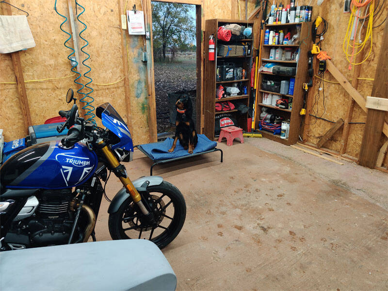

I've been wondering the same thing for the past year. 🤔
Evidently Royal dogs of Scottish descent require a dry and protected perch on rainy days, where they can view the grounds in warm, dry comfort. 😉
Why No Ride
