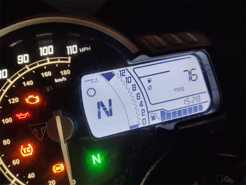

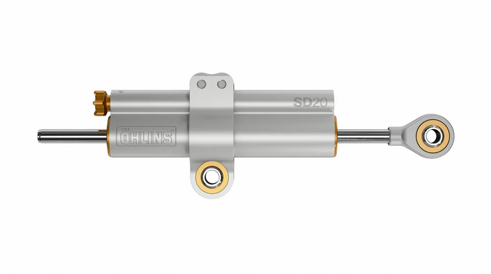

250 miles of fun on the rig now.  Yesterday's ride was 50 miles of the worst roads in this area.  Wanted to see if anything would break, or come loose.  Rig did great.  I may have a few loose fillings.  Seriously, I'm impressed with how taunt everything is.  The rig will do well to get a steering damper though. It is twitchy over poor road conditions. Going to have to get creative with mounting one up.  Thinking along the lines of a short shaft Hyperpro or Ohlins to fit under the steer head.  Leaning towards the Hyperpro RSC.
https://www.ohlins.com/en-us/motorcycle/supersport/steering-damper-sd20-stroke-70-ti?f=1&brand=universal&model=universal&year=all
Hyperpro RSC Damper
Today was 50 miles in some pretty strong headwinds on U.S. 40.  This is where the small displacement shows.  Thankfully the sporty styling with the small fairing allows for a pretty good tuck position.  The wide bars allow for using one arm/hand, and tucking the other in.  Was able to maintain between 60-65mph with the bike in 4th and 5th gears.  Long, fast freeway riding is not what this rig is about, but was a good test.  Lowest fuel mileage reported on the display was 34mpg, and the overall average with the sidecar has dropped to 76mpg.  Think that will continue to drop, until a more accurate reading is attained.
Average Fuel Mileage First

Steering dampers are nice in the rocks, as well. I like the mscmoto one I mounted on the steering head, it has held up to some abuse.  They claim a lot of adjustability, but in practice, it feels to be mostly binary.
I leave it on max, most of the time.  It isn't needed on the pavement, since I got most of the flex out of the system, but it absorbs a lot of the twisting in the rocks.
Posted : November 6, 2025 6:10 pm
Posts: 1293
When I raced Off-Road and MX, the bikes all were fitted with Scotts dampers.  The Scotts dampers have separate high and low speed circuits, and adjustable sweep for each direction. I like low speed damping almost completely off (especially on an MX track), requires too much body language/energy.  Of the different dampers I tried the Scotts dampers suited my riding style best.
Everything is built so compact on the Speed 400, that a Scotts damper would be very difficult to fit, and have it work properly.  The tie pin needs to be extremely stiff in its mounting.  Same for any damper really.  The cylindrical dampers make mounting much easier, but not sure I'm going to like the single adjustment in comparison to the Scotts damper.  Kind of a spendy experiment.  Will probably start on it early spring.  If I don't like the way it works, I'll send it back.  So don't want to sit on it for six months.

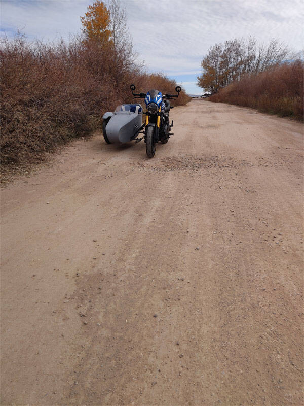

At the far end of this dirt road is my newest favoritest lady.  She does custom auto upholstery, and is going to do the upholstery on the Spyder, along with a tonneau cover.  😎
Dirt Road To Shop
I need to make a new seat bottom plate, shorten the wood side panels, and make a plate to sit just above the seat back for the rear of the tonneau cover to attach (so the trunk will open without unsnapping the tonneau).  Then it all goes to her very capable hands.
