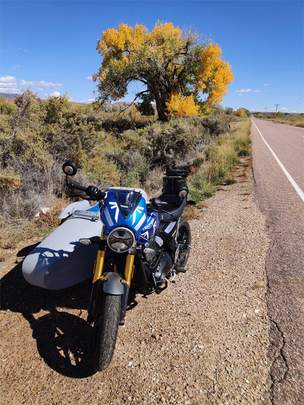

High desert fall colors showing up.
Fall Colors

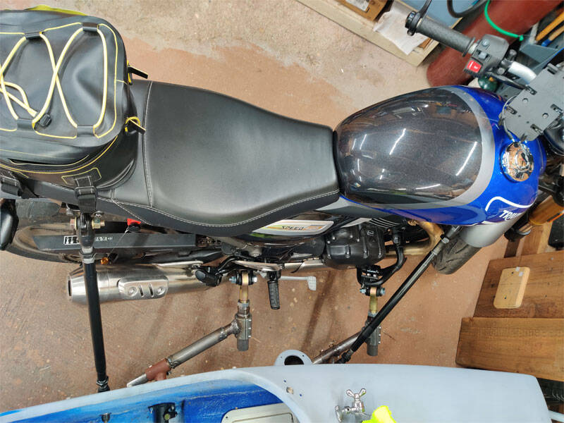

Something to ponder.  I specifically built Speedy & the Spyder so that the Spyder could stay in it's web, while Speedy and I have two wheeled fun.  I'm betting you could design something even better for the FZ6.  Like the Speed 400, the FZ6 has a steep rake, even less trail and a short chassis.  So it's a good one to work with without the need to modify the bikes geometry. 😎
Speedy is as simple as removing the two upper clevis bolts, two lower Joint bolts and two electrical plugs mounted on the bike. Cleaning up the appearance is a matter of removing four bolts on the front lower bracket.  Everything else is pretty discreet.

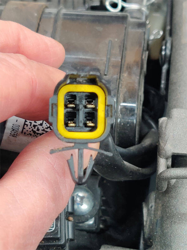

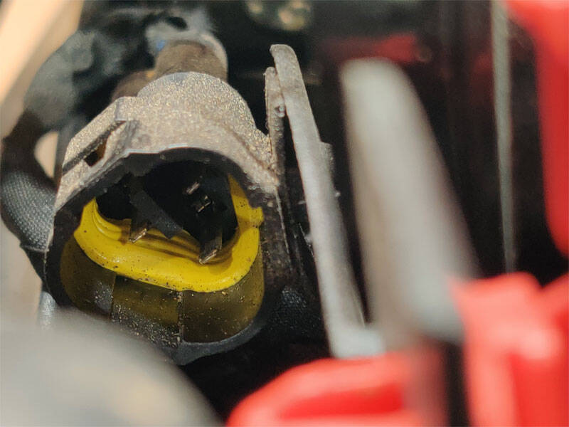

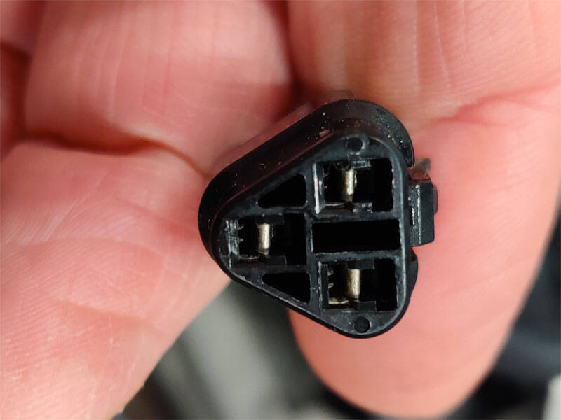

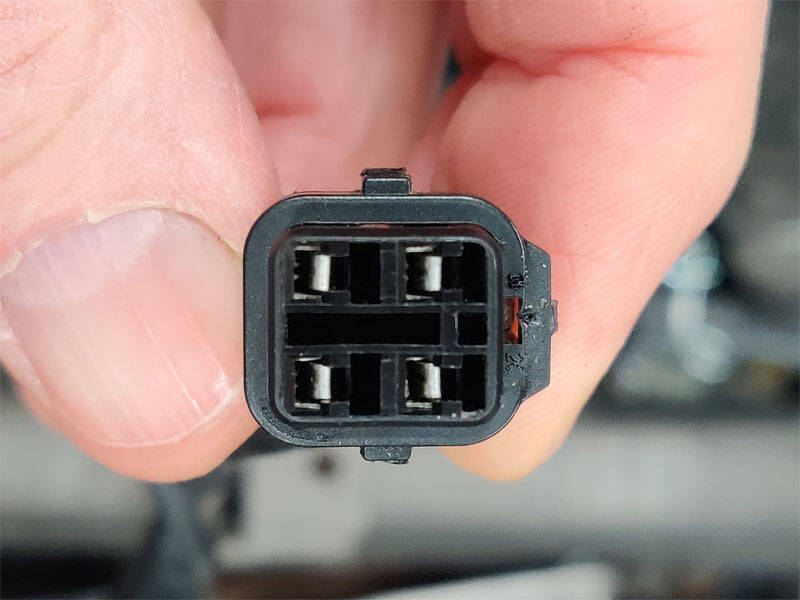

Trying to figure out what connectors the Indian mfgs use can be exhausting.  Ran into the same issue on the old KTM 390 built by Bajaj.  Now it's round 2 with this Triumph.
The goal is a break out harness for Brake, Running, Right Turn, that plugs into the existing harness connectors. Along with searching through all the regular suppliers (Eastern Beaver, Cycle Terminal, Kojycat, etc.), I've even run through all the automotive suppliers I've used in the past.
Harness is made by a company in India called Dhoot Transmission Pvt limited.  It's like they make their own connectors, which makes no sense.  In this case the connectors are very similar to a Sumitomo MT090 connector.  But just different enough that an MT090 won't work.

You can see how the locator tab is just a bit different.  There is a company that specializes in finding connectors.  If I can't figure this out by c.o.b. tomorrow, I'll contact them.  If that fails I'll get a job with Dhoot making harnesses for the Speed 400, and sneak out with what I need.  🤣
