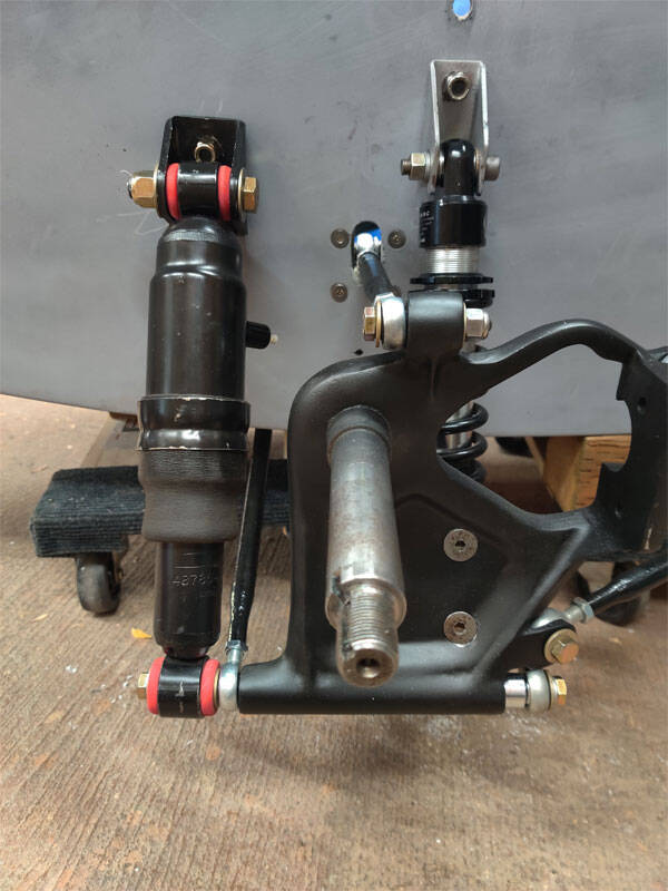

Suspension Done For Now (DNF).  Wheel balanced and installed. Fender back on.  Lunch being eaten.  Then it will be time to start the mating event.
Suspension DFN
Suspension DFN Front View

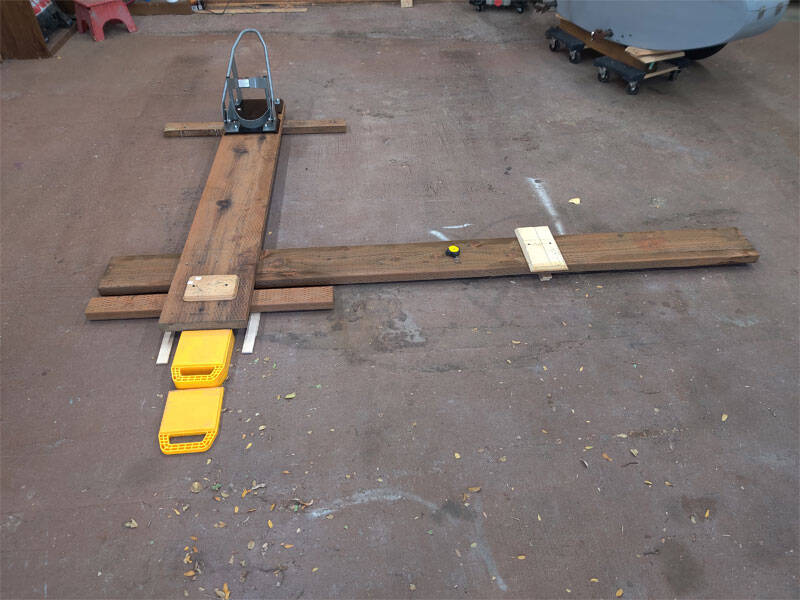

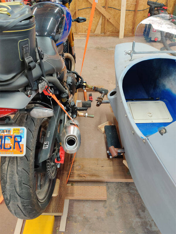

Mating Jig built & leveled.
Jig Leveled And Ready

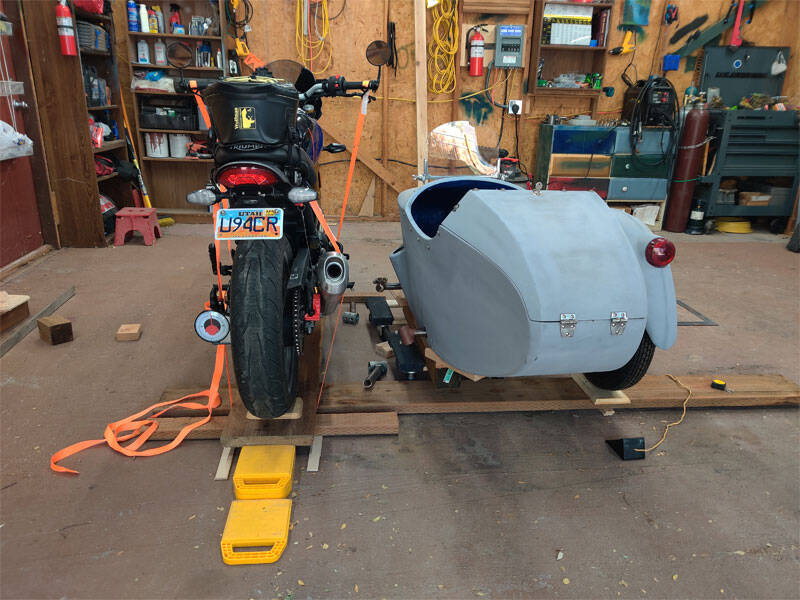

Triumph and sidecar set to loaded sag, and leveled/aligned on the jig.
Pieces In Play

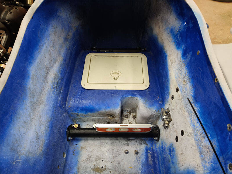

Level Sidecar
Forward mount temporarily installed to help hold things steady, while figuring out what had to be done to make the rear work.
Forward Progress
Had to extend the rear longitudinal piece.  Now there is room to go from 8" lead to 10" lead (approximately 15%-20%)
Rear Extension Mod

Scott, I hope I am wrong here, and I want to bring my expert on these matters into this conversation, so...Dane @ben-franklin, jump in here.
I see that the two different shocks are mounted in the wrong positions, meaning...swap them out. The almost vertical coil over shock will have less influence on the road action than the leaned out air shock, because the leaned out air shock is mounted farther out at the lower mount, closer to the point of where the Sidecar wheel is, and if you think of the axle length as a lever,  the shock that will get more actuation is the one mounted closer to the closest end of that lever.
In my opinion, I would swap those two shocks
Use the air shock to LIFT the Sidecar body to a level height, and being mounted inboard of the two shocks, meaning if it was mounted where the coil over shock is currently mounted, being at the closest end of the "lever".....closest to the Sidecar body, it will have less influence on the actuation of road ups and downs.
It all comes down to placement of the shock that is at the farthest end of the "lever"....or axle in this case.
I would like to hear from others, but specifically ask Dane @ben-franklin what he sees, and his opinion.
Posted : October 9, 2025 12:08 am
Posts: 1265
Thanks Miles.  Your thought sounds correct to me as well.
This is the way it was put together at Motorvation... I think (not convinced of that).  In any case this is just to get the rig test driven.  It will be fine for that.  Once it is determined if the Speed 400 is enough bike, then I'll look into a completely different setup for the shock configuration.
Posted : October 9, 2025 9:17 am

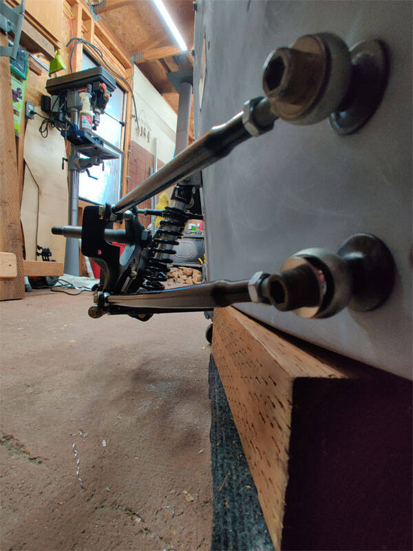

Lower struts are final mounted, and bolts properly torqued.
Getting things aligned is like balancing a ball on a pool stick while trying to maintain:
  • Proper wheel lead.
  • Sidecar laterally level, and at the same forward slop as the bike.
  • Proper sidecar wheel toe-in angle.
  • Proper track width.
  • Good angles on all the mounting points.
  • Plenty of fetch time with the shop Forepup.
Would have been nice to have a helper.

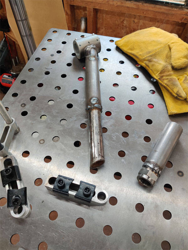

Have the upper strut tabs welded at the correct angle. Just waiting for them to cool off, for paint.
The next few days call for rain, and a big cool off.
Paws crossed I can get some drive test time to see if this is going to work.

Regarding FM's comments on air shock vs. Coil over location.  Gave it a little thought.
Air shock behaves like a progressive spring with kinda limited damping.  May be imagine which location you would install a fixed strut, if you were so inclined.
I would think the majority of the damping will come from the coil over unit, so having it on the location with the longest potential shock travel is probably a recipe for the smoothest ride.  Overall, that is an interesting approach to some load leveling ability for the hack.  Probably will "work fine, last a long time," as we used to say in the shop, many decades ago.
You may end up fiddling a little with coil over spring rate to get to where unloaded ride height at "low" (10 psi) air shock pressure is where you want it, but springs are relatively cheap and available at EPM or many others.
Will be interesting to hear your ride report with and without weight in the chair!

Okay,  I will assume the blame for asking an engineer to share his opinion  Scared
Dane, can you put your view in a few simple words ?
I can read , and read between the lines, so it reads as though you are saying that the coil spring shock and the air shock SHOULD  switch places.
Posted : October 10, 2025 10:17 am
Brstr reacted
Posts: 1265
Where the air shock is mounted, is not a solution I approve.  Cast Hub, 3/8" bolt, and the shock suspended aft of an important Heim joint. That Motorvation thought this was okay is a big case of stupid.   So no.  There will be no switching around.  There will be an elimination... eventually.
I think a fun project would be shock with hydraulic ride height adjustment that is motor driven.  So that is the initial idea for a needed enhancement.  It will not be supported by a bolt that holds the suspension together.
Posted : October 10, 2025 10:26 am
Posts: 1562
Well then, Mr. Stick In The  Mud......eliminate the air shock, and reposition the coil over shock.
