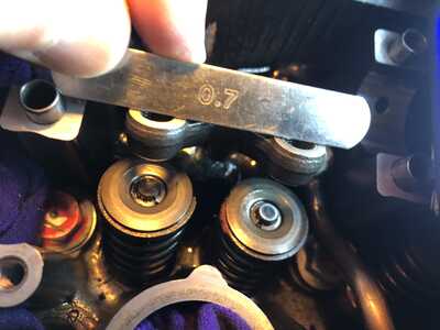

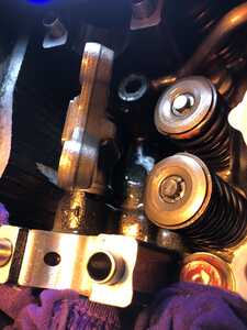

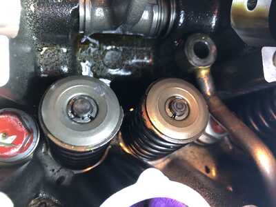

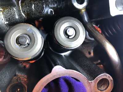

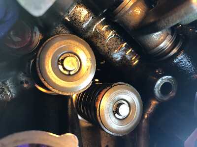

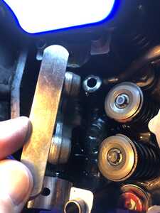

Okay. I got my camshaft out today, still hoping I don't have to pull the head.
As you can see in the pictures, the rocker arm is not bent, but that left valve definitely has some damage done to the retainer and keepers. Maybe you can't tell by the pictures, but the left valve is definitely sitting higher than the right valve. Just by eyeballing it, the valve stem seems to be sitting the same height above the keepers on both valves also. So I still don't understand what is making the left valve sit higher unless it is damage in the head to the valve seat. Do any of you experts think I can fix this problem without removing the head? If so, how? As always, I'm open to any suggestions.
valves 1D
valves 1F
valves 1E
valves 1A
valves 1C
valves 1B

I've never pulled a head myself, but I really don't see this problem being resolved from the rocker side of that valve.

Fee-Lloyd.... it's obvious from the pictures that the top of the valve stem on the left valve has been hammered.....ham-mered.
This all goes back to the adjuster lock nut not being secured properly, allowing the adjuster screw to loosen up, go UP, creating a huge gap between the valve stem and.... eventually a unscrewed adjuster screw.
IMO, the only reason that the hammered valve stem on the left would be sitting higher than the unhampered valve stem on the right, is due to head damage at the valve seat....or.....if you are the luckiest hominid on terra firma, then the damage is isolated to only the valve itself.
Final task before removing the head:
Put THAT cylinder at Top Dead Center.
Use a valve spring compressor to compress the valve spring on both the left valve, and the right valve.... remove the valve stem keepers....do not lose them.
Remove the valve springs, then.....with your index finger and thumb, rotate the valve stem on each of those valves...spin the valve stem smoothly in both directions. Does the right valve stem feel smooth, feel like it is straight?
Now do the left valve... spin it between your index finger and thumb, rotate it both directions, does it feel smooth?
Does it feel STRAIGHT?
Now, pull UP on each valve stem, and measure the height of the valve stem....and compare the two valve stem HEIGHTS.
Tell me what you have found.

Not much other than a damaged valve seat in the head...Β  I suppose the valve could have stretched, but highly unlikely.
Compression on that cylinder, before you pulled the cam?
FM's recommendations for pulling the springs off the two valves and comparing them is sound.Β  You could also pressurize the cylinder and see if the valves leak.Β  If yes, well, you will be pulling the head for a valve job.
Intake or exhaust?Β  If exhaust, maybe pull the pipe and look at the valves with a light...Β  If intake, pull the carbs/intake boots and look in from that side.
You'll likely need to remove that stuff anyway, once you decide to pull the head.
Maybe a one in a million chance the keepers are damaged on the high valve, and allowing the spring retainer to be higher than the other one.Β  Doesn't look very likely, though, from the pics.

Β  If that valve seat fell out or is loose it would keep that valve stem lowered. As far as the valve seat being damage that far to let that valve sit higher in the seat it's highly unlikely.

Early versions of this engine had an issue with soft material in the valves.Β  This created an issue of "valve tuliping". Basically the valve head would cup allowing the stem to reach further up.Β  I thought it was resolved well before '00?Β  I can't remember if it was intake or exhaust valves that had this issue.
But yes, either the valve has stretched or the seat has recessed into the head.Β  I don't remember any seat issues, but I haven't done anything with Kawasaki since the late '90s.Β  A look in the exhaust port might give you an indicator.Β  As would using a camera in the spark plug hole.
Will keep paws crossed it is only the valve. Either way the head will need to come off.
