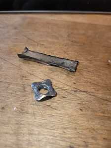

20250302 081552
I started dissembling the 2010 KLR in preparation to make a sub-frame for the Velorex. When I was removing the bolts holding the footpegs and crashbars, one nut on each side spun. After cutting off the bottom of the box that holds the nuts I found the nut with poor tack welds. I did not grind the nut. It just fell out. You can see that there was no penetration of the tack welds; poor design and very bad welding. With the bottom only cut off, there will still be enough steel on the remaining 4 sides of the box to continue using it. There is room enough to place nuts and a wrench.
I have 20 feet of 1 1/4" 1/8" dom to start the sub-frame and a roll bar
