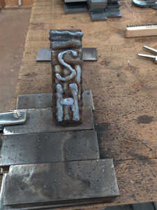

Spent yesterday relearning what was forgotten from last weeks practice.  Then moved on to run horizontal beads on a vertical plate.  End of the last session decided it was time to initial the mess I'd created.  🤣
Will make a good exterior door stop.  😉

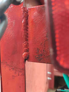

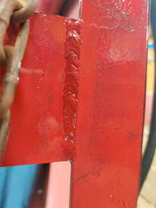

Started on the first "real project" that needed welding.  Have an older Big Tex utility trailer where the trailer lights are mounted off the bottom rail.  License plate was so low it was almost dragging the ground.  Moved the license plate to the tailgate (made by previous owner).  This week I cut off the light brackets, and welded them about 2/3 the way up on the rear most rail. Puts them about the same height as a normal passenger car.
Thin gauge metal that I got to practice uphill welding on.  Came out pretty okay.  lol
First attempt getting the settings reasonable:
First Uphill
  Second attempt on the other bracket a bit better:
Second uphill weld
Thankfully this isn't a high load/stress application.  lol  having a lot of fun melting metal.  😎  Just need to finish re-wiring the trailer, then it will be time to move on to the sidecar brake bracket assembly.  That is going to be a lot of fun.

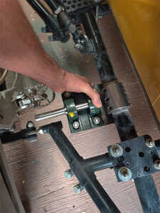

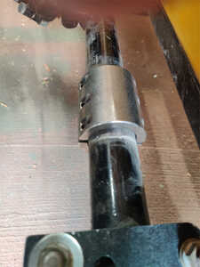

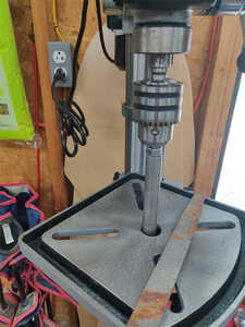

Started work on the sidecar brake project.  Will be a lot of fun.  Today's work was:
  • Sizing the O.D. of the DOM tube to fit the I.D. of the pillow block bearings.
  • Drilling the base plate to mount the pillow blocks.
  • Test fitting the DOM tube into the bearings.
Don't have access to a lathe, so I used the drill press, and a couple of files.  Only needed to reduce the O.D. about 0.004" so that went pretty quick.

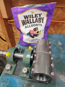

In the category of "operant conditioning/positive reinforcement" training, we have a new bag of training treats.  🤩 Three quality exercises complete = three treats.
Treats Of Excellence

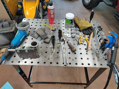

Enjoying the use of the new fit-up table.  Noticed Harbor Freight is having a parking lot sale this coming weekend, and has the same table (Their Titanium brand) on sale for $150.  That sales starts today for Harbor Freight "Inside Track Club" members.
Meantime, between rounds of fetch, obedience training and... Squirrel!!!!! I've been "fitting up" the pieces to create the sidecar brake lever assembly.  Had more fun with the new welding gear.  What a fun way to start the week.  😎   The practice weld "coupons" make a great platform to keep excess heat off the thin metal top of the table.  Should help stave off warping the top when welding thick plates with longer beads.
FitUp Table At Work
Next step is to remove the powdercoat on the section of sidecar frame tubing where this will clamp to.  Need to get the exact sizing (I think it is 45mm) to properly size the I.D. of the tube clamps, before welding them to the bracket.  Ukranian steel tubing, and U.S. sourced clamps aren't quite compatible.  lol

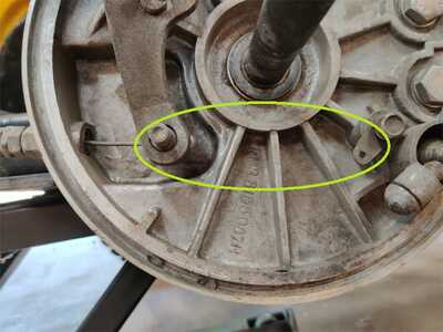

While the frame clamp is being machined, it seemed prudent to inspect the sidecar brake assembly, and clean/lubricate/adjust as needed.  Glad I did.  The lever return spring is missing.  Found a few bits of it in various places.  lol
So now I'm looking to see if there is a U.S. source for the oem spring.  Searched Soviet Steeds forum without success.  So I put a post up just in case someone knows.  Mean time I'll come up with something to get it functional.  Have a kit of assorted springs to choose from.
Green oval is where the missing spring should be.
Spring bits
Short of needing some cleaning, lubrication and adjustment the assembly and shoes are in great shape.  😎
