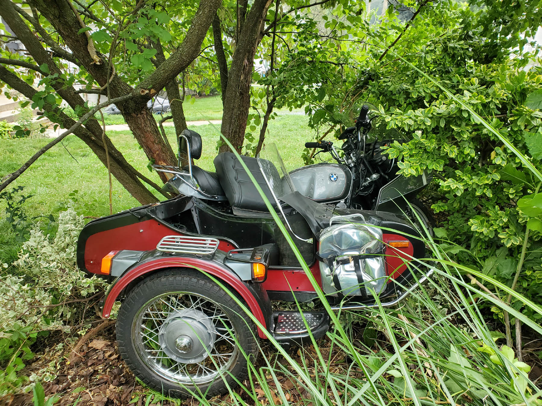

Parking in the trees.
My racing rig is temporarily on the back burner because I did this

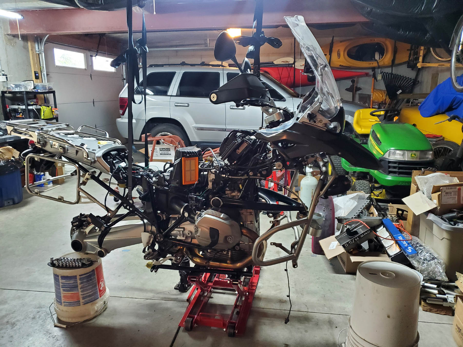

So I’ve been building a new rig.
But since I’m approaching the checkered flag on the street build I can get back to finishing the race rig.

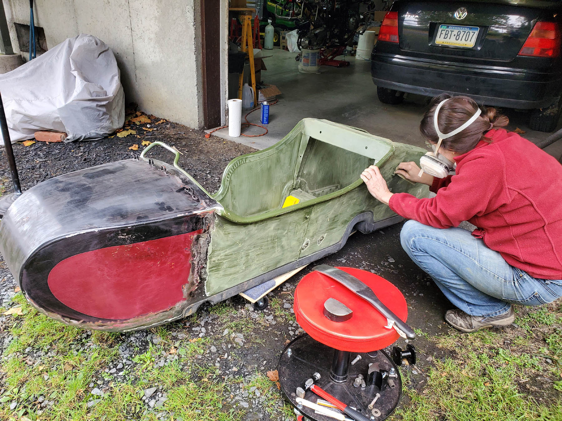

And just for the record that is her sanding the sidecar tub.  She's done most of the body filler/sanding/paint work.

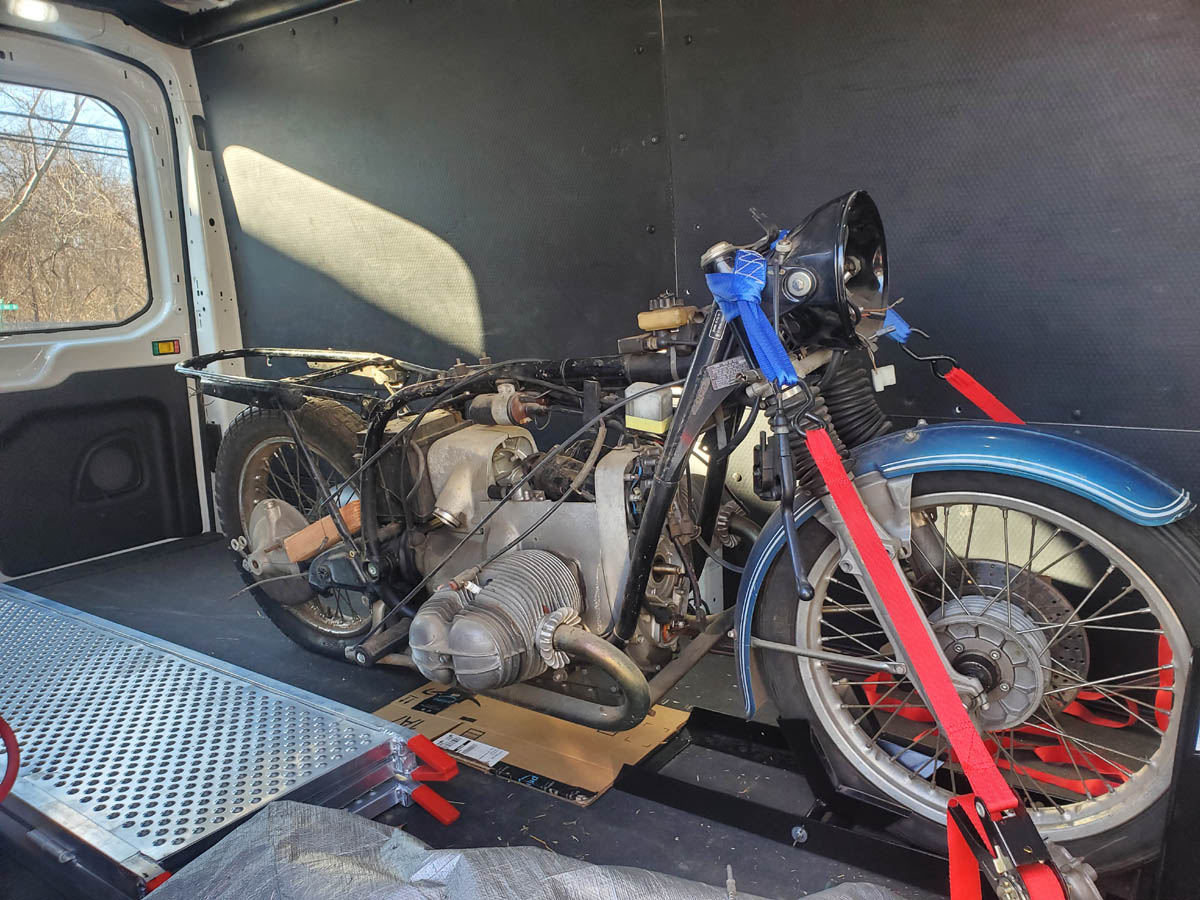

Finding a 1500 mile engine.
While the frame was being built I went on the hunt for a power plant.  I stumbled across an ad for a 1500 mile R75 bike.  Many of the pieces were scavenged but the stuff I needed engine, transmission, final drive, and swingarm were still there.
I admit I was pretty skeptical about the mileage claim but I called the guy and A. He seemed pretty straight up and B. The story made sense.  So out to Long Island I went - despite absolutely hating driving through NYC.
Turns out Sonny and I know some of the same people and he knows Dave Roper.  First American to win at the Isle of Mann TT.
Here's the engine story

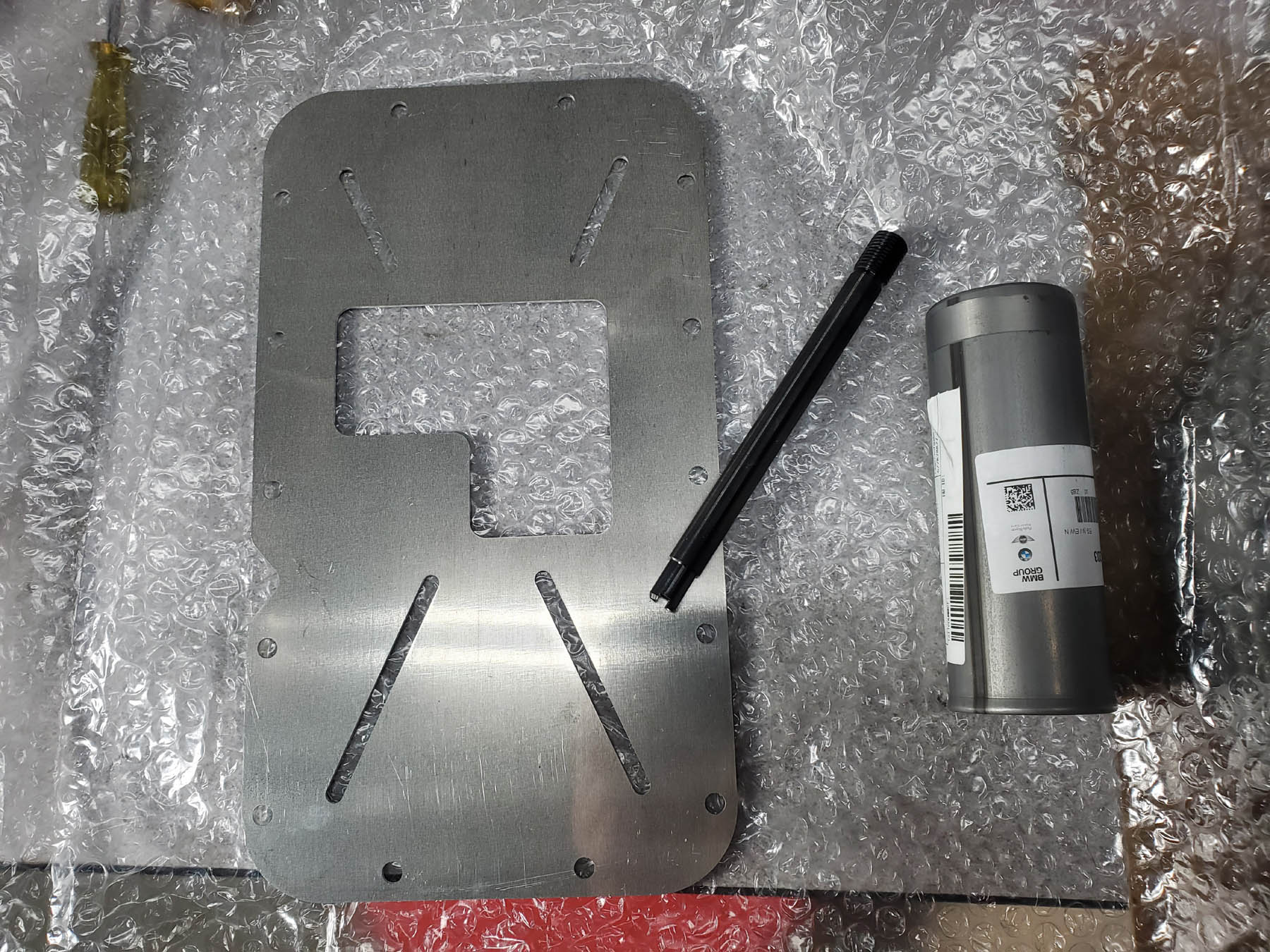

This is the last part of the racing rig build that I have until I can do the dry build this winter.  But that's coming soon.

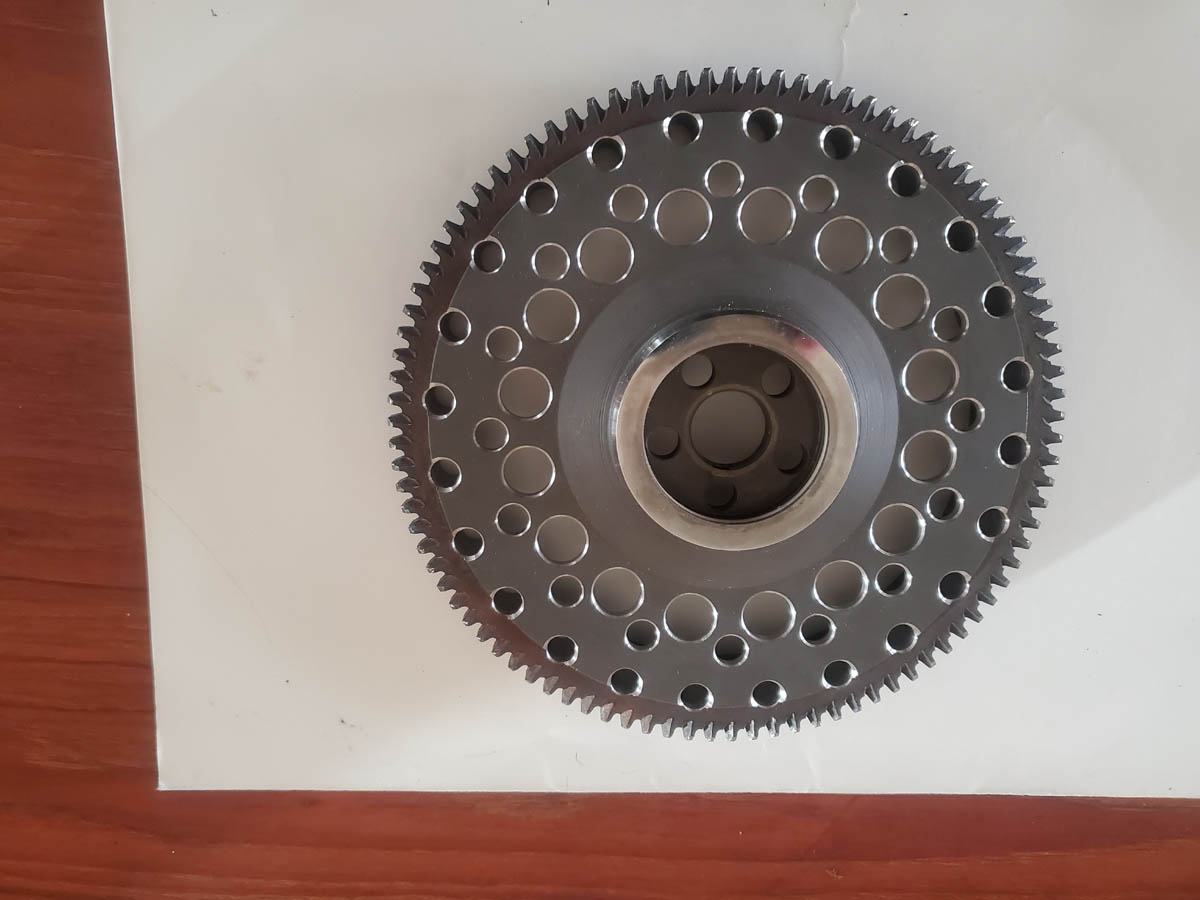

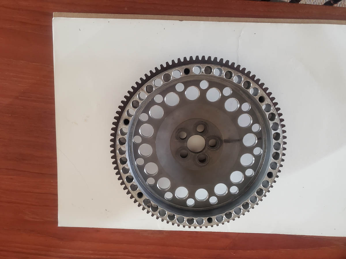

Ever wonder what a windage tray is or what it's for?
Want to see some beeeauutiful racing jewelry?
Click the video play button.

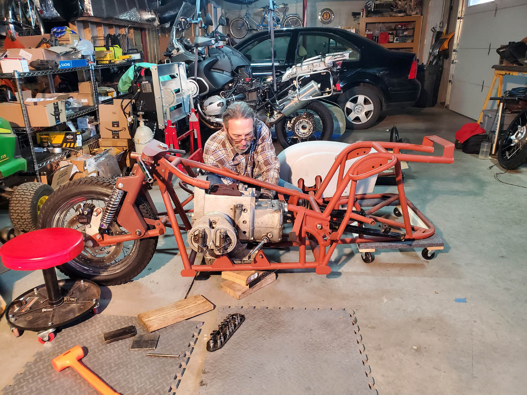

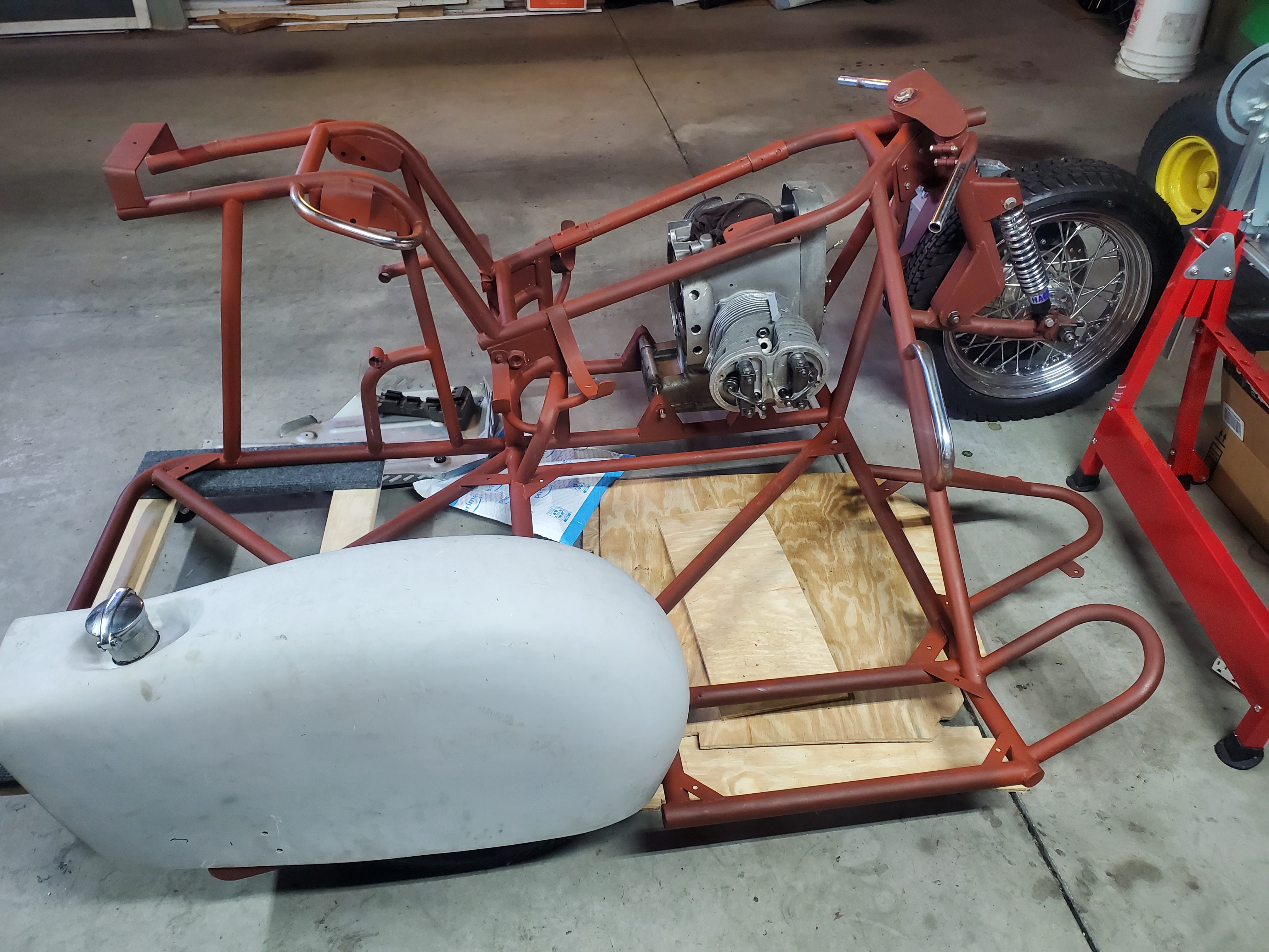

Progress.
While I wait for a 60degree day to paint the tub on my street rig ( https://www.sidecar.com/forum/topic/2011-r1200gsa-with-ural-tub-build/ ) , I'm getting back on my race rig build.  Race School is right around the corner - May 24 at Nelson Ledges  https://www.hellbendersracing.com/racing/raceindex.html.

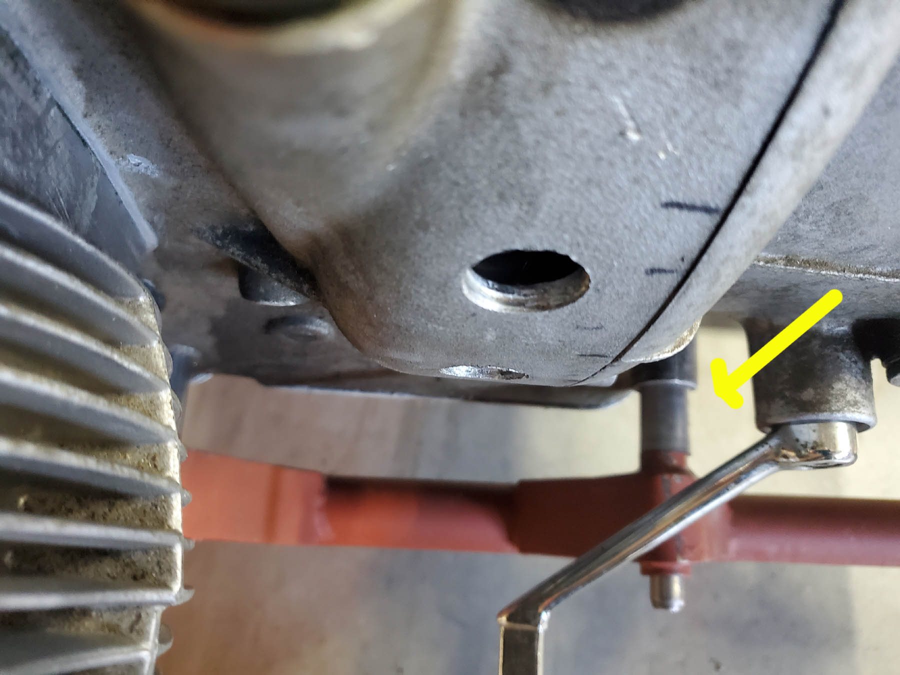

My buddy Craig from RDH Garage who helped redo the engine came over to be a second set of hands and brains (which we really needed).
Five hour day.  1/2 hour spent on mounting the transmission and swing arm, 4.5 hours spent on doing the spacers to line the engine up to the swing arm shaft.
True confessions.  The hardest part was getting the engine in the exact right spot to get the mounting bolts to go through.  Manual lifting = failure.  Creative strapping = 3 of the four frame mounts.  Hoe handle and feet = last one.  I'll have a video showing the antics soon-ish.
Posted : February 15, 2024 2:48 am
Drew, is that an olde school KTM racing frame ?
I only ask, because it has a burnished Orange color on the frame.
Posted : February 15, 2024 3:27 am
Posts: 1294
Forward Progress!  Woo Hoo!!!! Working with a buddy is always more fun than working alone.  If nothing else the comic relief makes it a good time. 🙂

Quote from FlyingMonkeys on February 15, 2024, 9:27 am
No.  That's a handmade, purpose built frame by Paul Whittaker.  He apparently has a lot of that orange primer because the one he made for my buddy  - 8 years ago -  has the same primer!
If anyone wants to know more about Paul and the frame watch the video - Picking up Helga's Race Frame
Posted : February 15, 2024 4:08 am
