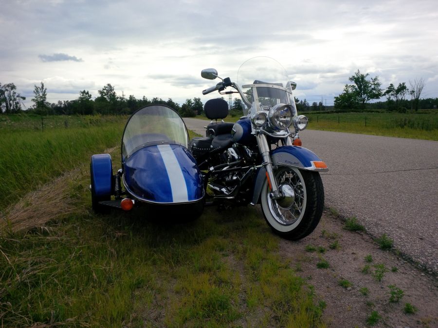

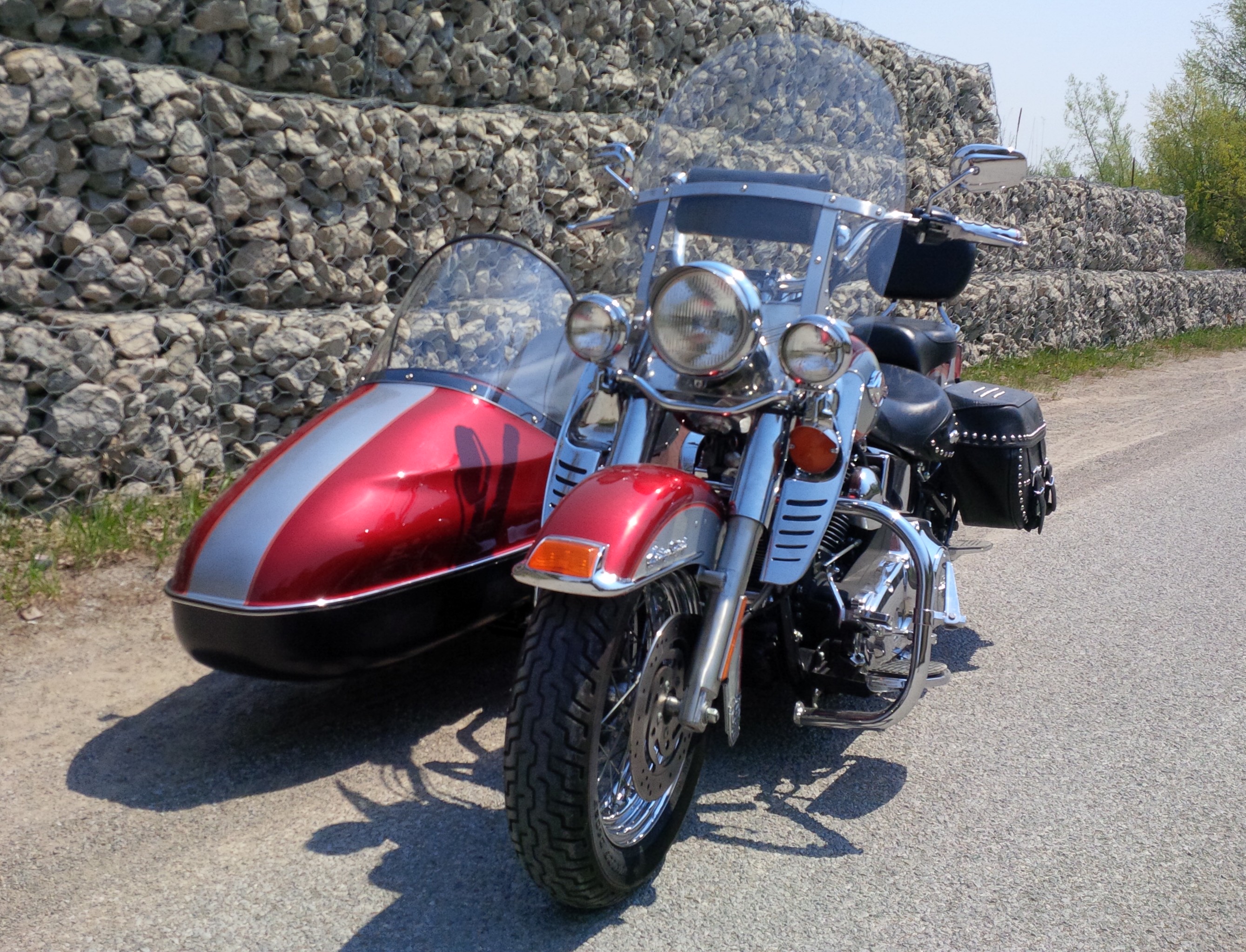

I installed a Ranger on my Road Glide over two years ago and have no regrets whatsoever. I've also installed them on several other Harleys, including two Heritage Softails, and the owners are very happy with them. IMO the Ranger is the best bang for the buck if you want a low cost, robust, no frills sidecar. I use 52lb of Bulldog as ballast, but recommend a minimum of 50lb of canine, human or organic/mineral material at all times as the sidecar is fairly light. On one of the Softails I bolted a full length 3/8" steel plate between the tub and the frame, it worked out to about 68lb and made the rig very hard to deliberately raise the outboard wheel in a right hand corner.

Thanks for the great pictures Mike, do you have any more especially Softails.

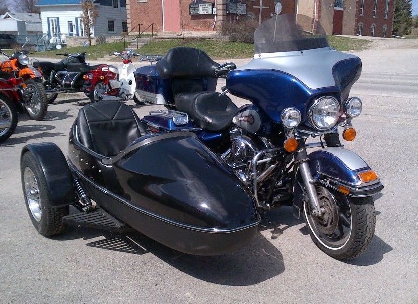

I've only done the two Softails so far, but here's a pic of the Electra Glide with a Ranger...
