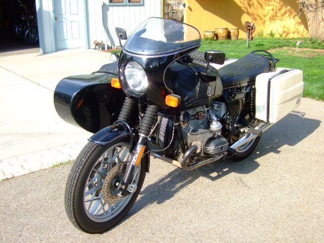

Need tires for my 1982 BMW R100RT with Sweet sidecar. Is there a car type tire that I can use and get a little longer life? Front tire is a 3.25 x 19 and rear is a 4.00 x 18. Thanks
