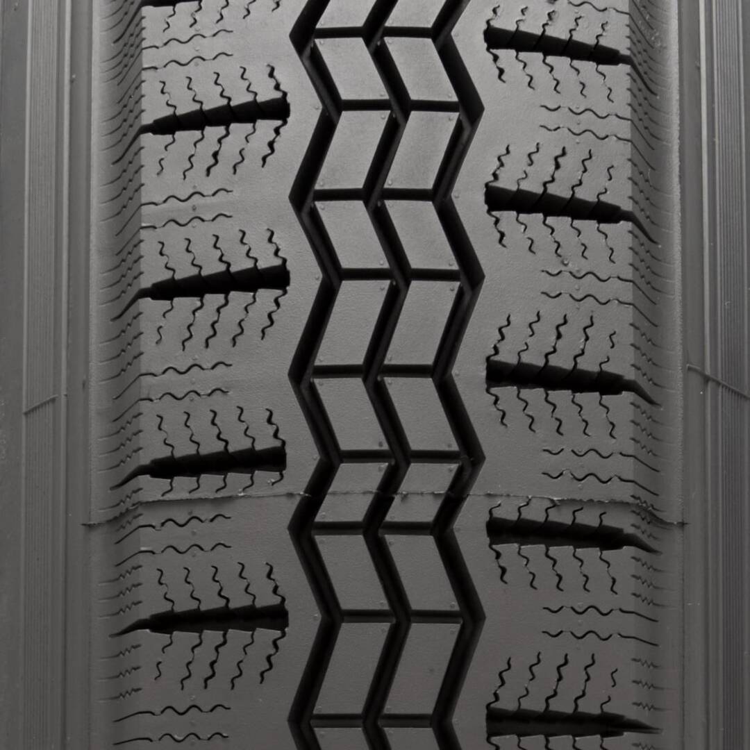

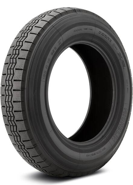

And, there are only 2 available on TireRack.com, and rather than choose the Vredestein, I choose to go with the Michelin X tire, which is exactly the same ones I have on my 1959 Morris Minor Traveller (although on the Traveller they are a 155/80R-14)

The ONE issue that I see in using this 125/90R-15 Car tire on the front wheel of this Burgy 650 is.....this tire is 2.5" taller in total diameter than the OEM 120/70R-15, which means it will be 1.25" closer to the underside of the front fender....but I have a plan.
"I have a plan" (famous last words of all those great inventors that came before me)
I believe I can raise the front fender the height needed to clear this new Car tire, and it should (ha ha ha) be fairly easy to do.
Right now there is at least a 3/4" gap between the top of the current tire, and the underside of the front fender....may actually be closer to a full inch clearance there, so in reality I would only need to raise that front fender approx. a 3/4", so that I have a 1/2" of clearance, between the top of the new Car tire, and the underside of the front fender.

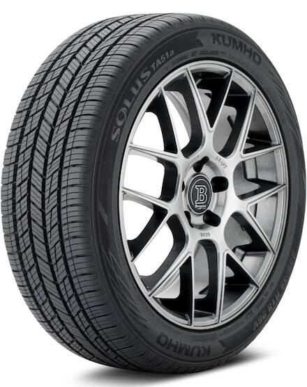

The new REAR tire is a 165/65R-14 Car tire, and it should have no problems at all in fitment, and room for it to run in that rear fenderwell.

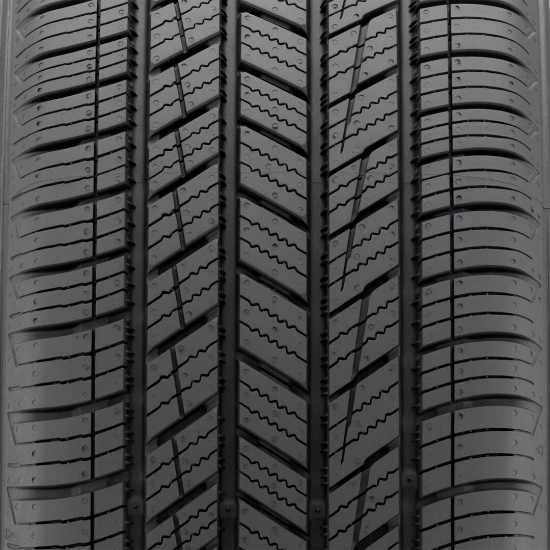

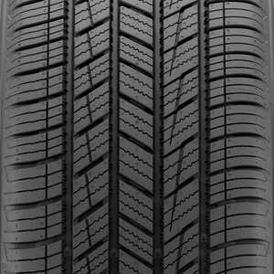

I specifically chose this Kumho Solus car tire (never ordered or owned a Kumho tire before) because of the treadwear rating. It is a 640 treadwear rating, whereas most other tires in this size were a 200 to 300 treadwear rating. For sidecar duty, in a tire that is not going to lean, a higher treadwear rating is good. It also has a Traction rating of A...and a Temperature rating of A...so it should be ideal for this use.

These new Car tires will get installed this Winter, when my wife is not out there piloting this rig, so I can take the time in my shop to do these tires, and SEE if the Car tire on the front wheel will work, or I need to go back to a motorcycle tire.
