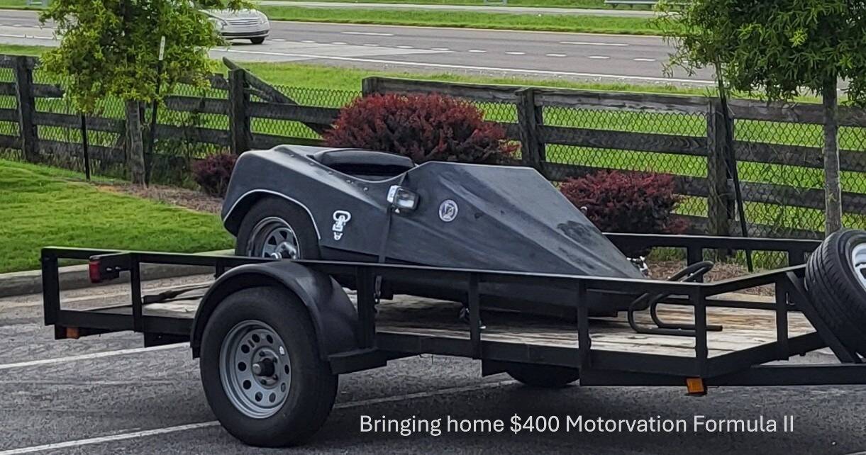

As for the sidecar. I picked up a Motorvation FormulaII with electric camber control for $400 a few years back. Have already fully restored the frame and tilt motor assembly. I am still in the process of reworking the tub.

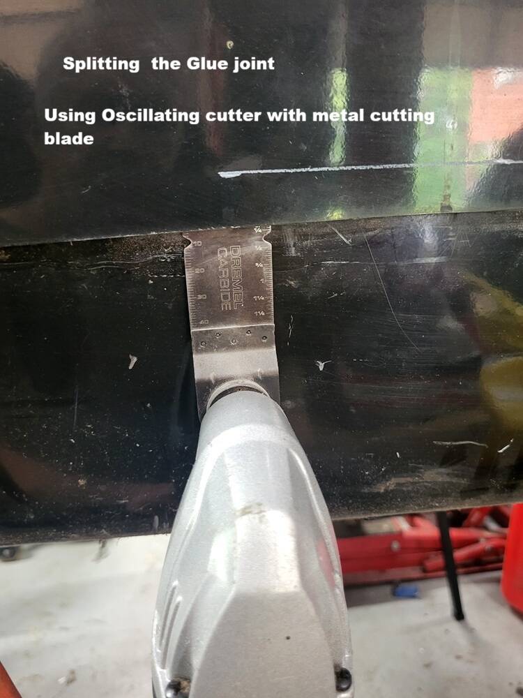

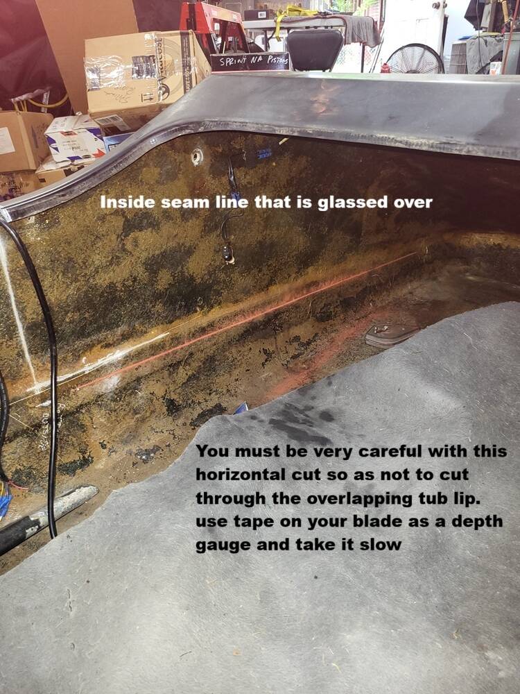

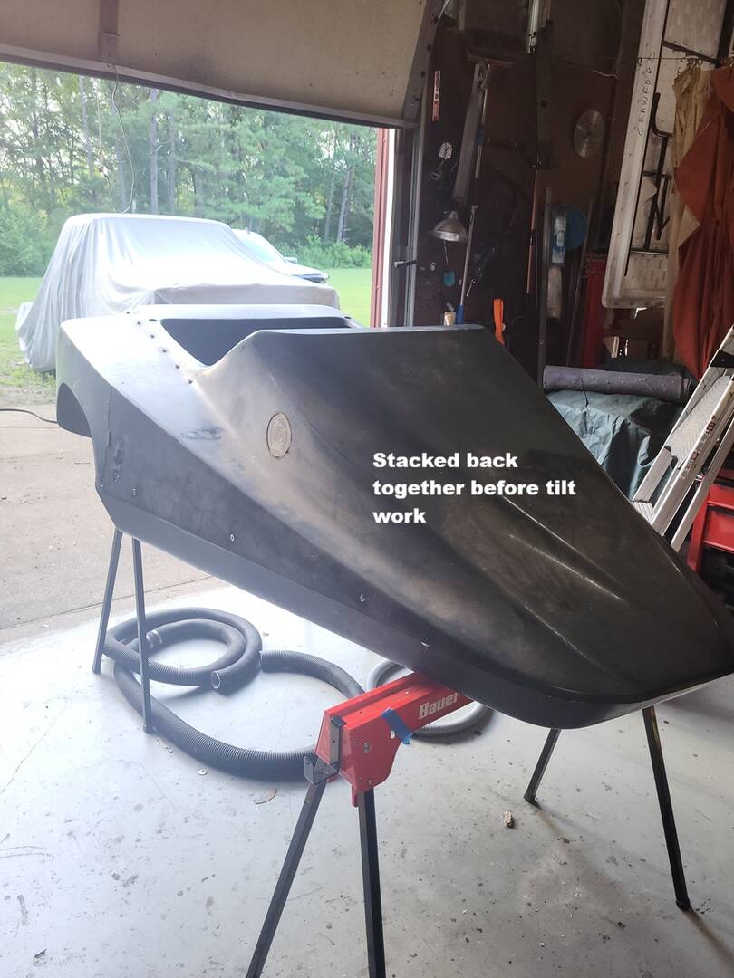

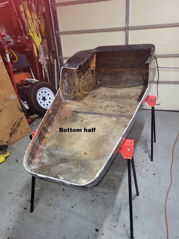

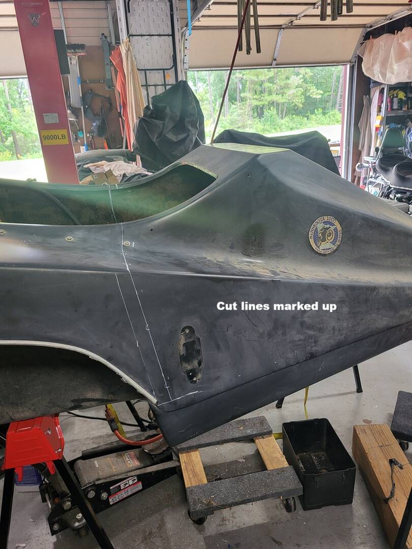

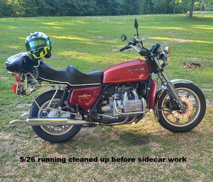

Need to take more pics of the actual mechanical details, but this gets the idea in my head started. Base mostly naked bike pictured. It does have full Vetter fairing/lowers as well as full Samsonite luggage (not pictured but will be part of finished project)
, then an introduction to converting a Motorvation Formula II from a solid tub, to a flip.

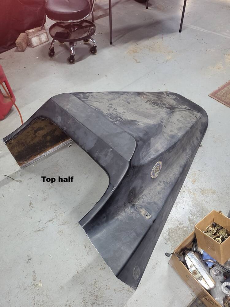

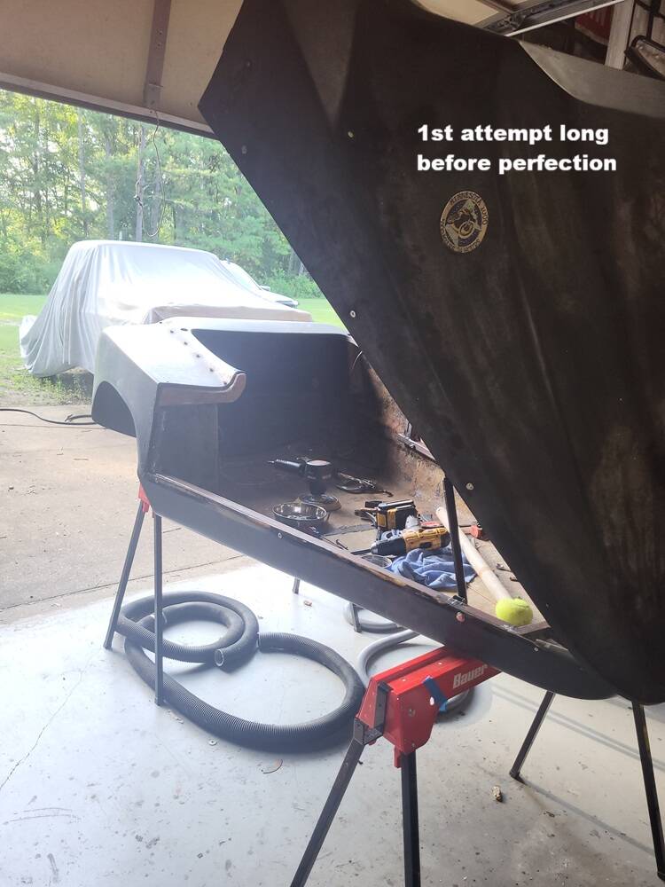

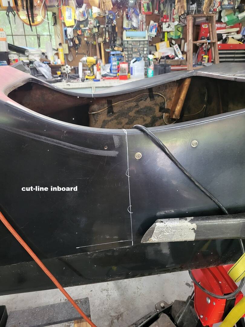

Cool....but looks like a much easier tub to split and mechanize....Splitting was just some measuring and about 2 hours of slow cutting. The mechanizing took several designs and weeks of trial/error. I contemplated doing similar to what his pictures show, BUT I had a few pictures found online that clearly showed this one could be left with the bottom intact vs the Drop area. But very few if any pics actually showing the mechanism. A few moments in the living room Recliner brought the solution to light.

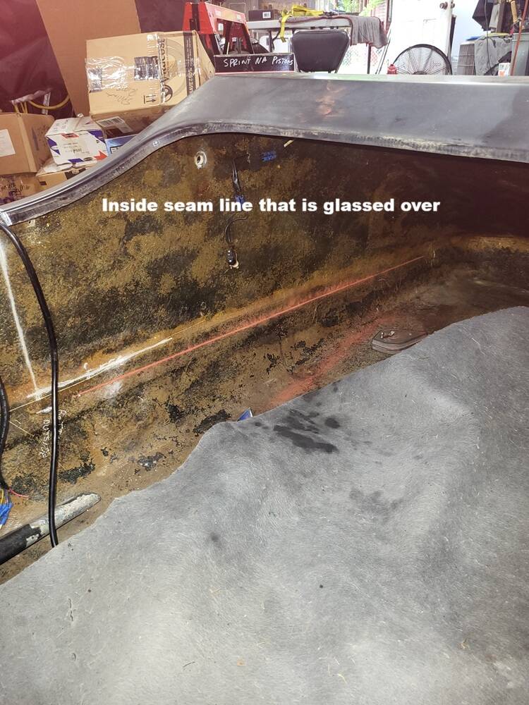

The top of the tub overlaps the bottom of the tub by about 1.5" everywhere but in the very front. By factory design I assume, the two haves of the tub were overlapped before they were glued and glassed over. If you take your time and cut it the way I did, that overlap remains. To properly split this tub was not just a straight through cut. It was a vertical cut behind that lip as my picture depicts using the oscillating cutter to cut the factory glue line. Then inside the tub you make a very thin depth horizontal cut to go through the glassed area but not through the lip. Yes I slipped in 2 very small spots, but repaired those with glass/resin before the paint work. once I determined the safe depth for the cut I wrapped my blade with blue painters tape to act as a depth gauge.
In the very front I had to cut down the original fiberglass joint/cut line a bit so as the two parts would not rub as the top is flipped. I also came up with a dual pivoting spring assisted hinge area ( hinge is also made from 1" square tube) that helps the entire Top tub go forward In that area at the same time it is going up. I came up with the idea for that while sitting in my living room recliner and noticing how the leg section of my recliner went forward as it went up.

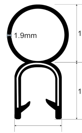

I added a second wall about 1.5 - 2" behind the original front lip that is the proper height to near give me a seal across the entire front. Going to top that new wall lip with a seal like this, that will completely seal off that area when the top tub is down.
As for sealing the circumference of the tub. As stated, the top overlaps the bottom by about 1.5". My overall tilt mechanism is a 1"x1/8" steel square tubing frame, 1 for the bottom half, another for the top half. when down they lie on top of one another. For the water integrity I plan to either provide some sort of seal at the top edge of the bottom/top/tub overlap area, OR put a layer of 1/16" x 1" rubber glued to the bottom of the perimeter of the top tub 1" square tub frame Bottom/top/tub
