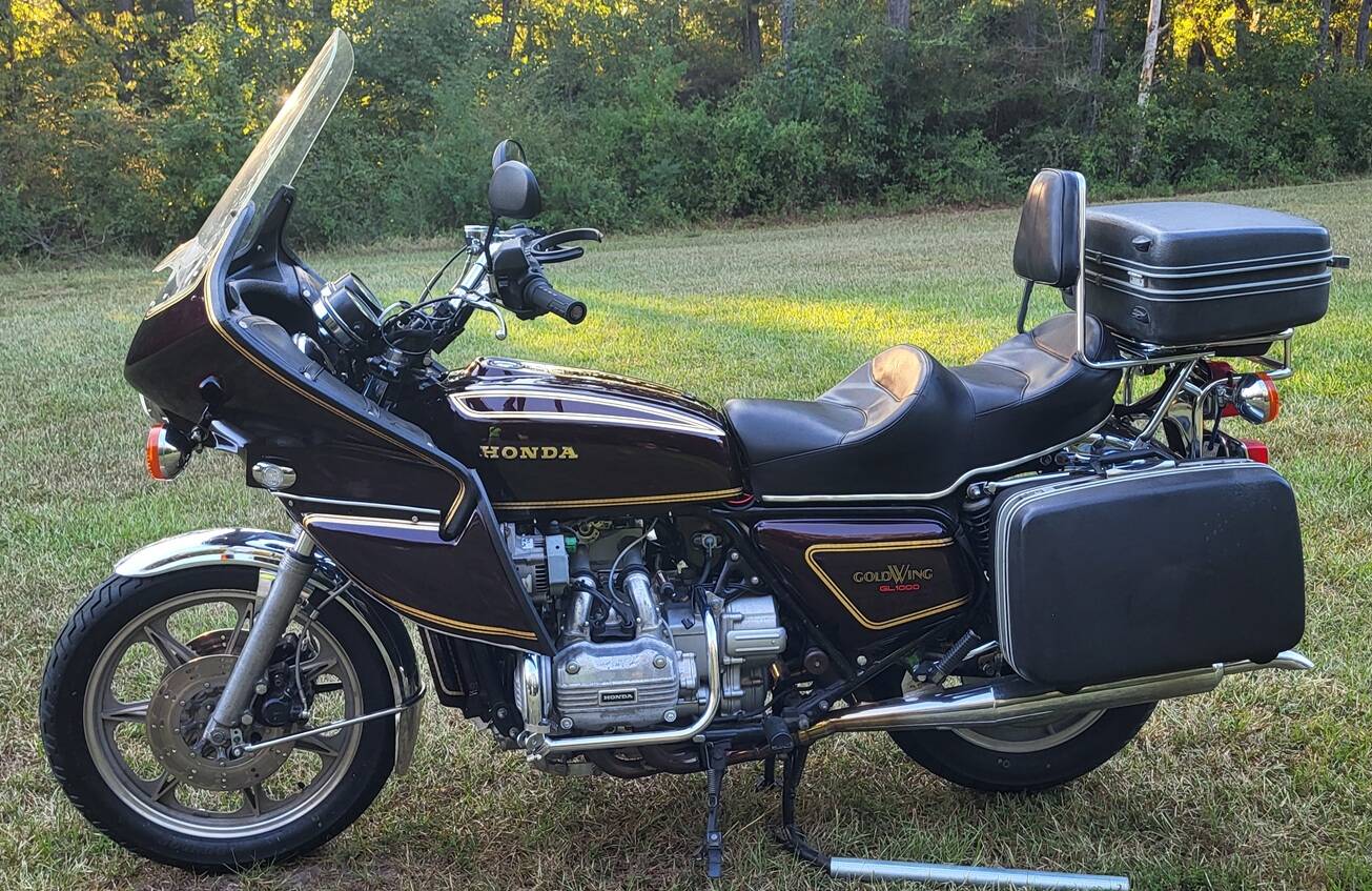

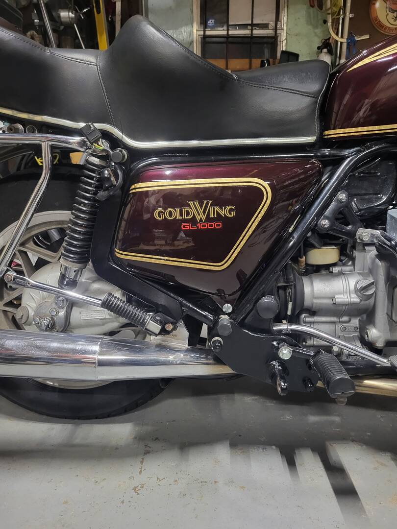

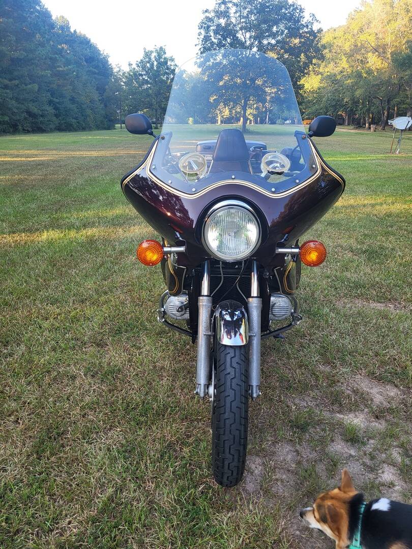

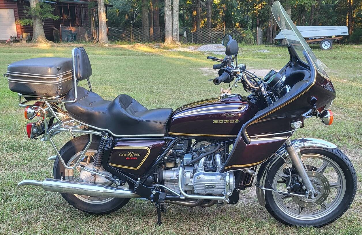

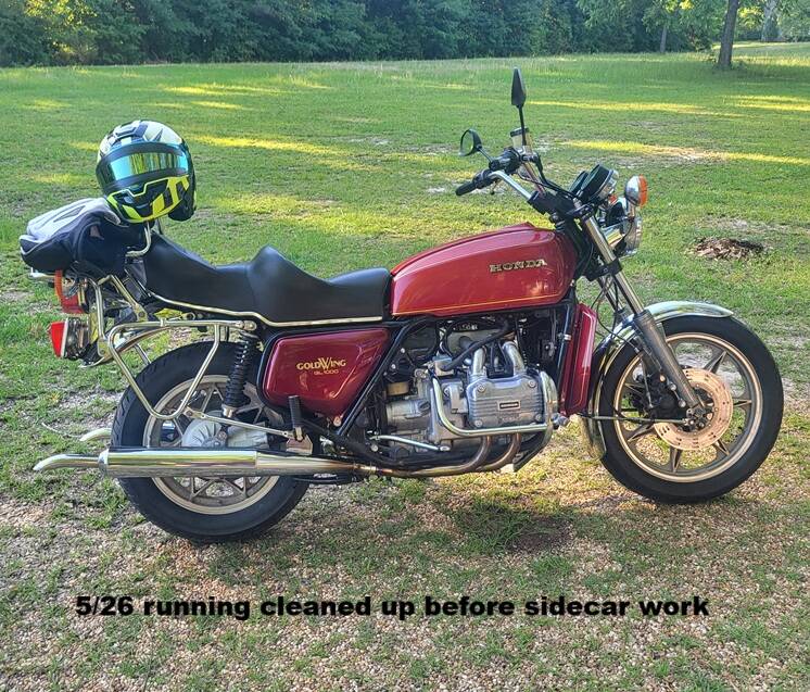

All bike stuff now done except new custom saddle and refinishing the samsonite bags. Both are still in nice shape, but I do want to refinish them for the entire package restoration. all the shiny bits back on and time to get ready to attach the side car and all its newness....A few posts back when I recreated my rear top SC mount, a few commented/wondered how it's odd design would blend in once finished....I think, very nicely.
can you find my shop supervisor in photo 3 of 5?....our young "Ollie" always under or around the rig while I am working on it. He seems very fascinated, I'm hoping he takes to being a passenger in the SC as much as he enjoys riding in the truck, back of my trike around the property, and our SXS.
Before
20260517 174906
After
