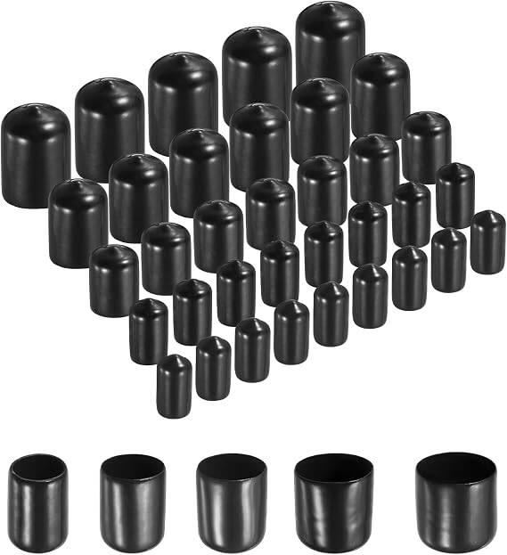

Mike @mkc1962, a small suggestion for covering that exposed end of the threads of that bolt, and for covering ALL exposed nuts and bolt heads is that I buy boxes of these small black rubber caps from Amazon, and use the various sizes to cover every exposed nut, exposed threads, and exposed bolt head on my sidecar rigs, for two purposes.
1: it covers all exposed hardware so that there will be little to no corrosion on that hardware, from road grime, rain water, salt air, etc, so when the time comes that I may need to remove that nut or bolt, the threads are always fresh.
2: it just looks better having all the nuts, bolt heads, and exposed threads covered in matching black rubber caps, as a finishing touch to the sidecar build.
61vXUt2lD7L. AC SX569
https://www.amazon.com/uxcell-100pcs-Rubber-Protective-Protectors/dp/B0F3CNWXJW?pd_rd_w=8GpRl&content-id=amzn1.sym.deab2812-f209-4eb4-8bda-1a7ead6efc17&pf_rd_p=deab2812-f209-4eb4-8bda-1a7ead6efc17&pf_rd_r=W5ASFQ7PVQR4Q81VS0AM&pd_rd_wg=X8tTa&pd_rd_r=d6644a8b-062e-4890-bea6-563fcac2c0cb&pd_rd_i=B0F3CNWXJW&ref_=pd_bap_d_grid_rp_0_65_i&th=1
I simply use a drop or two of superglue inside each of these black rubber caps, and fit the black rubber cap snugly over the exposed nut, or exposed threads, or exposed bolt head, and the superglue will hold that black rubber cap in place...until you decide to give that black rubber cap a little twist...and then the black rubber cap will easily come off.
For sidecar pilots that go off-road, or go to Alaska, Yukon, NW Territories, it saves the exposed hardware from being coated in Calcium Chloride, and all the gravel road debris, and saves the exposed hardware.
For "street" sidecar rigs, it looks like a nice finishing touch, as all the exposed hardware is covered in matching black rubber caps.
Amazon sells various sizes, in kits. It you run out of a particular size, you can order a full box of just a specific size.
Yep,  have lots of them and that is what I am using for that bolt at the moment.
