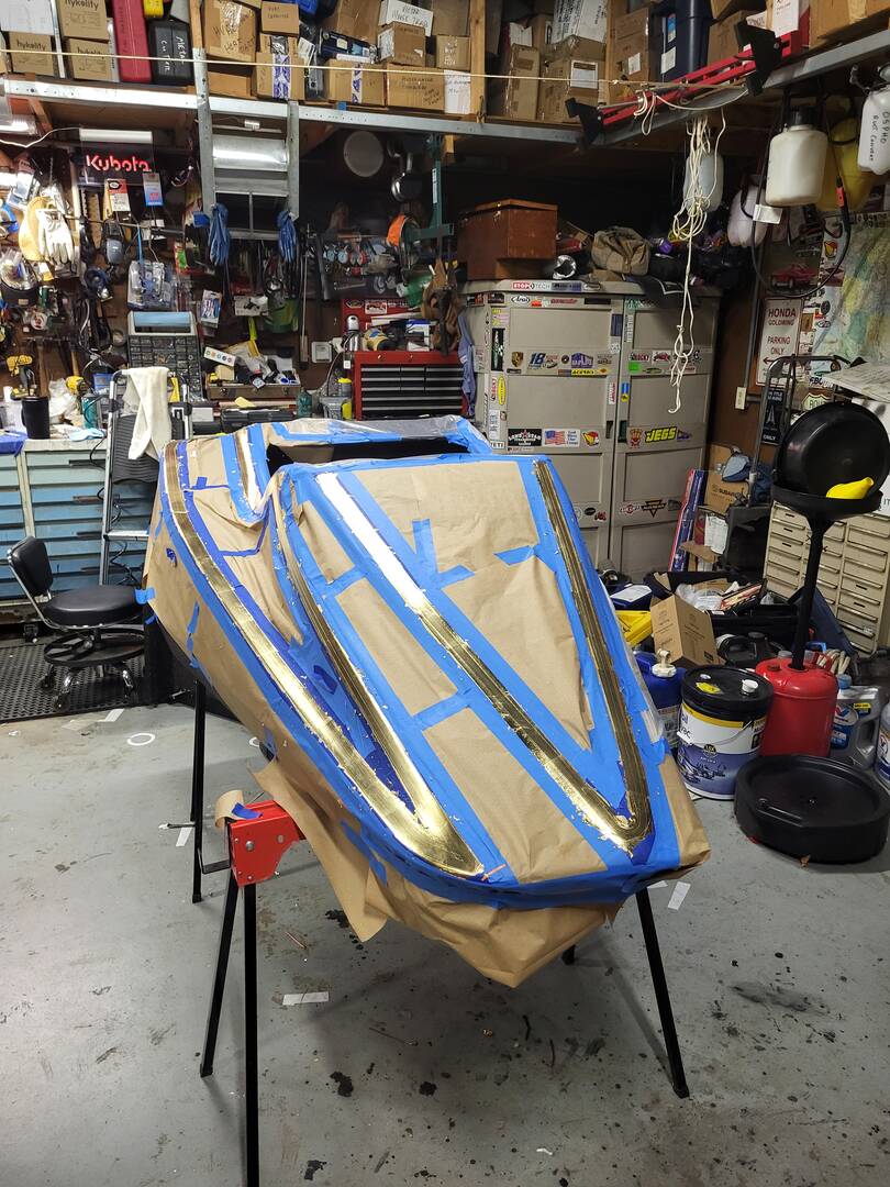

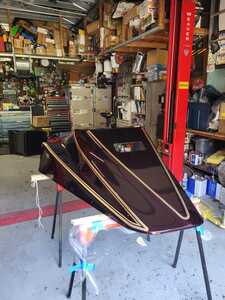

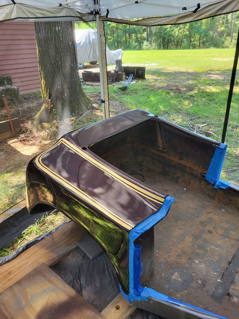

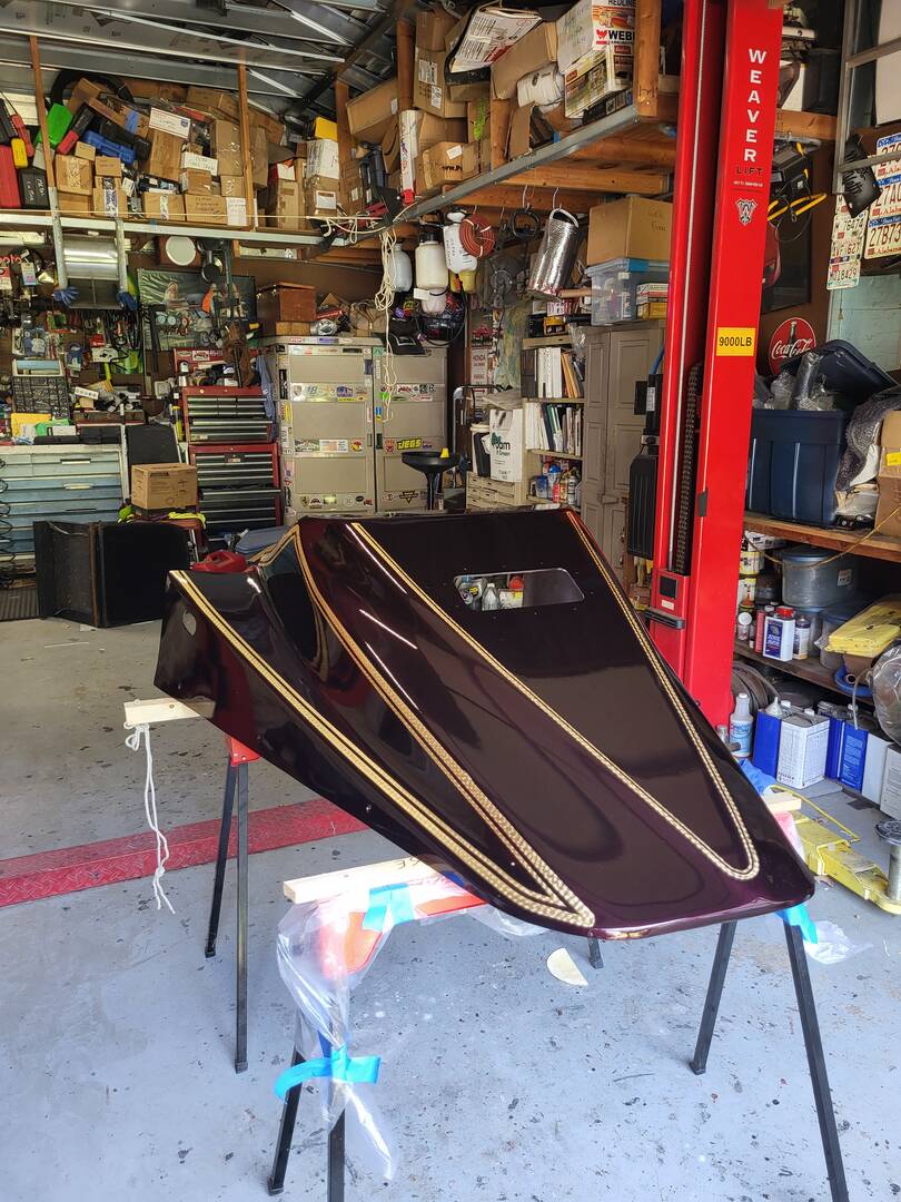

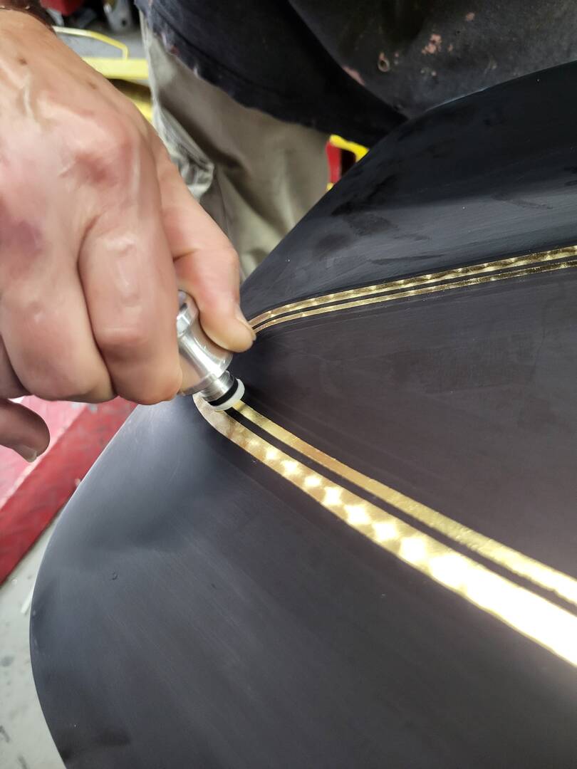

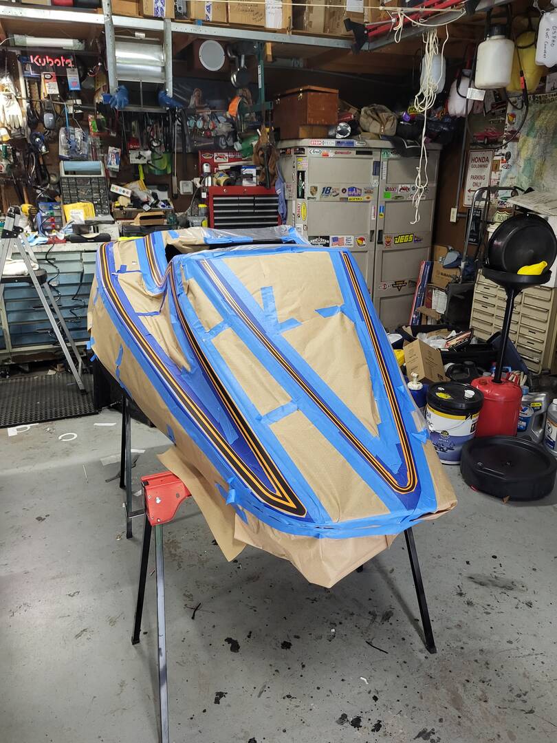

Super hot summer here,
slow go but all painting is now done. Time to start polish work then start assembling the package.
Tub taped for stripes
Leaf on tub[1]
Spinning the leaf[1]
top tub sprayed[1]
bottom tub sprayed[1]

Mike @mkc1962, what are you plans for the INSIDE of the tub bottom, meaning the interior space ? Are you going to spray it with bedliner, then carpet on top of that, or...what ?
Oh, and your work is too good to be confined to the hot Summers of Alabama. You need to move to the Pacific Northwest, where 4 out of 5 sidecar builders prefer to live, and they actually build 4 out of 5 of the best sidecars in North America.
Coolest Summer weather we have experienced here at my ranch in the past 20 years living here.
Posted : August 21, 2026 9:02 am
Brstr and Thane Lewis reacted
Mike in Alabama
(@mkc1962)
Posts: 57
For the floor, at 1st I was planning to use bedliner but then changed my mind. I did use color matched bedliner on the front and sides of the lower tub.  I wanted to add insulation to the inside as much as I could as more than likely my dog will be the only rider and too much road noise never seems to do well with dogs. For the floor I am using adhesive backed EVA boat decking. For all the rest of the interior, foam/adhesive backed marine grade carpet. SC Seat is still in good shape, but I also custom build and stitch all my own bike saddles, so after all is together and road worthy plan to redo the bike and sidecar seats to match.
Been PNW many times, have some RV friends there and do like the region but no desire to live there. We have a 2nd home in the smoky mountains of NC, that we've had for 20 years where the climate is much different. The plans are to relocate there once my wife is retired (28-29). I myself go up there about every 4-6 weeks for a week or more.
As for being a SC builder, nah...this has and still is a fun project, and will maybe do another all from scratch for my Motoguzzi. But that would only be when it gets to where I am having more physical issues getting on/off it. Its been a fun project so far, but have no desire to do anything for profit anymore. I do occasionally build a custom saddle for close riding friends, but even with that I don't take any $ I just let them buy me supplies for MY next personal build. Paying customers have gotten way to picky these days.

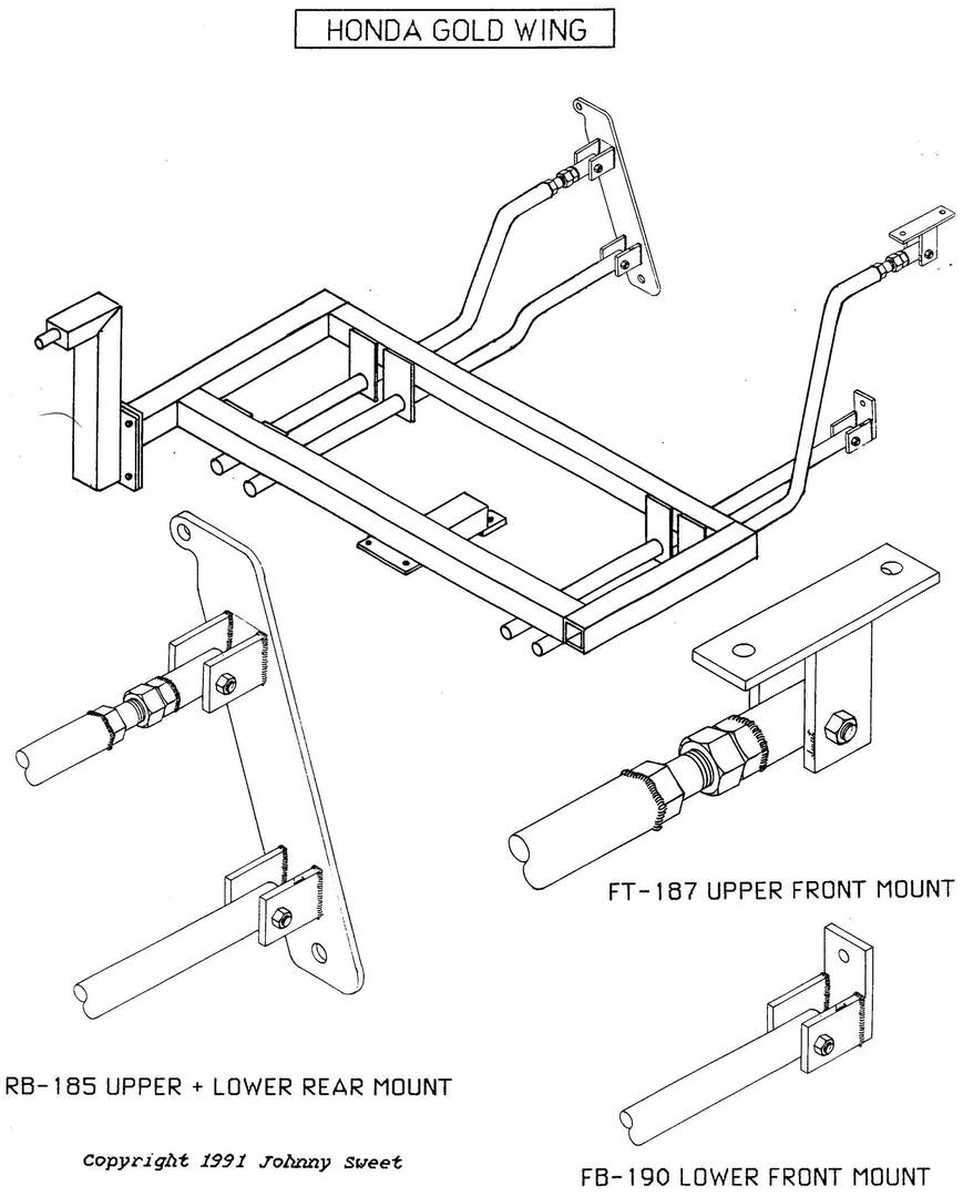

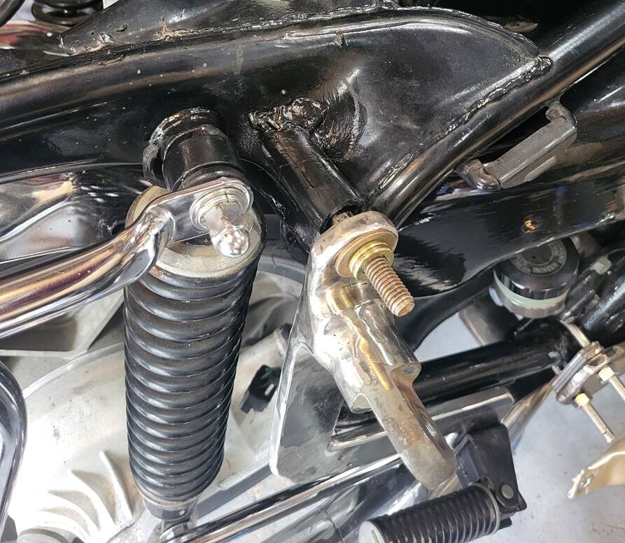

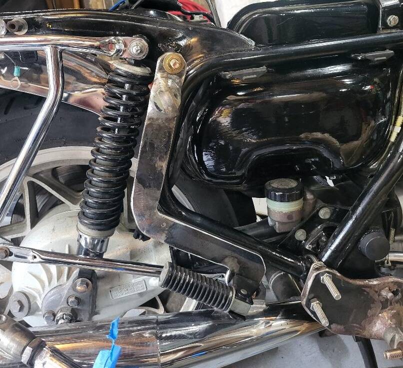

While the fresh paint was curing before final buff, I got back on some mechanics of the rig. My original top rear bracket mount I never liked, so I came up with another approach. I added a new mounting point to the bike. John Sweet had replied with a technical drawing of how he used to install his sidecars to the GL1000's back in the 70-80's. His rear was a 1 piece section that both top and bottom connecting rods from the SC attached to. His mounting points were the Shock bolt and the passenger foot peg bolt. I never got back with him on the matter other than to show thanks, but as I saw it the bikes side cover either had to be missing, OR this bracket would have to have been shimmed etc, way out in order for the side cover to still remain,  which I did not care for. But his idea did get me to thinking of another way.
JSweet GL1000 mounts
My way, I drilled a hole through the webbed area at the top of the rear frame just above where the rear shock is. But also so that it did not interfere with the seat when fully mounted. I installed a 3/8 G8 bolt through the frame, welded on the front side, then added a collar around it made out of 1/2" pipe also welded to the frame to bring the flat attach point more inline with the same vertical plane that the foot peg is on. Using 3/8" plate steel I created a bracket that follows the frame structure that goes around the rear side cover then down toward the passenger foot peg. This allowing the side cover to be fully seen and in no way butchered. SC bracket point is welded to the 3/8" plate near the top (shown still in raw unfinished shape). I Think this one will be plenty robust to handle the situation. My rear lower is still a large 3/8" plate that mounts under the driver foot peg with the driver foot peg bolt going through it, and also 2 large 3/8" U-Bolts holding it to the frame.
Top rear bracket1
top rear bracket 2

I like it.
Yes Sir, I like it a lot.
Posted : August 27, 2026 8:47 am
Thane Lewis, Mike in Alabama, Brstr and 1 people reacted
(@2fltc)
Posts: 347
 Look good, but I may have done it a little different. I've would have made it so the bracket would have been bolted to the mount instead. I think it would make it a little cleaner. But that just me. You are doing a good job.
Posted : August 27, 2026 8:58 am
Thane Lewis, Brstr, AceinSav and 1 people reacted
Posts: 870
Mike that looks great, once painted and everything is together it might just blend in to the point that it looks like part of the frame
are you going to calculate and cut the top bolt length so you can use a cap nut or just get a nice nut cover so it matches your shock nut
Posted : August 27, 2026 12:02 pm
(@2fltc)
Posts: 347
Cap nut will work nice too.
Posted : August 27, 2026 3:25 pm
