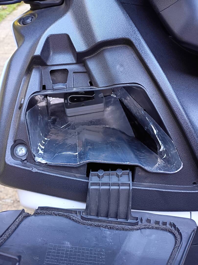

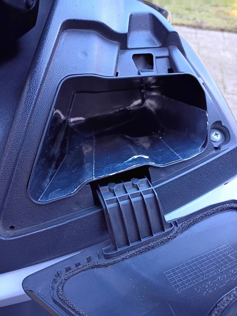

I added silver aluminum tape to the insides of both upper glove boxes, so it's easier to see things in there.
IMG 20261011 120107782 HDR
IMG 20261011 120122169 HDR

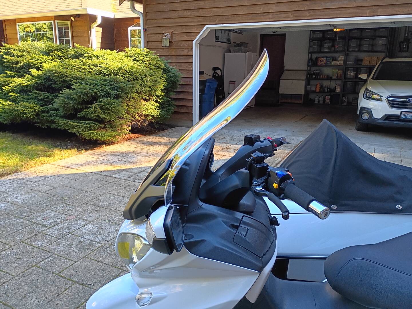

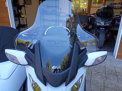

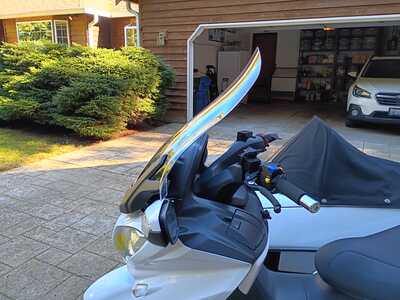

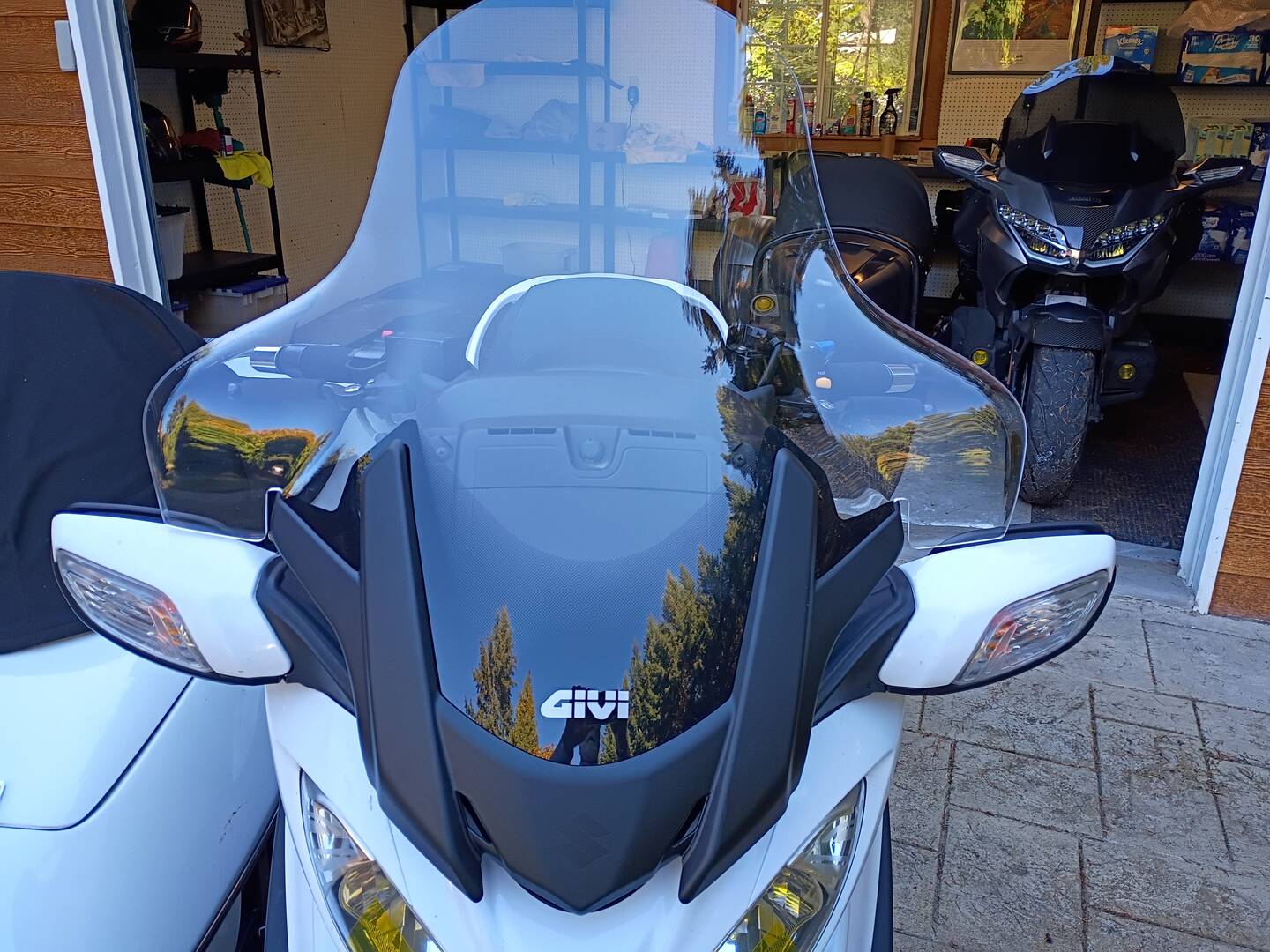

Replaced the previous National Cycle windshield with a more aerodynamic Givi windshield, and replaced the OEM windshield black trim, as the original one had broken tabs.
IMG 20261011 115939811 HDR
IMG 20261011 115929408

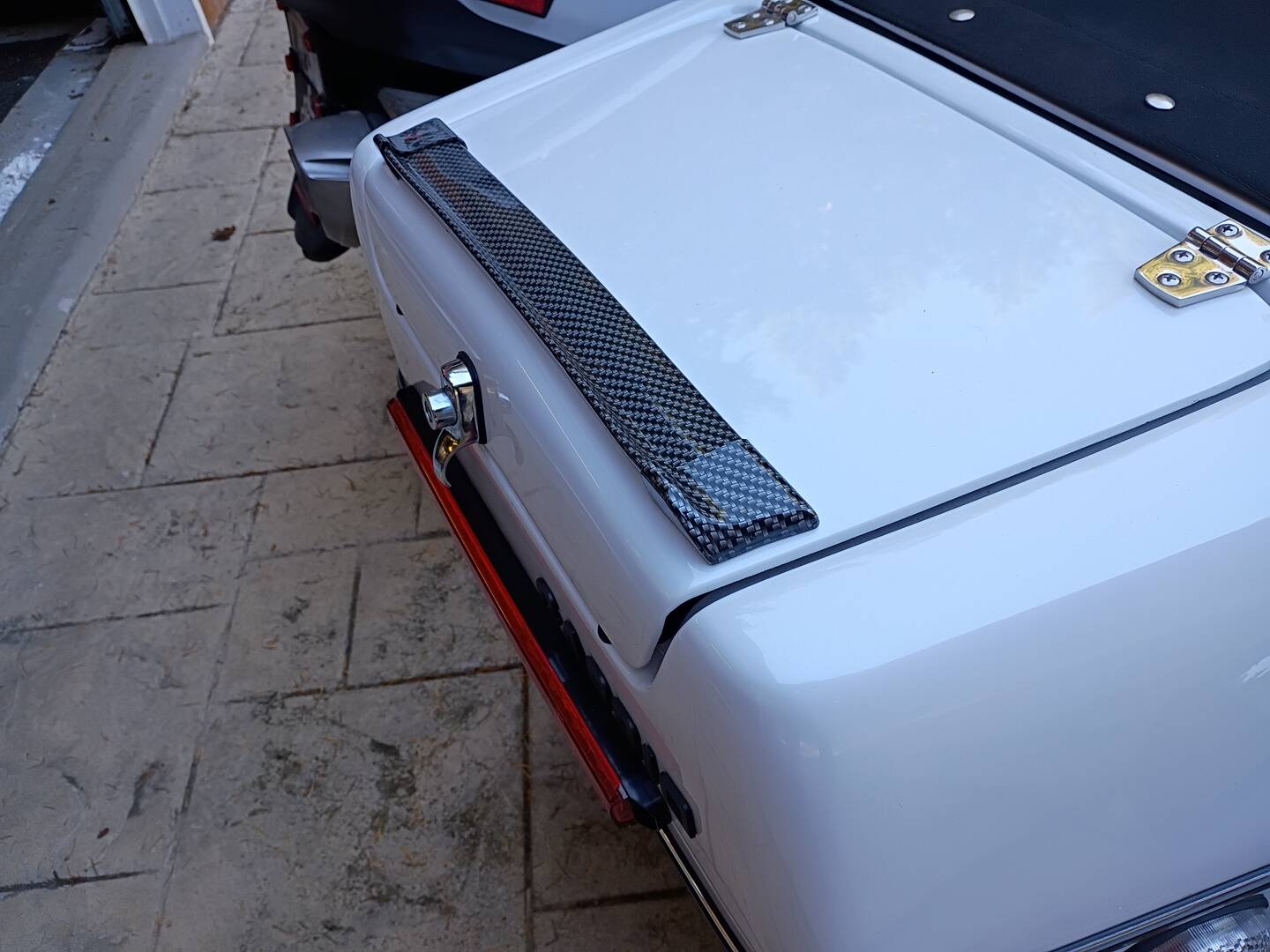

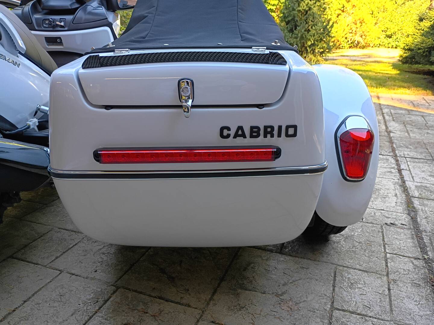

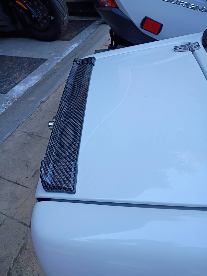

Added letters for the word: CABRIO on the back of the sidecar trunk....added an upper brake light to the rear of the sidecar trunk, and added a Carbon Fiber looking spoiler to the lid of the sidecar trunk.
IMG 20261011 115840115 HDR
IMG 20261011 115851195
IMG 20261011 115900982
