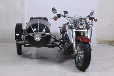

Β  I am pretty sure this is one of those knock offs. Take a look and tell me what you think and what you know. It was passed to someone as settlement for some money owed. The new owner wants to mount it on a 2020 RG. I have more pictures. The accent strips on the nose are riveted on.

Not a good idea at all to mount it on a big bike..Harley?
From here it could be one of the made in India sidecars. ( Cosy, Indie, Kozi etc.
But just as likely to be a safety wholesale sidecar.
Run away quicklyΒ

I got the same idea. Of those sidecars the universal mounts are (in)famous for to be of poor quality. If someone wants to use it, then best on a scooter or very light bike up to perhaps 500ccm and applying well made hardware for the mounts.

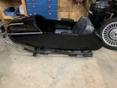

@smitty901, I must agree with the comments from @brstr and @peter-pan, that is in fact one of the knock-offs, worth maybe $ 1,000.00, and should only be mounted to a smaller scooter, maybe 350cc and less.
As @brstr suggested, "run away quickly". If your friend isn't able to run, I will offer a can of RedBull, as...it gives them Wings, so they can fly away.

IMG 5859[1]
This is what I was thinking. I was surprised the sidecar is a bit over 300 lbs.Β  But axle seems small and it just does not add up to a anything other than a knock off.

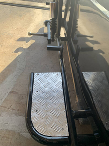

This photo of the step plate --->
That's not the typical step plate you see on the Rocketeer nor on the Cozy.
But it does look pretty much identical to this kit available on eBay --> https://www.ebay.com/itm/403947111049

Posted by: @ned

This is a Inder Sidecar. The importer is in Texas. You can tell by the swingarm, step and mounts on the frame.
