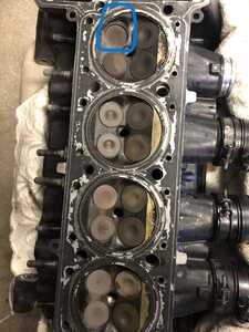

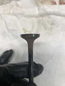

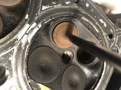

I'm in the process of taking the head off, but keep getting interrupted or running out of time.

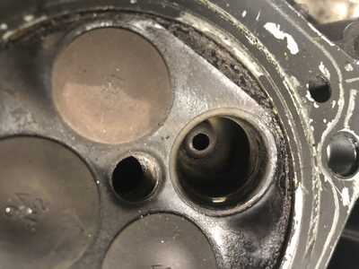

valve seat   1
valve seat   2

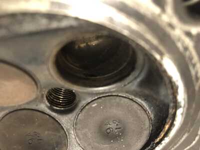

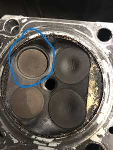

Finally got my head off today. As you can see by the pictures, I think it's either a sucked valve or a badly damaged valve seat. My valve spring compressor is a little too big to pull the valve out for a better look. At this point it really doesn't matter to me what the problem is as the "new" head and valve train I bought on eBay the other day is due to arrive tomorrow.
    The other day another Concours owner on the COG forum suggested that when I get the new head to replace the valve seals and have a machine shop resurface the head. I can maybe see new valve seals, but is resurfacing the head really necessary? The eBay seller said this head came off of a bike with 7,600 miles on the engine. Any other suggestions on what I should do before installing this used head and valve train?
Posted : February 6, 2025 5:19 pm
(@ben-franklin)
Posts: 327
@floyd-h A light resurfacing is usually pretty cheap, especially if you have the valves out for new seals...  I'd do it, just to ensure good mating.  If it is expensive for some reason, you'd be fine to skip it, though.

Posts: 1583
Floyd, a few things......but first......I  told ya so basic_smile
Sorry,  had to get that out, before anyone else did.
The pictures show that the  VALVE is bad, but IMO the valve  seat cut into the head is okay.  "I " would not have  bought a  used replacement head. I would have  removed this head, seen that the  valve is bad, removed that  valve, installed  new valve  seals on all valves, then installed one new valve in place of the  sucked valve,  and.....I  would have  lapped the new valve into the valve seat using  lapping  compound, and ALL of that could have been done in less than one hour, once the head had been removed.
This used head you bought on eBay.....you need to replace all valve seals, and check the gasket side of the head for flatness.  To do that,  you need more than just a flat surface or  flat table. I have the Snap On flat bar that is used to check heads for flatness,  where you use feeler gauges to determine gap on the head. I could ship this flat bar to you,  but there are other ways to check that head for  flatness,  like a glass table top, etc.
Personally,  I am happy that the problem found is what I thought it would be,  as it shows that the  Lightning Strike did not fry all of my brain cells.  Head Explody
Posted : February 6, 2025 6:21 pm

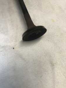

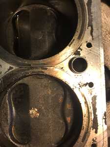

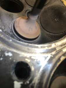

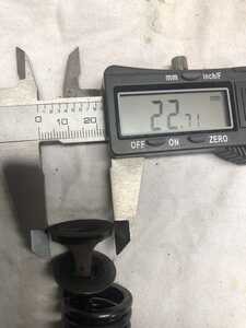

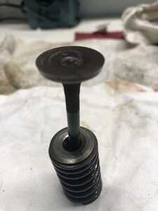

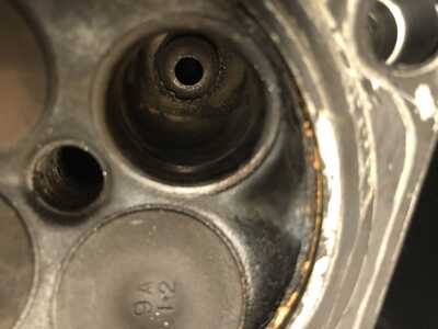

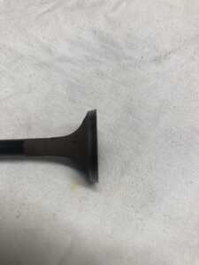

Okay guys, if you're still sticking with me on this post, some more interesting stuff today. My valve spring compression tool came today so I was able to easily get the bad valve out.
Pic 1-A. This is the piston with the bad exhaust valve. I hadn't notice that scuffed up area in the center when I pulled the head off the other day. I don't feel any rough spots when I rub my finger over it.

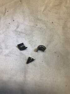

Pic 1-B. The valve keepers
Pic 1-C - 1F. The bad exhaust valve
Pic 1-G - 1I. valve seat

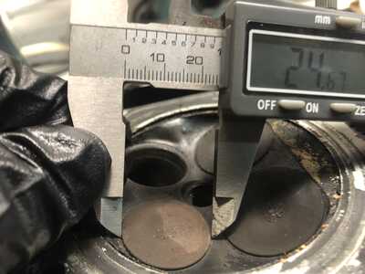

Pic 1-J & 1-K. I laid the bad valve face to face with the good valve in the same cylinder. It's kind of hard to see in the pictures, but the face surface of the bad valve is definitely smaller than the good valve.
Pic 1L & 1M. My digital micrometer shows that the diameter of the bad valve is about 2mm smaller than the good valve.
Patiently waiting for your thoughts, comments, suggestions.

(@floyd-h)
Posts: 61
Posted by: @floyd-h
Sorry, I forgot to say that the picture of the keepers is not 3 keepers, but one of them is broken into 2 pieces.

(@ben-franklin)
Posts: 327
Floyd, thanks for the pics.  I'm sure you will get some interesting advice.
My opinion:  You have a few options, depending upon how long you think you might want to keep the bike running and how much you want to spend.
Option 1.  Probably the cheapest, fastest option:  clean up the mating surfaces on the ebay head and engine block, leak test the valves with WD40 or some other such liquid, slap it on with fresh gaskets and oil, and call it a day.  Probability of success is pretty good if the seller isn't a complete liar and the valves pass the leak test.
Option 2.  Variation of option 1.  Remove all the valves, lightly lap them and install new seals.
Option 3.  Finish tearing down your original head, replace seals, surface grind head flat, buy a new valve (or steal one out of the ebay head), lap all valves lightly, reassemble, leak test, install with fresh oil and new gaskets.
Option 4.  Variation of #3.  Buy all new valves, lightly lap in, test, reassemble, etc.
Option 5.  Take the ebay head, or the original, to a competent OLD machinist, with at a minimum one new valve if using your original head, and ask for a nice 3 angle valve job with a narrow cut seat.  Inspect all seats, replace as necessary.  Tank the head, bead blast the ports clean, surface grind, install new seals and maybe if they do race work, clean up the ports and put it on a flow bench to adjust port flow.  This would be the option for "I want to keep the bike a real long time and I don't care so much what it costs, within reason."  Maybe a variation on this would include all new valves.  A further variation could have you pull the cylinders, inspect, hone and put in new piston rings, but if the bike was not using oil and no visible cylinder damage, probably not needed.
Now, what would I do?  Since you have a spare head, I would pick option 1 or maybe 2 and probably ride the hell out of it for a real long time.  If it pukes, take the remaining head in for option 5.  Probably will last a long time, though, if the valves seal and demonstrate this by holding liquid.  Of course, set the valve clearances correctly, on whatever option you select.
From what you are sharing, so far, I am guessing the nut backed off, hammered the problem valve spring retainer a few times to break the keeper, and the resulting chaos let the valve burn by holding it open from sealing.  Just my opinion, for what it is worth.
