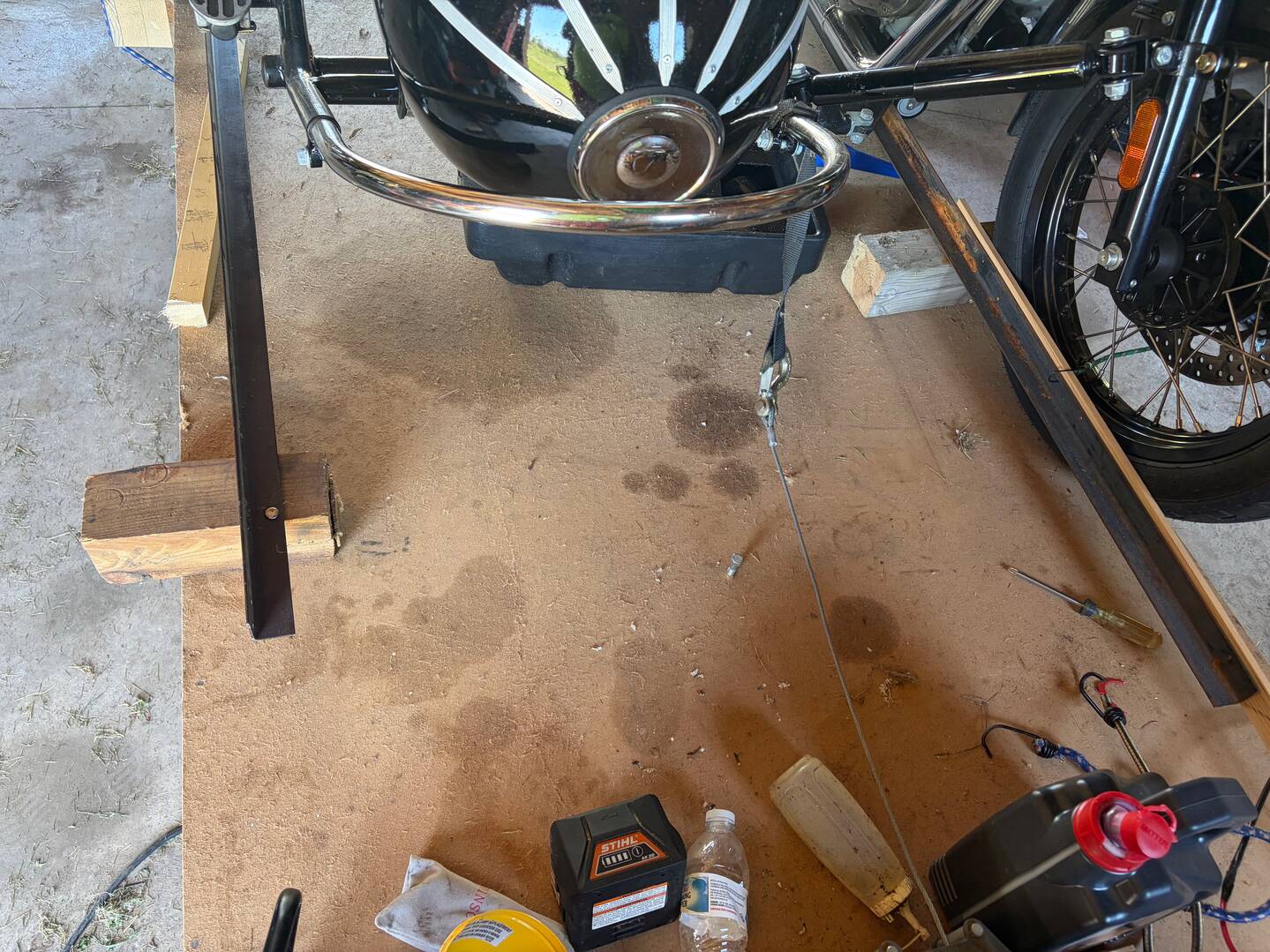

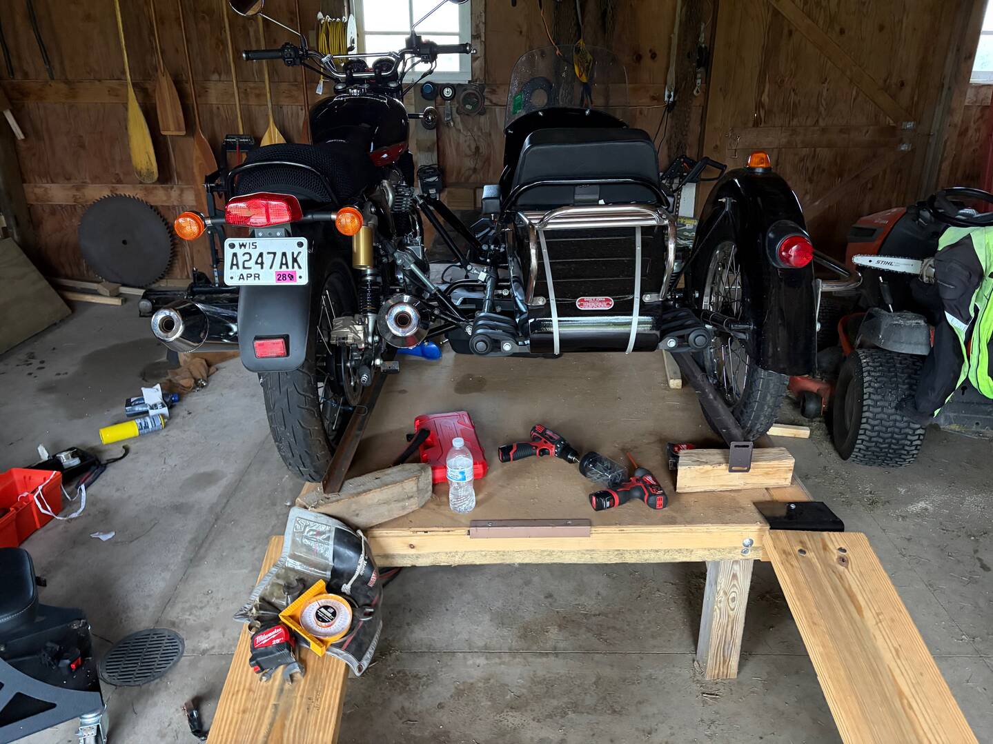

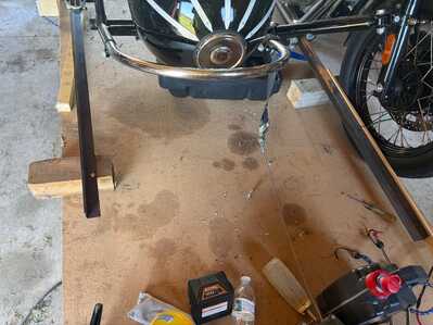

@brstr I finally got around to checking the lean-out and toe-in on the Royal Enfield/Cozy rig.  The lean-out is at 2 degrees which is reasonable, but the toe-in (at the front of the tub) was 1.5 inches, which seems to be excessive.  Also the bike’s wheels were not parallel, so I straightened that out.  I have Hagon shocks on order and will not begin the process until the shocks are installed.  I usee angle iron to check the alignment and toe-in.  I am curious as to what my first adjustment should be once the new shocks are installed.

My 1st question on your set up is regarding weight and your lean out.
When you measured the lean out were you on the bike or was it unladen?
Be a big difference most likely.
There are others who will have a better idea of where to start setting wise.
But my understanding is to go gently on initial settings.
Not much lean out and not much toe in.
My statement about heavier springs I think is still relevant.
Even just  heavier springs will help stability.
And maybe extra weight in the chair as Miles said.

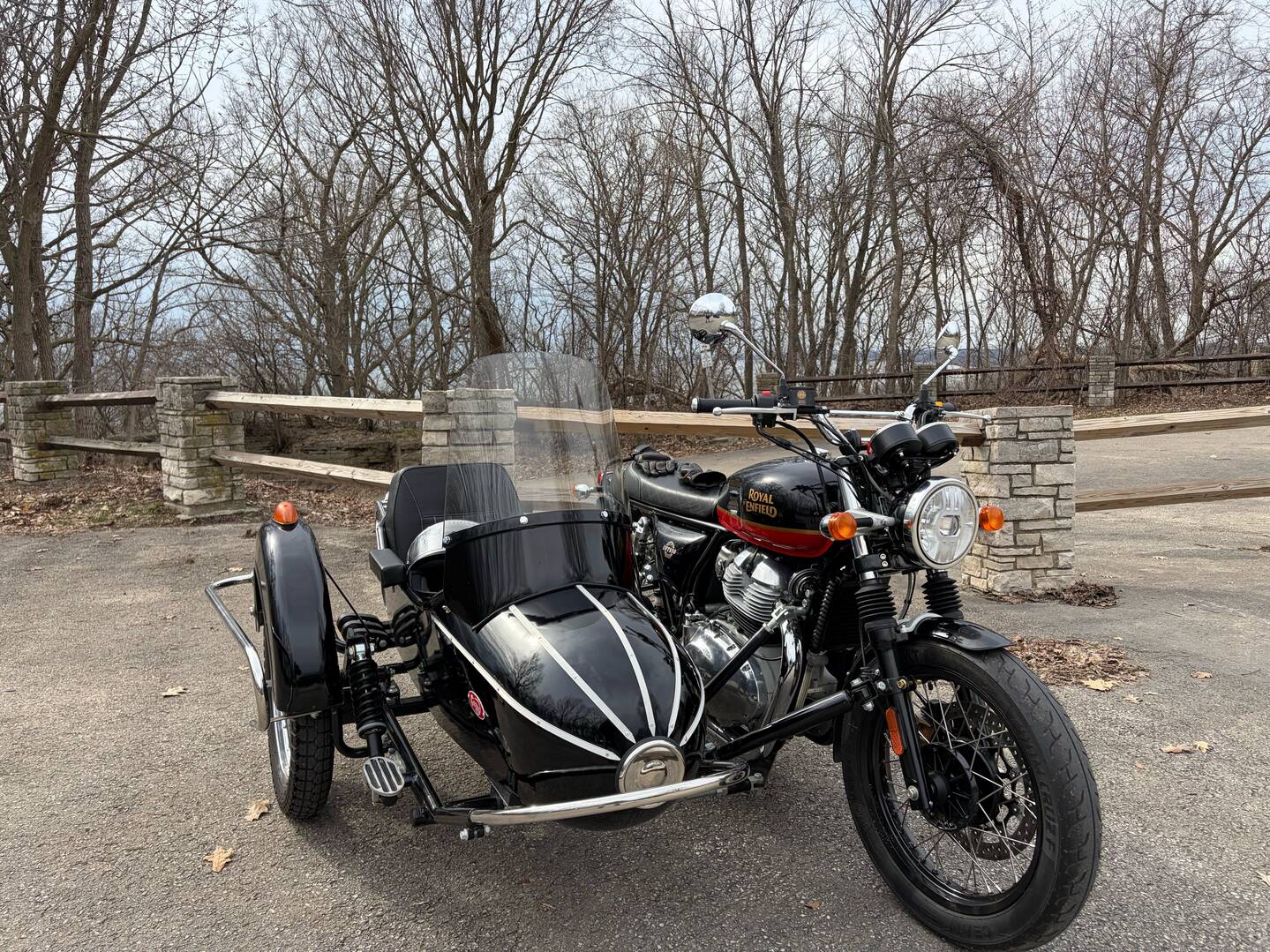

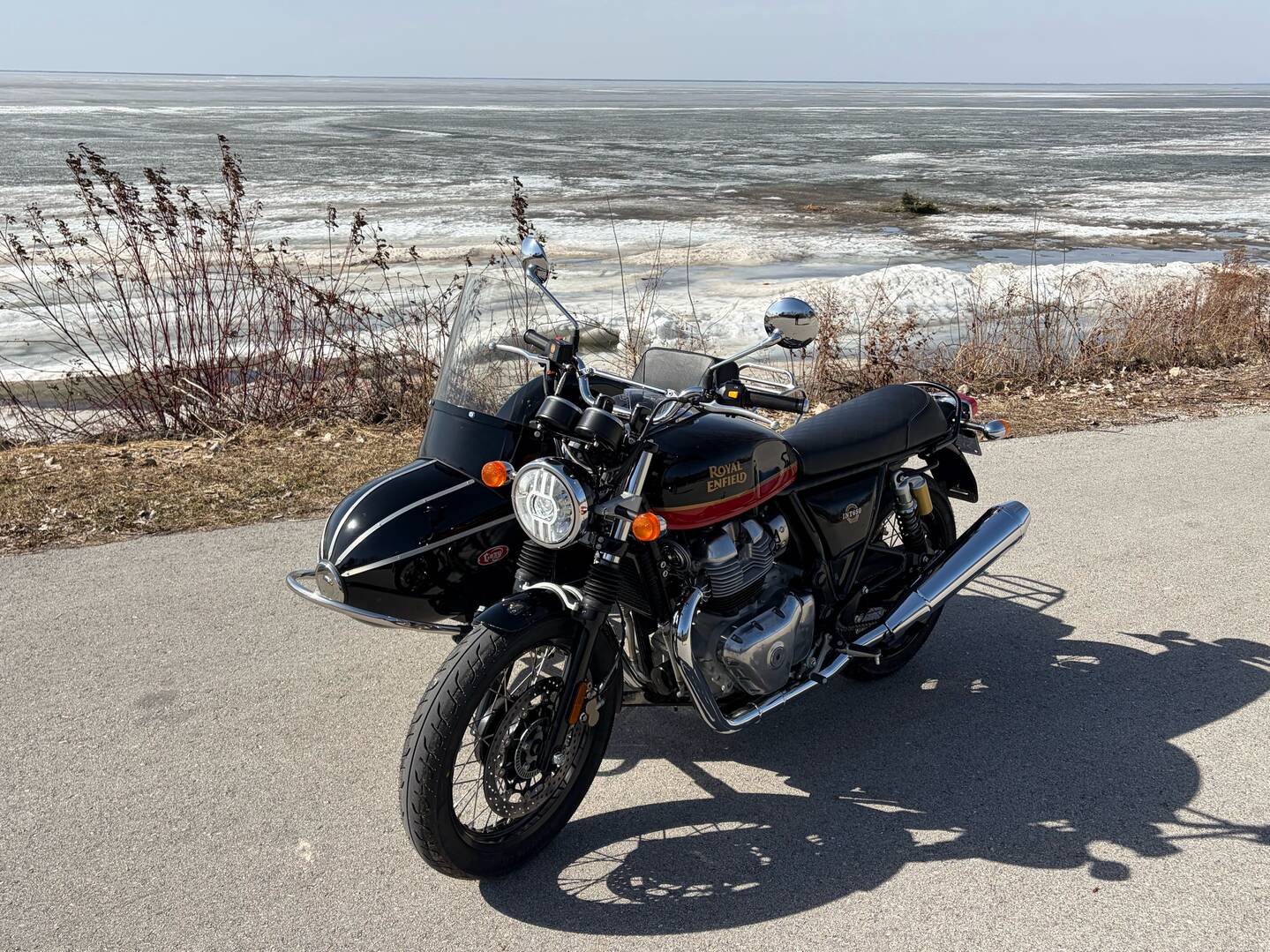

IMG 4521
IMG 4522
Thanks for the advice.  I will do lean-out measurements while sitting on the bike to see if that makes a difference.  But first I will get the new Hagon shocks put on and work from there.

Now that's just a funny thing.
I had it mind to be a 500 single.
Not so, you have the 650 twin.
Now we're talking.

Interesting that you have the full windscreen and collar mounted on the Cozy but without the grab handle. Is it stable like that? I had the windscreen mounted originally, but I have the passenger bar that mounts behind this to the sidecar body. There's 2 rubber collars on it that let it act as a brace for the windshield.
I wonder if without that, the windshield and it's mounting flange are flexing around at higher speeds and contribute to a twitchy feeling in wind. I ended up taking my windscreen off and leaving only the bottom flange to reduce wind resistance, there's only so much the 350 can pull 🤣
Posted : June 16, 2026 9:24 am
(@phyman1946)
Posts: 7
Interesting point about the windscreen.  I replaced the larger screen with a smaller one from Cycle Sidecar, but that was after I noted the original problem.  Long story short I checked the alignment and the toe-in was way too large and there was no lean-out.  It has become evident that whoever did the original assembly did not have a clue.  Even though I was able to dial in my Ural this rig seems to be setup all wrong, so after looking at it and then the Ural by comparison, I decided that it was time to call Bald Eagle Sidecar (featured in the Jan/Feb issue) to have them look at it.  We had a good discussion and, figuring that they probably are the experts I need, I will make the 7 hour journey to Hector, MN next week to drop off the rig for them to work on it while I do some camping in the area.  He said that they’ll probably remove the hack and start all over, which is a good idea. We’ll see how that works out.  The windscreen theory will be interesting to test, as the rig in its present configuration is really a problem in the wind.  I will post the results of all this in a couple of weeks.  Meanwhile, while my Ural tracks well, it does chew up a pusher tire with excessive wear on the right side of the tire, which usually occurs by 2000 miles.  Some guys insist that is par for the course.  I am 6’ 5” and weigh in at 260 pounds, which is undoubtedly part of the problem.  It may be that someone has so advice on that point.
