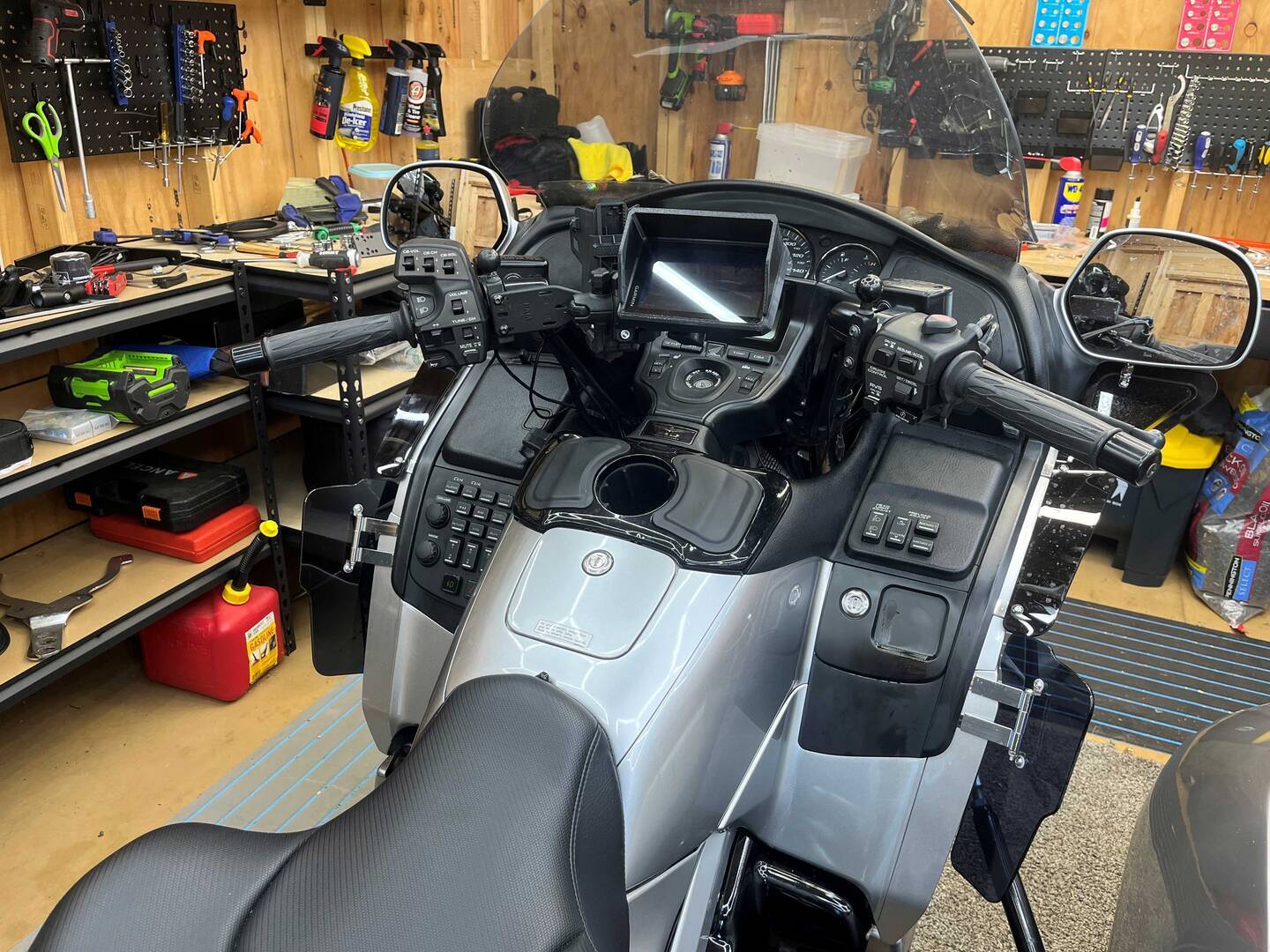

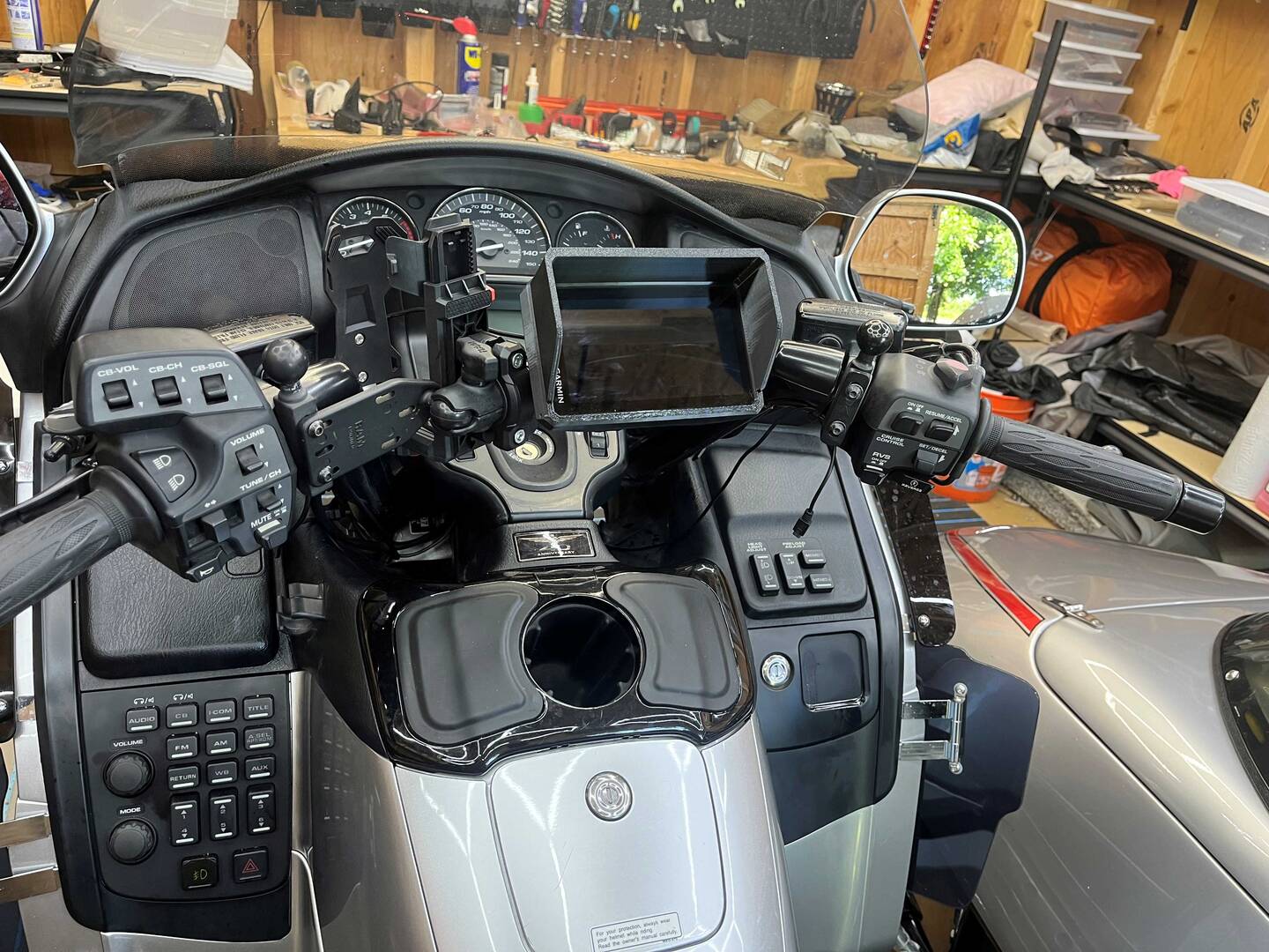

OK Steve can we have a pic of the existing bar set-up please.
Some of us are not very wing literate.
Then put you hands where you reckon they should be.....
Simple minds and all..... would like to see...

Hot off the press. I need to sit more upright so my hands need to be up higher and back.

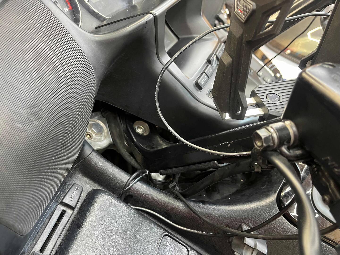

Oh, and Steve, next time before you spray WD-40 into the handlebar switch cluster on the right side of the handlebar, lay a cloth on the lower fairing area, so that when the excess WD-40 drips down onto the lower fairing, you don't leave telltail signs of this mess shown in this picture:
