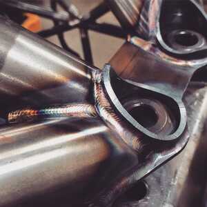

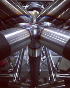

All I've seen are Lap, Butt, and Tee joints on flat stock.  I'd like to see it on tubing especially on coped connections like these

There is a bit of tube welding shown at about 3:05 into this video.  You make a good point.  The torch tip is pretty large.

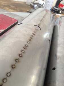

Notice that the cup is always dragged, very difficult to do with tubing fitted on angles.  But there are some really cool things like the smaller HAZ and the speed of making the connection.  This is especially with stainless steel, which was my speciality back in the 70's.  The speed and small has really helps with preventing warping, possibly preventing the need for closely stacked tack welds like I used to do.

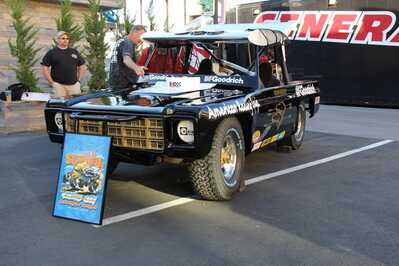

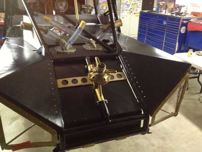

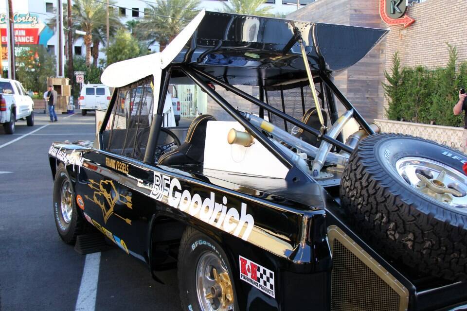

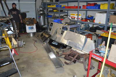

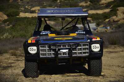

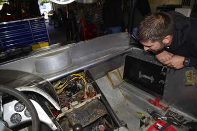

Nothing wrong with solid rivets if done right.  Lots of airplanes are still built using them.  I was involved in the restoration of the Parnelli Jones built "BFG Blazer" which had hundreds of solid rivets holding all of the sheet metal parts together.  I had to drill out a lot of rivets to remove different panels.  Bucking the back side of the rivets can be the most challenging part of the process. Some of you might recognise the name of one of the last former drivers of the Blazer. The Balzer was restored to it's former glory when raced by Scoop Vessels
Jan+3+Shoot+014
Jan+3+Shoot+042
Body Parts 1.21.13
BFG Blazer rebuild.2
Blazer at the Mint.2
Blazer at the Mint.3

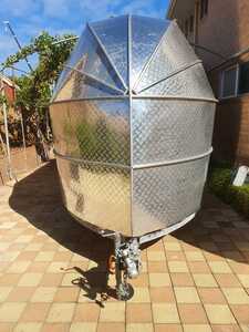

Solid rivets?
50 years since I last used solid rivets.
Check out the Furphy water cart.
It's my trailer canopy I riveted and bolted.
20250304 093604 1
