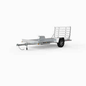

Jay, well, given that you don't want to drive 1,234 miles to save $ 2,500.00, allow me to spend more of your money, in a location much closer to you.
What you need is a BearTrack BTU76120F all aluminum trailer. https://beartracktrailers.com/product/76-wide-utility-trailer-3500/
There are several of us on these forums that own a BearTrack all aluminum trailer, and some of us have the really WIDE versions, as our sidecar rigs are that WIDE, or....PHAT.
Given that you have a Ural, you most likely only need the 76" wide version of these great trailers. That is 6' 4 " wide, and 10' long.
Have a built in folding ramp, and for the low, low cost of these trailers, there are NO other trailers that can compete with these.
Look on their website, find a dealer that is relatively close to you, and...buy one.
