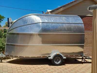

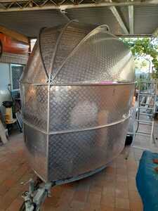

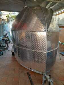

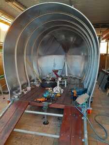

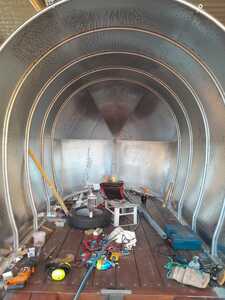

 The ali arguing continues. Hoping to most weather proof it top and sides before flying out Thursday.  Was very pleased to get the right front piece to fit nicely.  Well nice enough. Up sized the rivets in some places from 3mm to 5mm. Actually I  1st used tech screws to pull the metal together while shaping with a large hammer and blocks of wood. The removed the tech's,  then drilled out for 5mm.  Some of the sheets have water stains.  May require buffing and or phosphoric acid treatment prior to clear finishing. Nyalic.

Got close to finishing the body.

I'm digging it! 🤩

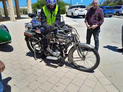

Wheels by 3.

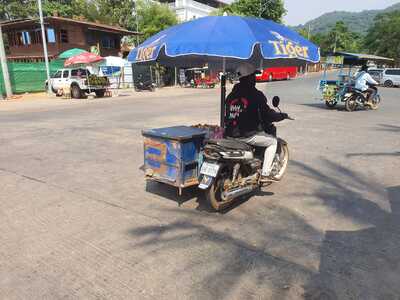

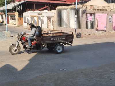

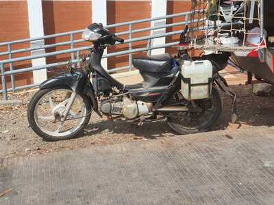

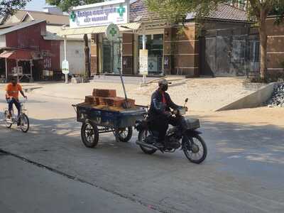

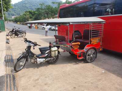

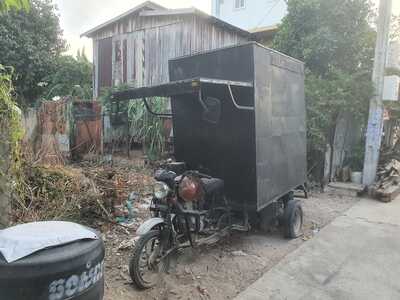

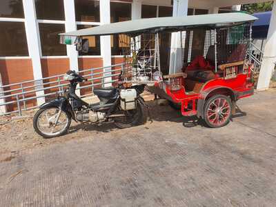

While in Cambodia I get reminded of what a truly great machine is in the humble Honda step through. Along with the multitude of copies.  There must be hundreds of millions of them.  If the speeds aren't high they are just the thing. A work horse with many uses.  Honda's request to his engineers was so you could hold it in your hand.
An Asian mindset that worked.  From my hotel in Kep I hear them purring by. Some sidecar content.
20250124 133042
20250124 134137
20250124 134132
20250124 134035
Of course it's a changing world. But these things probably had a much greater impact than the model T.

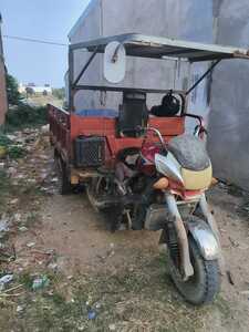

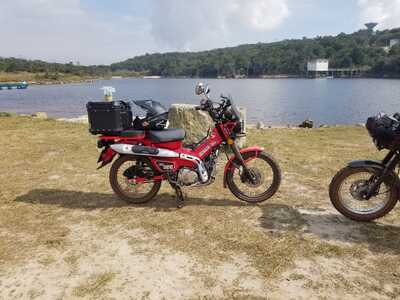

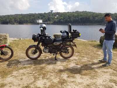

A couple of genuine adventure bikes.

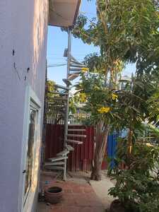

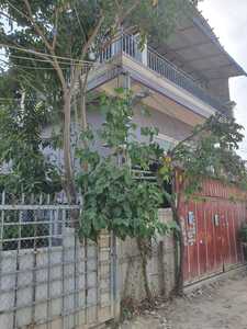

The house we stay at has stairs that vary in height from 140mm to 310 or so mm.
Older legs don't like this much as they have to get themselves up to the 3rd floor on a regular basis.
Not that we forget what we went up or down for at all.
Solution?
An external spiral staircase.
Made from what could be found at the local metal/ hardware shop.
Started this last trip a year or so ago.
Plans?
We went with empirical engineering.
A recent word I learned.
Suck and see.
The spiral part can only go so far then a short straight flight is needed.
Then a landing.
Will keep me busy and entertained for the next month till we head home.

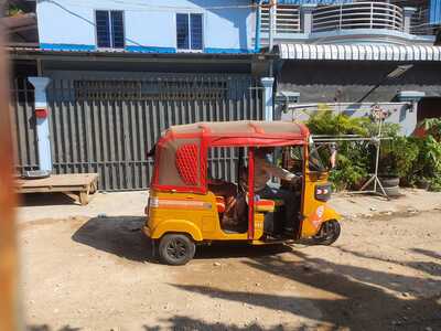

Only one went through for whatever reason. So let's see if can load a picture off the wife heading out in a TukTuk.
She went for a swim on a new hotel 32nd floor rooftop pool via some 3rd world roads then across to a 1st world shopping mall.

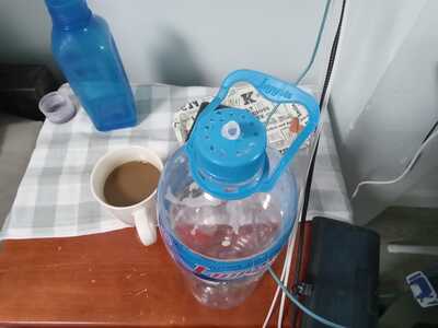

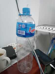

So here's a tip for a hot/warm shower without wasting water and they only have cold showers in the house.
Would work fine in the bush as well.
For a quick shower 1.5 litre.
The wife uses 2 to wash her hair and 1 when not.
A plastic bottle with small holes drilled in the lid in a circle.
Centre hole to fit a shortened drinking straw or plastic pipe.
It allows the air in.
Fill with cold and top with hot.
And Bob's yer uncle.
Or in my case.
Nephew, brother, dad, grandad etc.
Nephew jacked up on that and called his son........ Yep.
Jack....
True.

Great idea on the shower bottle, and they are available at any convenience store. 😎
