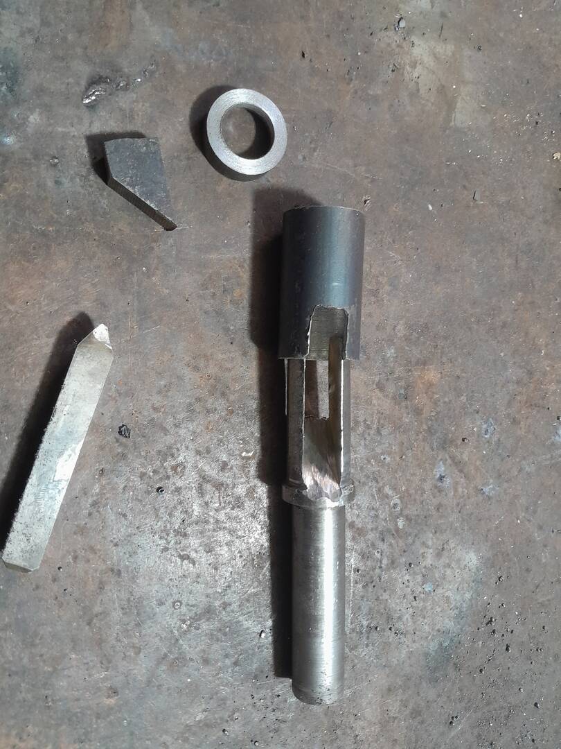

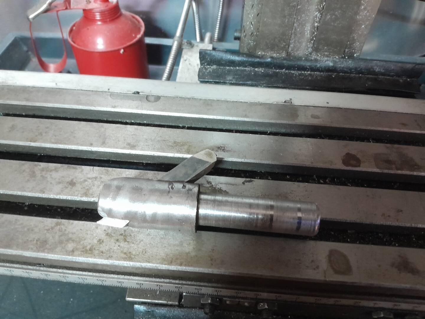

Made a fly cutter to start messing with the triple trees.

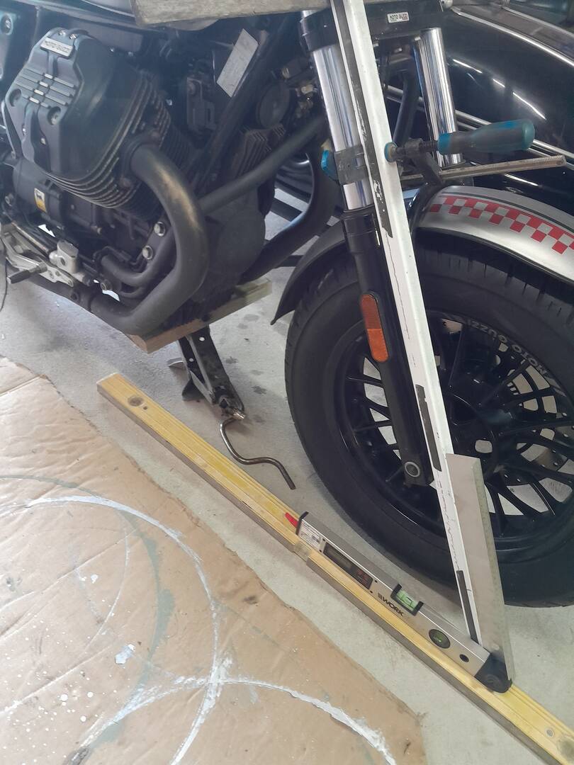

Posts: 730

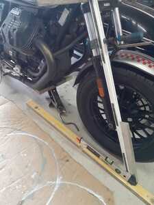

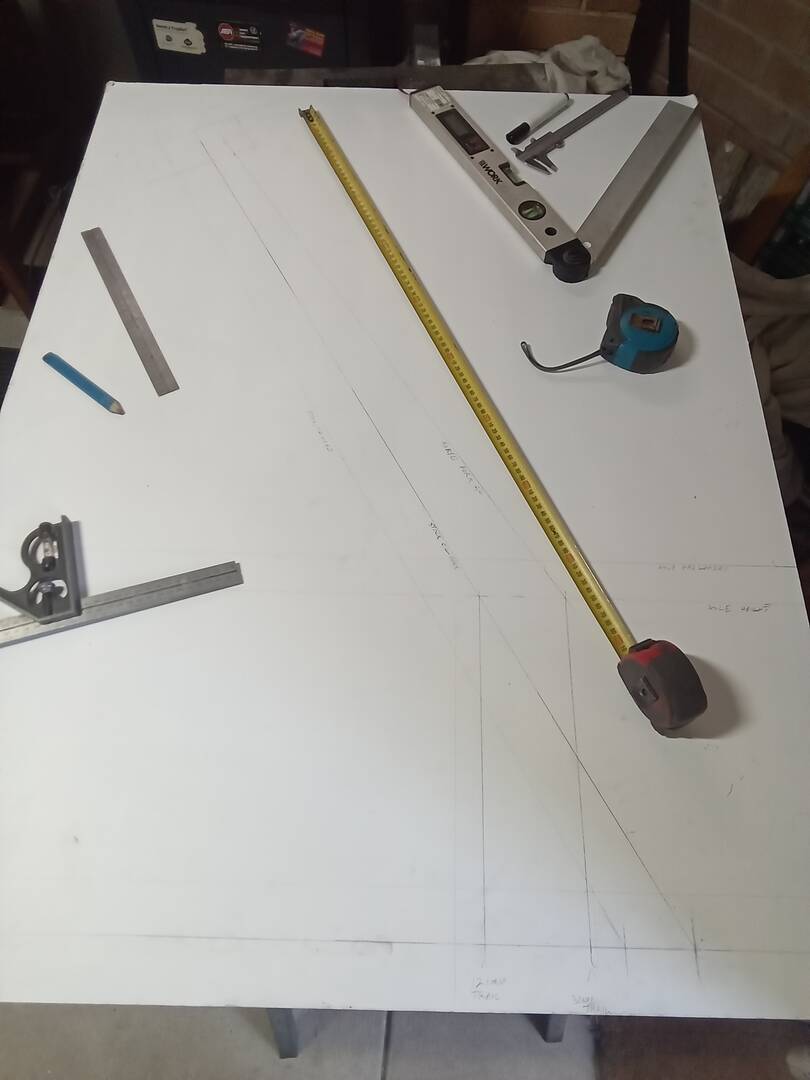

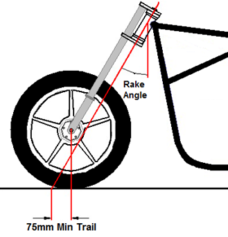

Started measuring again from scratch.
I've got my little machine shop set up mostly and a little space for the layout on a sheet of MDF board.
Painted one side white for clearer marking .
Drew the overall fork centre line and relationship with as many things that seem needed, logically.
Started with 30mm trail.
Also drew static sag of 43mm to see what that varied.
Nothing with forks parallel and minimal I think raked.
That comes with a small height loss, maybe 10 or 12 mm.
Will revisit with 50mm trail and see if there's enough metal to maintain stock  height.
Just a little over my head here so it pays to spend time away then come back with a slightly fresher outlook.
The current plan is to make another from wood to work out the design and the process required along with the correct procedures.

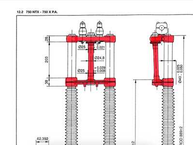

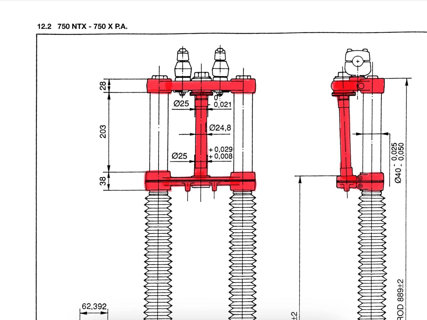

Envious of that modification you’re about to work on! I wanted to slap on the raked triple trees of an NTX 650/750 onto my V7 III, but discovered the V7’s steering neck is longer than the NTX’s (V7 III and V9 have the same beefy steering neck length). Was thinking about getting some raked triples custom made. The NTX might be the only Guzzi small block with a raked triple.
I don’t know if it’s worth anything to you, but here are the specs of the NTX 750 triples, taken from its workshop manual:
IMG 8635 Original
