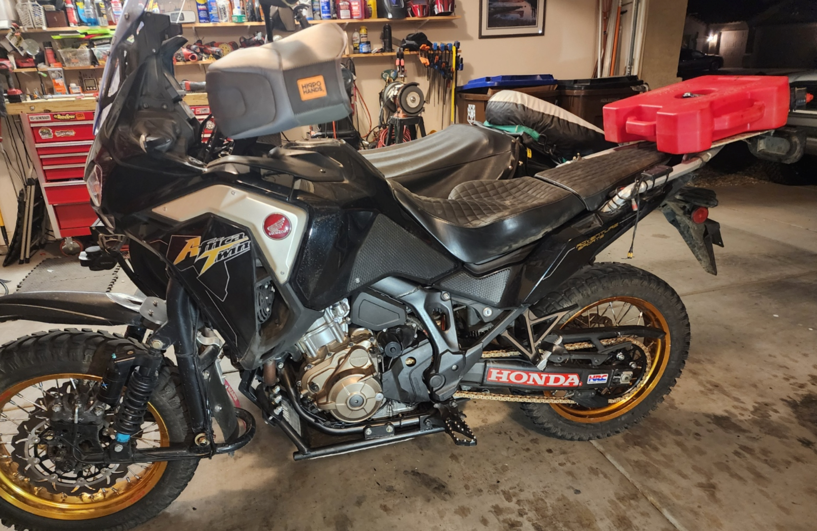

New sprocket on top. There was some significant wear.
Rear sprocket had a little wear, as well. Not beyond usability, but I wanted to change the ratio, anyway, so replaced it.
All pretty again, and ready to ride.
Took it for a little rip around Skunk Hollow, and definitely like the gear reduction. 1st gear is pretty snappy. Didn't test to see if it will pull redline in 6th, but kinda doubt that it will. Riding tomorrow, so will see how it does at cruising speeds.

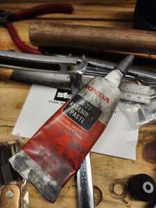

How are the transmission output shaft splines doing?  One of the things I like about the JT sprockets, is they are of a softer material than the output shaft.  Unless there is a build up of fretting corrosion that is allowed to oxidize, normally output shaft spline wear is limited to just a light polishing.  The sprocket takes the brunt of the wear. 👍   Honda has a really good Moly paste that works great with just a thin haze applied to the splines.
I've run tool steel sprockets before, but only on MX bikes that were torn down and rebuilt consistently (the bikes I raced).  I wouldn't want to run them on a bike that saw occasional maintenance.
Posted : February 7, 2025 10:22 am
(@ben-franklin)
Posts: 326
17389800995001770071027120213982
Dis stuff? 🤑
Splines are doing great, no visible wear, since new.
I think the OEM countershaft sprocket is quite a bit harder than the JT, but $49 vs. $14, so will probably just change the JTs a little more often.
Posted : February 7, 2025 9:06 pm
Posts: 1579
Posted by: @ben-franklin
Dis stuff? 🤑
dat stuff is referred to as Honda's anti-F it lube, or the opposite of KY jelly.  Shut Mouth
