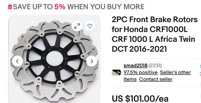

Well friends, the special Chinesium front brake rotors that I ordered off fleabay came in a couple of days ago, and I found time in my busy schedule to screw with putting them on, today.
Why special Chinesium vs OEM or Galfers? Well, a pair of no name China rotors were $101 for the pair with free shipping, vs $331.60 each for Galfers and $510 each for OEM.
I was not all that impressed with the slightly less than 38,000 mile life span of the Galfers that came with my Woody's Wheels, especially the rear one, where they were off about .4mm in the diameter of the bolt pattern. (Which I speculate had a lot to do with rotor bolts repeatedly backing out on that disc.)
Galfers Front Rotor, right side only. Precision made in Spain...
:rofl
So I thought, well, at $100 for the pair, I wonder how bad the Tarazon branded Chinese rotors really could be? The China factories are cranking out stuff for CF Moto and likely other brands, so maybe they can make s suitable brake rotor.
I have seen a few CNC machined accessories, lately, from NiceCNC in China, with surprisingly good quality.
Here is the Ebay ad that I purchased the pair of front rotors off of:
At the unboxing event in my garage, I noticed that they seemed a little heavier than the Galfers. It turns out that these rotors start life out with a 5mm disc wear area thickness and call for a minimum thickness of 4mm before discarding. The Galfers that came on my wheel appear to start out at 4mm and call for a 3.5mm min thickness to discard at.
The Galfer website is silent about their current design's thickness, but zooming in on the picture shows 4mm min thickness on their current product, so maybe the weight is the same on the new Galfer model.
Here is what a worn Galfers rotor from my front wheel weighed: 1,210 grams.
Here is what the new Tarazon rotor weighed: 1,485 grams.
So at two rotors, double the difference of 275 g per rotor, for a 550g increase in unsprung weight. Not great, but will see how noticeable it is out on the wash boards.
Other than the thicker stainless steel friction surface, and two additional buttons from the style on my front wheel (but same as the new style Galfer), the quality appeared to be similar.
The fit on the hub and the alignment of the bolt mounting points were the same. The offset was the same.
Installation went smoothly. I'll probably go to hell for reusing the front rotor attachment bolts, but since they are steel bolts threading into an aluminum hub, I don't think they saw much stretch.
I torqued them with blue loctite at 160 inch/lbs, about 10% less than the 180 inch/lbs the manual calls for, to compensate for using thread lube.
Installed on wheel:
Wheel on bike:
