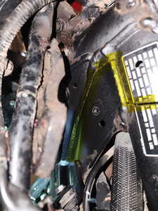

Today, I continued chasing popping/squeaking noises in the front area of the bike, and finally found it...
Β
:devildog
Β
Apparently a shock transferred to the steering head, maybe a long time ago when I was having trouble getting spring rates right and was bottoming out the front a lot. I found that it had cracked a couple of frame tubes where they join the steering head.
Β
I kept hearing a slight popping noise that finally got to be a slight movement to be able to see between the steering head and gas tank during low-speed braking.
Β
Just pulled the tank and airbox and figured it out...
Β
Planning on building a gusset and welding it up. Have to do a little further tear down before starting that though.

Will design a gusset that spreads the load a little further down the frame tubes from the joints where the current little gussets stop.
Β
Probably just a step towards building a frame/subframe combo out of Chromalloy, eventually, but will get it back on the road for a while!

Congratulations and well done.Β
You broke a Honda.Β
But ouch it's a nastyΒ  break.Β
In more ways than one.Β
Here that would be an official write off.
There's a legal term I'll think of later.Β
A bit of hot and sticky should fix it though.
Should keep your TIG skills up nicely.
Spent a fair bit of time in Cambodia recently stick welding 1.5mm and 2 mm tubing.
Yours should be easy.

Dane....WOW.....just WOW !
Not that having the original Honda Warranty would be much good in this case, due to the sidecar attachment....but enquiring minds want to know, did you buy the Honda Extended Warranty for this bike, and is it still covered ?????
I rarely ever buy the Honda Extended Warranty, because....it's a HONDA. But I did buy it for my 2019 Wing w/DCT, simply because of the added wear that the DCT "may" take, when used as a sidecar tug. My local dealer told me THEY would cover any warranty issue, even with the sidecar use, as long as I removed the sidecar so they could work on it in their shop.
You may want to think about finding/buying a wrecked AT 1100 Adventure Sports, and use the frame from it, as a starting point to build a BETTER mousetrap.

@miles-ladue Miles,
Β
Nope, didn't buy a warranty, so no go there.
Β
IMG 20250317 150923
I found a frame on ebay, but not sure that the AT frame is really strong enough around the steering head.
It looks like the side loading flexes the frame torsionally at the steering head, and it gradually fatigued.
Not any good way to brace against that force.
So, I see a decision point:Β Β
Β
1. Call insurance.
Or
2.Β  Weld it up, and decide that i found the platform's limits.Β  Then plot out a custom build with a stronger frame/integrated sidecar, while riding BBTBB for another year or so.
Β
I'm reasonably sure that i can weld and gusset it up stronger than OEM, but not likely "strong enough."

Dane, one idea....make an insurance claim....they will total the bike as a complete loss. You then buy back the total loss bike back for pennies on theΒ  dollar,Β  reweld it, weld on a saddle gusset,Β  then ride it again.Β

@miles-ladue Thinking about that, but not sure i want to pay the rate increase across all the vehicles that would likely yield.
Will be doing a little more disassembly/inspection today, while I think about it.
