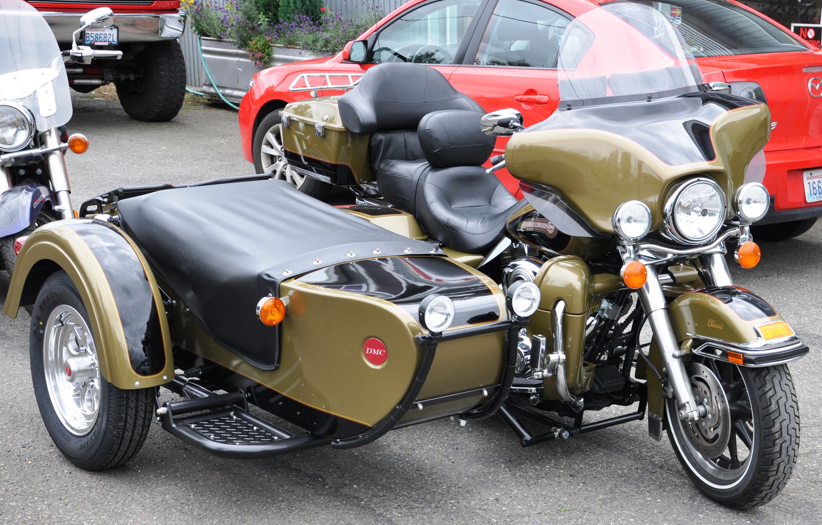

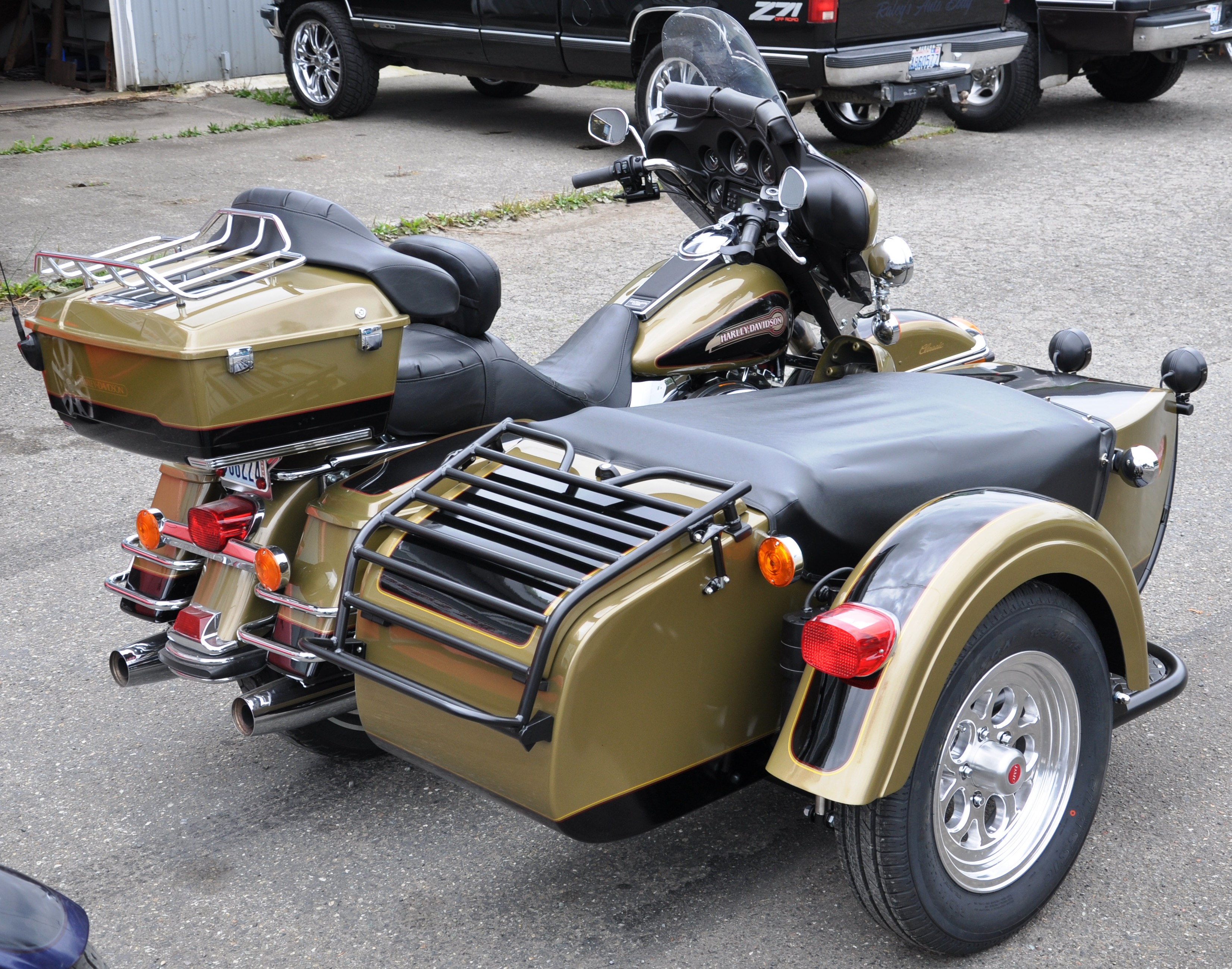

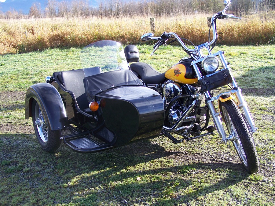

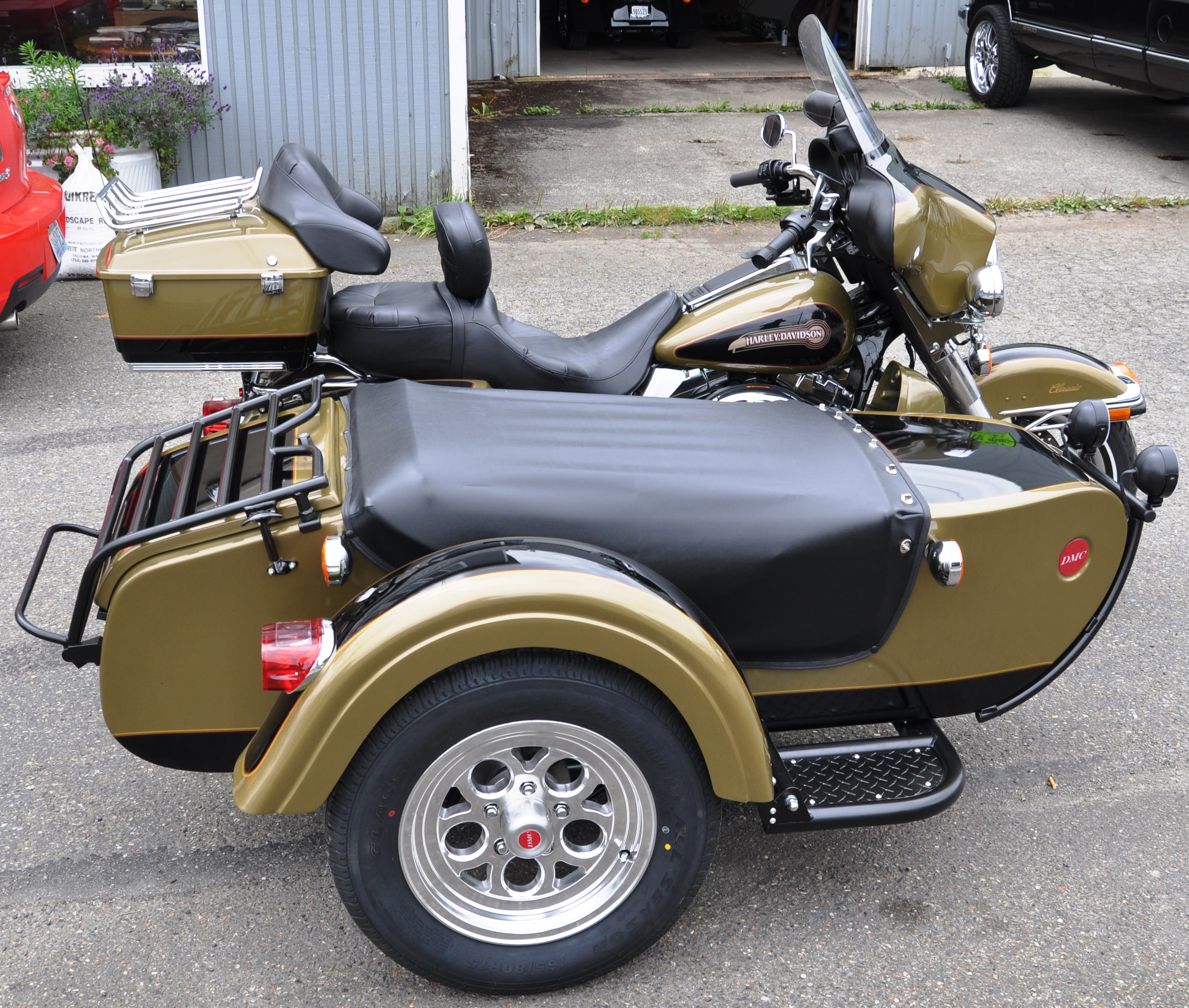

You might also look at our M72C and M72CX both of these sidecars are much easier to get in and out of as they have a step built into the side, the body is cut down and the optional windsheild folds all the way forward and out of the way. These sidecars also have a trunk that opens from the out side, seals and locks. The sidecars bodies are mounted on rubber vibration isloators and the chassis have full swing arm suspensions with progresive brand shocks. We offer many options including a brembo disk brake, racks, electric trim and more. Both sidecars come with real bike specific not "universal" mounting hardware. For your bike we also offer triple tree's to lower the steering effort and if you have exhaust pipes down both sides of the bike or switch over to dual pipes then we also offer real engine driven reverse for the bike.
The M72CX is 4 inches wider then the M72C and comes with the disk brake as standard. For either sidecar you can choose between a 16 inch wire wheel or one of 3 different automotive wheels.
