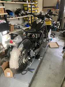

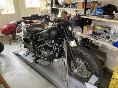

I just went out, took a quick look at what you suggested and that looks easier than routing it front to back underneath the frame.  It would be more visible than underneath, but just as effective.  I’ll have to get the Fatbones up on the table to get a better look. Currently on the table is a 46/47 Indian Chief bobber project that is almost ready to fire up for those of you who like old iron.

Photos for reference-

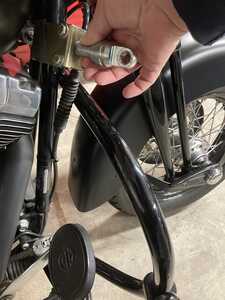

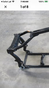

More things to ponder.  When I took off the stock mufflers the original muffler bracket had to be removed and replaced.  The original bracket was very rugged (Cast?) and part of the frame structure.  The new muffler bracket was light weight 1/8th bent sheet metal.  By changing the mufflers several years ago I lost the lower rear mount location.
Everything else will be on hold until that problem is solved.  I’m going to make some calls and see if I can find a similar softail frame to evaluate  for an add on bracket mounting location.  It’s too hard to see under the bike for options.
The to do list grows and timeline gets longer but each day I’m identifying problems and eventually making progress.

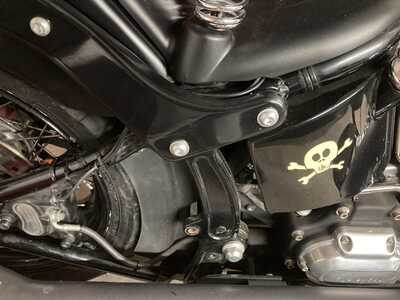

(@chloespop)
Posts: 105

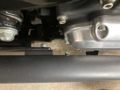

IMG 8457
IMG 8456
Should have checked eBay for 2009 softail frames before posting the last message.  There are two mounting holes hiding behind the mufflers that would work for the lower rear mount location

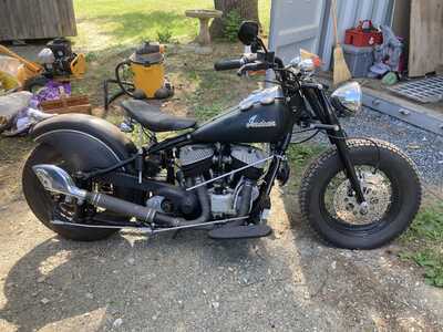

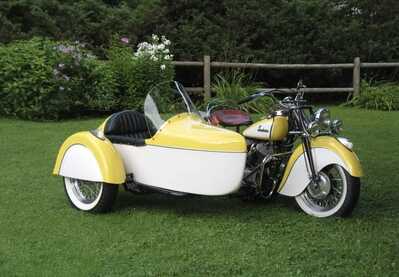

its a much bigger project than I anticipated, but aren’t they all. Here is a picture of a rebuild that did not include my doing fiberglass ,,,,, just everything else imaginable

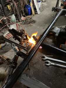

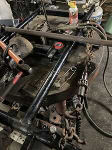

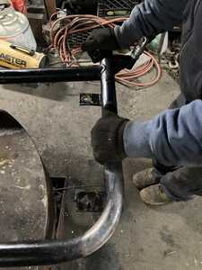

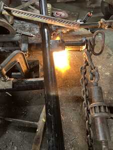

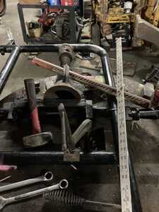

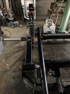

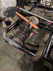

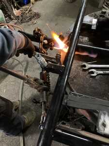

  • Today was the day.
Took the sidecar frame to a friend and we successfully straightened the frame and swingarm.
We clamped the frame to a heavy steel table and used chains, house jack, ratchet “come a long”, c-clamps, bars, heavy hammer, squares, levels, tape measure, fire (heat), coffee and a rotisserie chicken to get the job done.  Everything is where it once was and needs to be!

Amazing what a bit of coffee oil and chicken grease will do to get things in order! 😉   👍
Posted : February 6, 2025 6:40 pm
Posts: 1583
Love it, and love that you used a rotisserie chicken 🐔 to get the job done.
Posted : February 6, 2025 6:42 pm
Thane Lewis, Brstr and sheath reacted
Posts: 546
Rotisserie chicken avoids hot spots/kinks.
Well apart from your back. It probably can't take that heat......
