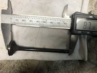

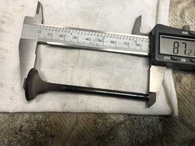

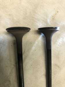

Here's the good valve (left) and bad valve (right) as a poster on the COG forum suggested that I show. The other two pictures show the total length of each valve, which are the same lengths.
I put the good valve in the bad valve's position and installed the springs and keepers. I didn't try to lap it at all. I then turned the head upside down, leveled it some, and applied a pool of kerosene all around the valve face. It didn't hold and seeped through to the other side.
So, I think, as some of you have suggested, I'm going to just go with my eBay head. The eBay seller, The Motorcycle Guys Salvage, told me that head was off a bike with 7,691 miles. His seller's page says he has sold 287,000 (!) items on eBay and has a seller feedback of 99.6% positive. So, I think I can trust him pretty good as far as being an online used parts vendor. A friend of mine has a small machine shop. He's not set up to resurface that head, if needed, but he said he does have the equipment to verify if the surface is flat. So, I'll try to get it over to him this week to take a look. I'll do a leak check on all the valves with kerosene or some other liquid. If it passes that I don't have any concern about not replacing the seals with only 7K miles on this head.

@floyd-h Yep, sounds like a plan.  There is quite a lot of carbon on the valves from the old head.  Probably less on the ebay head.
If it is reasonably flat and the valves hold kerosene, you should be good to go.

As a mechanic, disclaimer, a lazy one as of late. I would go with Option one. But at minimum, test the used head for leakage the same way you did the Old one.. The suggestions to have it gone through are valid but maybe not necessary. Depends on if you want to spend money up front or spend it doing the job all over again.. Never enough time and money to do it right, always enough to do it over kind of thing..  In my opinion the old head is junk.. it might be salvageable but it will need at best,  a good valve job by a good machinist. More than likely it will need a new valve seat installed. From the look there is nothing left of the seat. New seats are pretty specialized work and not every machine shop can do it properly. Ask how I know that.. :(.   Part of that, do it over, and not on the customers dime. lol8

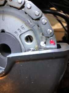

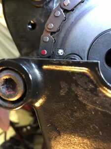

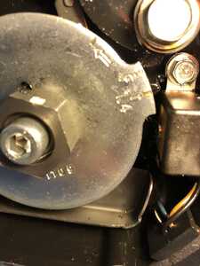

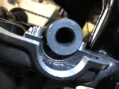

2   Intake Cam Sprocket
1   Timing Rotor
4   Exhaust Cam   not seated
3   Exhaust Cam Sprocket
I haven't forgotten all of you and hope that all of you who have offered very helpful advice on my original valve questions have not forgotten about me. I think a few of you are familiar with the first generation Kawasaki Concours so I'm especially relying on your advise.  I've finally got my "new" eBay head on and carb bank installed. (Hate dealing with getting those carbs off and back on) Now I'm trying to get the camshafts set in the right position and want to make sure I've got it all correct. I've got the camshafts set in position with the timing chain on the sprockets, but have not put on the cam caps yet. I set the timing rotor to the 1.4 mark (pic #1) My Clymer manual says to set the camshafts so the IN and EX index marks align with the top edge of the cylinder head. Then locate the first cam chain pin that aligns with the exhaust sprocket EX mark. Then count 35 pins towards the intake sprocket. The 35th pin must align with the IN mark on the intake sprocket. I did all that and marked the #1 and #35 pins with red fingernail polish. As you can see in the pictures the #1 pin lines up exactly with the EX mark (pic #3), but the #35 pin is just above the IN mark (pic#2). The IN mark is more in the middle of the link and not aligned with the 35 or the 36 pin. Also the exhaust camshaft does not sit flat in the journals. The end opposite of the sprocket tends to stand up (pic #4). Prior to putting the chain on the sprockets it would sit flat. Is that just because I have not put the caps on yet and torqued them down? If you need more pictures or explanation as to what I've done please let me know.

Floyd, if I may offer an  Easter Sunday quarterback opinion on what I see, after reading your post. I believe you are correctly timed.
I personally would not have installed the carbs, until after completing the  camshaft installation and valve gear timing.
However,  I believe that the primary issue with the camshaft not sitting flat into the  journals, is because the cam lobes need to compress the valve stems.
Using assembly lube, or at a minimum using new clean engine oil on the camshaft, and in the journals, GENTLY tighten the camshaft caps, in correct order,  to seat the camshaft into the journals, so that the camshafts are fully seated.
If the timing chain is still in place, using a large socket, slowly rotate the  crankshaft a 1/4 turn one way, then a 1/2 turn back the other way. Then...a 1/4 turn back to where you began,  so that the timing marks line up again.
In those small rotations, did everything FEEL  smooth  ? Meaning,  no valves hitting anything.
If you believe that you have the camshaft correctly installed,  and rotating smoothly,  then....look at direction of engine rotation....then rotate the engine,  via the crankshaft by hand, in the opposite direction of correct engine rotation....just a 1/4 turn backwards.
Now...rotate the engine forward that same 1/4 turn, back to the correct timing marks, as you have now removed any slack in the timing chain,  and now look to see exactly where your prescribed timing marks are.
I think you ARE going in the right course of action with this engine.
If all is correctly timed, properly lubed, and correctly installed,  you can now rotate that crankshaft by hand as many rotations forward or backwards as you desire, proving that smooth rotation of all moving parts is there, and you will be good.
