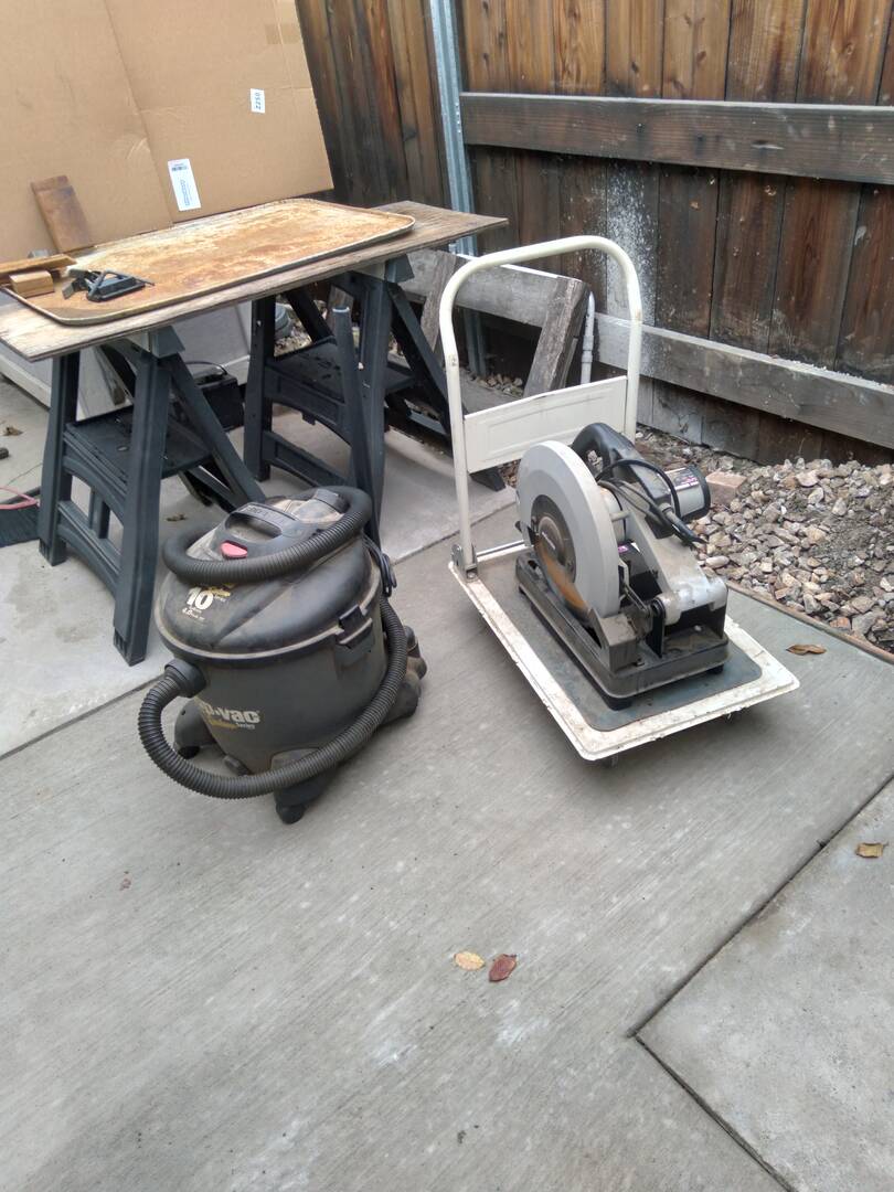

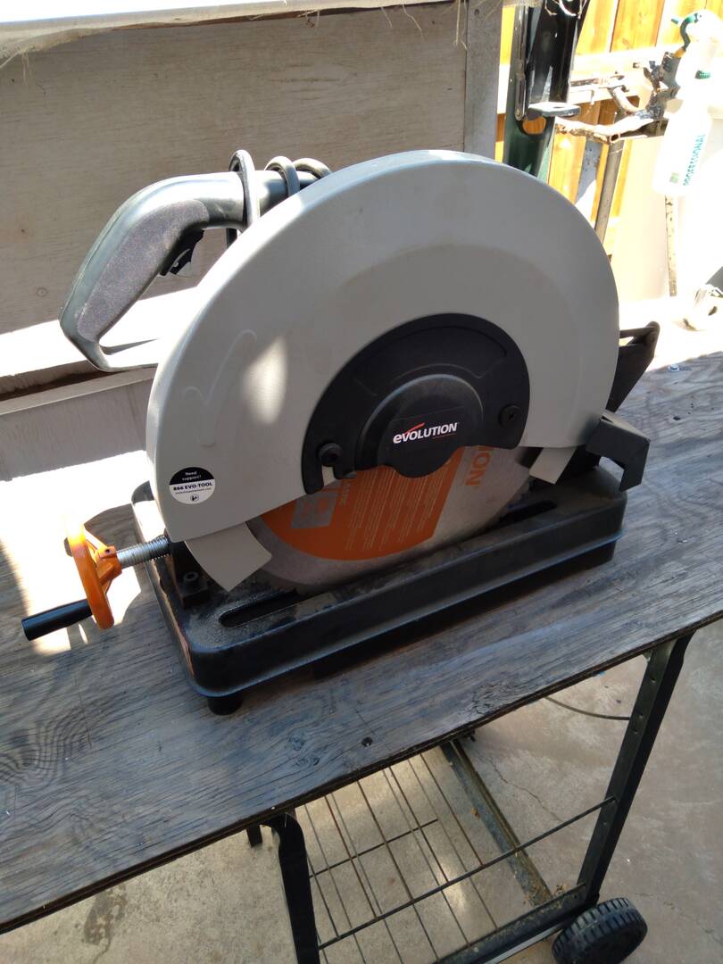

Michael Lydon I don't have them do that for me, although Online Metals, where I sourced the steel, does offer custom cutting. I have this, which makes quite a mess, but the cuts are very square and clean. All of the pieces I just got, would need work to square the ends up.

Chris, on that saw, is the blade a diamond , or carbide, or dilithium crystal ?

(@miles-ladue) Tungsten Carbide Tipped, no shower of sparks like an abrasive wheel, but puts out it's share of hot little chunks of metal. Loaned my crystals to a dude named Scotty years ago, never saw that guy again.

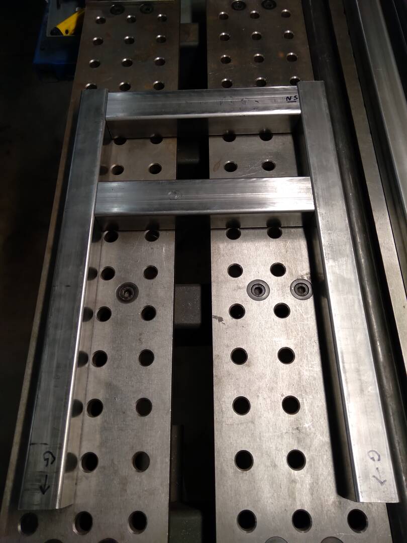

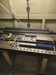

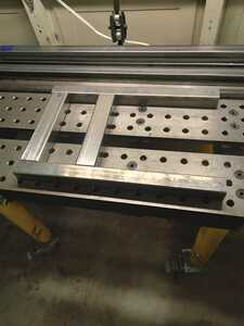

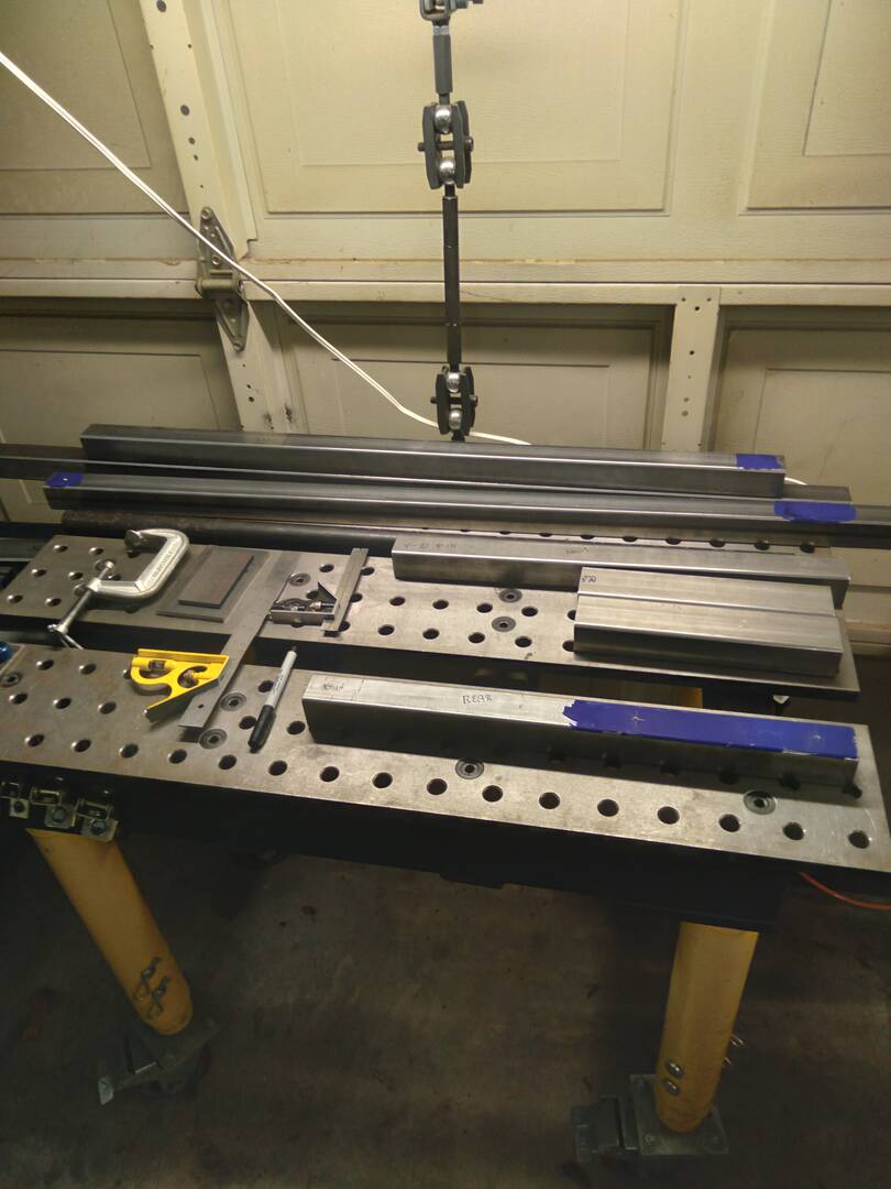

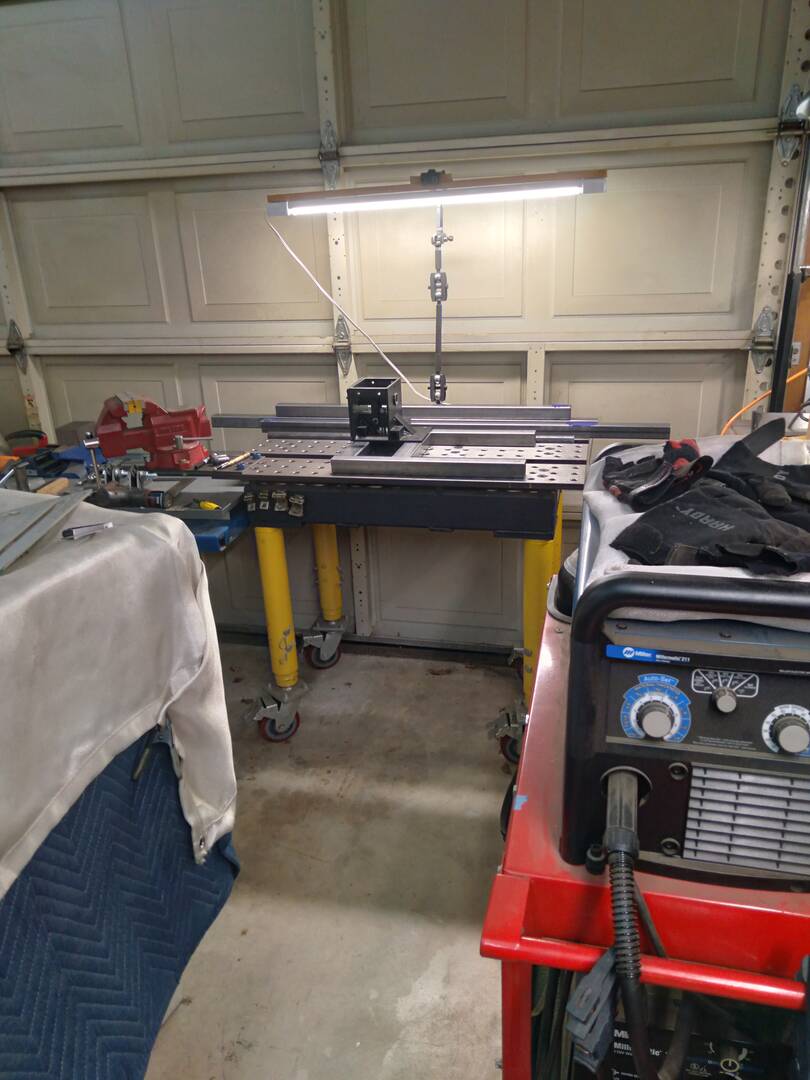

Finally some progress. We've been fogged in for weeks, which is keeping the temps in the low 40's so everything outside just stays wet. Plus some new concrete poured right where I need to work a week ago. But I was able to get the most important pieces of the new chassis cut today. Hopefully I can roll the drill press out tomorrow and make a few holes.

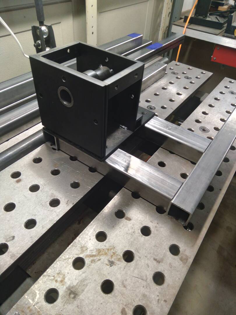

This part is important because it is where I will mount the 15+ lb. 6x6x8 inch hunk of steel that is the axle block. With much gratuitously added steel, and triple redundancy axle tube retention, this thing is a key part of getting weight as close to the wheel as possible, and it needs a strong foundation.

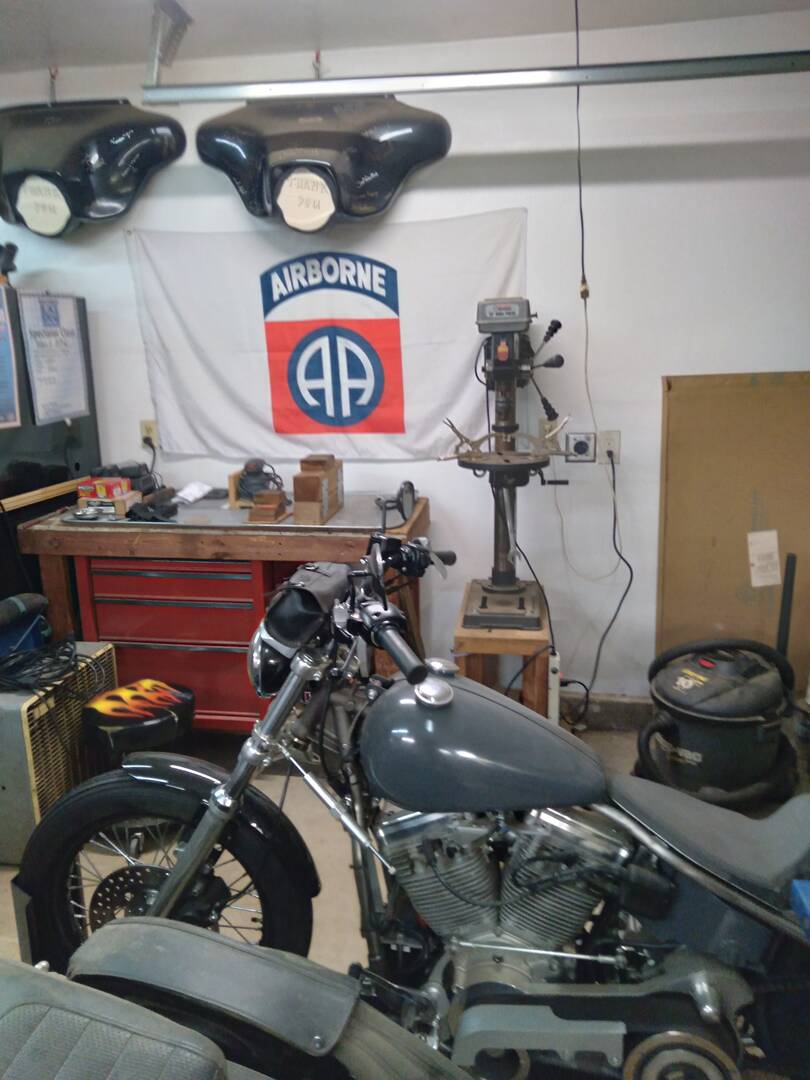

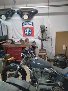

It looks like our weeks of wet fog may end soon, because rain is on the way. So I'm setting up to drill about 20 holes inside, each one takes some time to set up, then drilled in stages, so it will take awhile. I prefer doing this outside, because I can police all the metal chunks easier, the garage is attached, and bringing them into the house, is frowned upon in this establishment.
