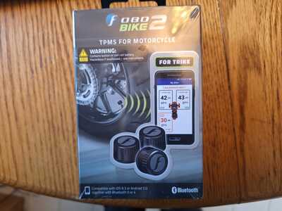

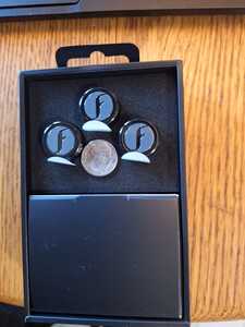

I will be experimenting with these on Sidecar and Trike.

I doubt it would be an issue They are 7.6g.  They come with stems many stocks one are no strong enough for an add on's to them

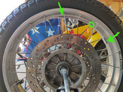

I was interested in knowing this as well when my cheap kit showed up, as the caps felt "significant enough" in the hand.
As a test I tried balance with and without for the Amazon Special Caps installed.   While the balancer picked up the difference, it was less than the 1/4 oz weight size (smallest I had).  On the front I ended up splitting the weight into two groups with a total weight slightly greater than the amount required to achieve balance.  then clocked them such that the spread balanced the wheel correctly, and took account of the pressure sensor cap.   Seriously doubt it would have been noticeable.  I didn't do that on the rear, but it seemed to balance out well with the weights in one spot on the rim. My experience is the rear balance is much less noticeable, than front.  But this could be my fat arse, versus skinny hands. lol
 Front wheel assembly: Green circle is lightest point on assembly.  Weights installed where green arrows are located.

I have been known to follow different paths. On my Trike The rear wheels were drilled to t except Standard and TPMS stems. So I have both installed.
Before HD put a screw to it you could once in Trike mode enter HD sensors in the BCM and all 3 would read out. HD put a stop to that.
That is why I am playing with FOBO. Will not need T as I already have a second Stem.
I do want to use FOBO on the sidecar Rig also.
 The FOBO 2 units are cheaper than purchasing HD TPMS sensors. They also do more.

Been running the Fobo2 set on my sidecar rig for a year or so. I'm happy with them and have no complaints.
