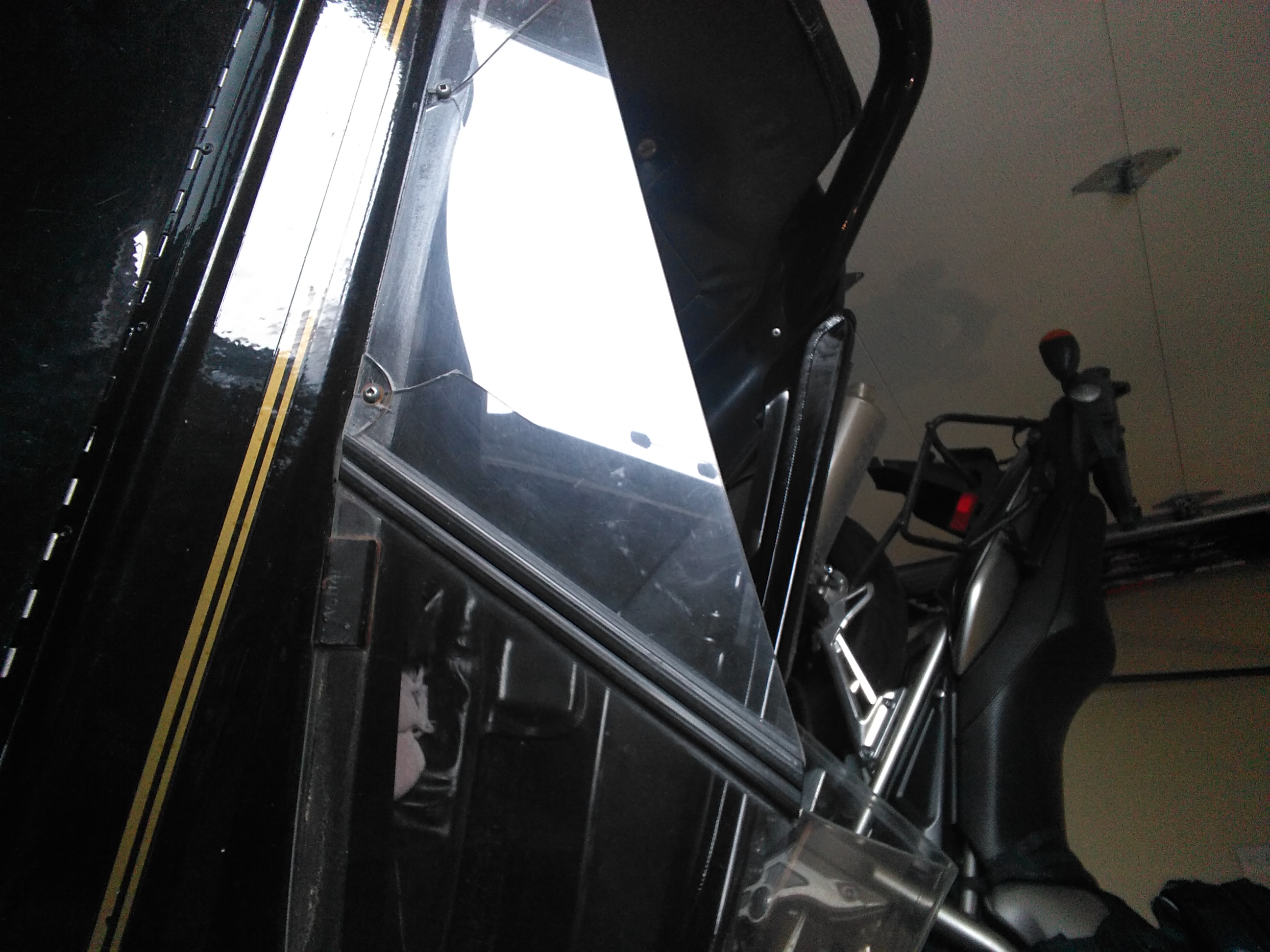

I own a Vetter Terraplane sidecar.
I need to find the part (or to adapt something) which joins the front windscreen and the side widescreen of the sidecar (see pictures attached).
I also would like to add a cover to ride under rain with my kid. Any picture or idea how to do it?

I can't help you with the parts, but I will share a tip: To keep the cracks in your windscreen from continuing to travel, drill a very small hole at the terminus of the crack.

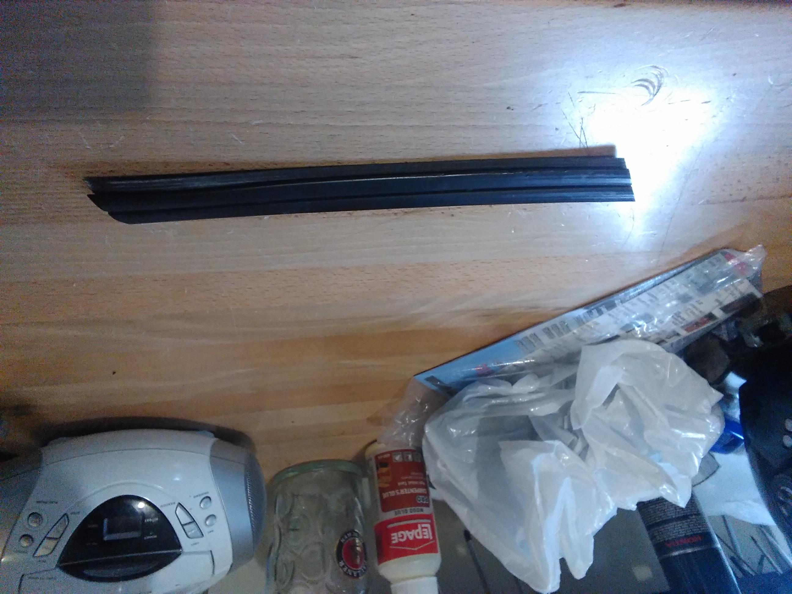

The picture looks like two pieces of "J channel" glued back to back. You might want to check out this...
https://www.mcmaster.com/#trim-molding/=17yilev
Scroll down to "trim for connecting panels" for a start but poke around, you might find something you like better.

Or maybe search the web for anyone selling small quantities of H-channel.
This is just an example, I have no info on this company so I can't comment, positive or negative on them.
http://www.acmerubber.com/hchannel.htm

I have a Terraplane also ( a new acquisition ) it has aluminum channels, maybe shower door? I'll try to get a pic and post it.
