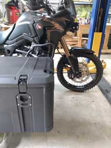

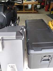

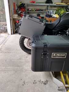

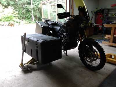

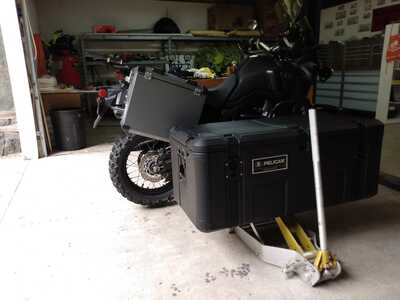

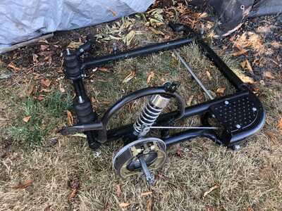

I just received the Pelican BX255 cargo box that will be used for this build, and already have lined up the Ural cT chassis that will be used.
In less than 3 weeks I take the bike down to Russell Day Long seats to have my 19th RDL seat built for me, then on the way home I drop this bike, and the Pelican box off at my metal fabrication expert in Oregon, and he does his "thang" whilst I jet off to Europe for a few months.

This completed rig should be done around mid-February, and will be BUILT with the intention of driving it up to the ferry in Bellingham, Washington, taking the Alaska Marine Highway ferry up to Whittier, Alaska, then driving this rig around Alaska, and up to Deadhorse/Prudhoe Bay, and back down to Whittier, for a ferry ride back down to Washington State.
Plan is to do this in 2026, 2027, and 2028...then sell it to one of you younger folks....so that you too can see The Last Frontier
Having done most of the roads of Alaska, the Yukon, and the Northwest Territories, I am used to the gravel, the rain, and worst of all, the Calcium Chloride that they lay down to make the roads as slippery and sticky as whale snot.
This rig will be built with that in mind, to go where other bikes or sidecar rigs cannot go, to carry-on when others say No Mas, and to clean up easier than most so that 6 months later we are not digging out dried on Calcium Chloride that dries like cement.
And yes, Scott, all three wheels will be tubeless, so tubeless tires all around. ALL forward lights will be YELLOW colored LED lights, even the Givi windshield in covered with a YELLOW tint, to protect it.
And No, Scott, there will NOT be a sidecar brake on the sidecar. There will be a custom built Leading Link front end on the bike, and...all shocks on the Leading Link and on the sidecar swingarm will be 2Win shocks.
Oh, and YES, Scott, I have already installed one of your company's ScottOiler's onto this bike, and it works perfectly, as usual.

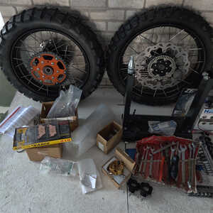

Questions:
  • What are you doing for a tubeless tire conversion?
  • Any thoughts to limiting the rear suspension travel to match the new Leading link?

Scott, my choices for going tubeless are to either make all three wheels tubeless using Outex kits, or ...have Woody's in Colorado make me new wheels, and they use the Outex kits, or order new wheels from KKE, a company in China, that uses rear tubeless wheel, new hubs, etc
The rear suspension on this bike is already done.... extremely firm and extra heavy duty spring from Racetech. It has almost zero squat, even with my lead butt on it

You had me at "yellow" 🤩  I saw the protectors with the yellow tint, as well as the windscreen.  Didn't realize you had done that yourself.  Came out very nice. 👍

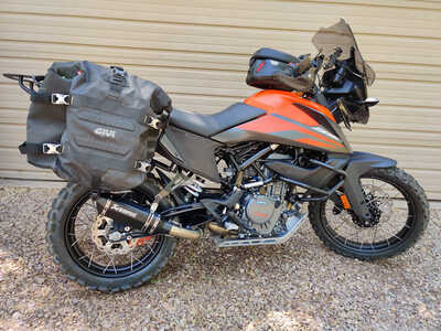

I had a set of KKE Racing (VMX) wheels on a KTM 390 Adventure.  Nicely built.  Needed a bit of truing, but nothing substantial.  The only downside was the brake rotor adapter they use on the front hub that made some of the spoke nipples inaccessible without removal.  The adapter mounting bolts were glued in place, and were quite a bit of work to remove.  Factory didn't know the torque specs ("assemblers just make them tight" was the tech response).  Pretty tough for off road, other than the very thin anodizing, which scratched pretty easy.  For the nature of the 390 Adventure, they were a reasonable purchase.  At the time I purchased them KKE Racing had a "pre-order" option that saved $250 of shipping fees.  Still received the wheels in a few weeks.
Here's a picture of them on the 390 Adventure, and ready to install.
Right Side
Spokke Tubeless Wheel Set
 For a quality bike I probably would have made a different choice.  I've read good things about the Outex kits as long as no "fix-a-flat" type liquids are applied.   Wonder if the '21 & up tubeless AT wheels fit the earlier models?

@scott-h The newer tubeless rims from a 2020+ fit, but you need to also have the newer rotors and tone rings.  Also need the newer front spacer.  My son is running the tubeless rims from my 2021 on his 2017, no problem.
I used the "rear" 18" size on all three locations, built by Woody's in CO.  No regrets with that choice.  Carry one spare tire that could go on any location, if needed.
All tubless, with Woodys using Outex kits, Haan billet hubs and Excel rims.  Seem to hold up good.  I have broken a few spokes on the hack wheel, but they were not too bad to replace.  Did not disturb the Outex seals when I replaced them.
