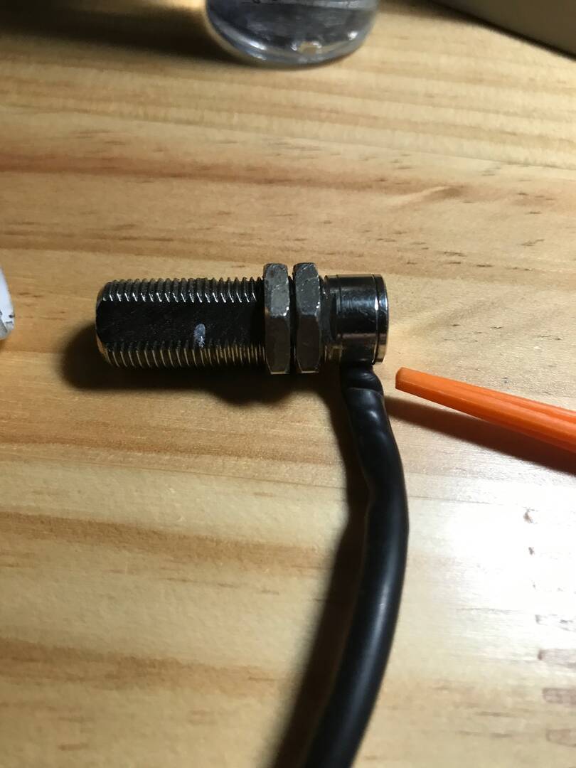

(@grymsr)
Posts: 15
Moving the sensor deeper into the case seems to have worked. Time will tell.
BTW- This is how the first sensor looked after extraction.
IMG 5052
If you look closely you can make out the wires twisted inside the shrink wrap.
