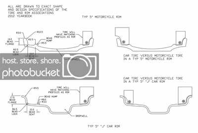

(@sidewise)
Posts: 128
@scott-h The 15" motorcycle rims are slightly larger than  the 15"automobile tires and do not lend themselves to darksiding without machining from what I remember of the commentary online  over the years.
Posted : March 5, 2025 5:23 pm

(@prmurat1)
Posts: 28
You mean like this drawing? I had my Vmax rear wheel machined just like this!
15 wheel
Posted : March 5, 2025 6:15 pm
Brstr and sheath reacted
