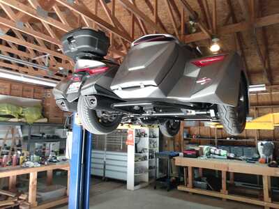

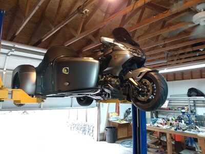

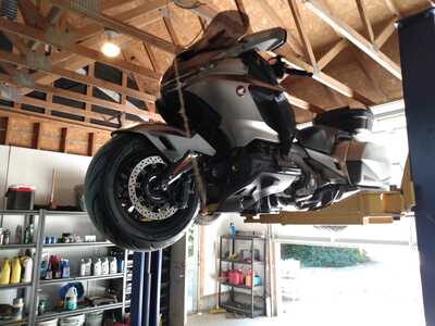

I will talk directly to the guy in their Service Dept that is the only one allowed to work on my bikes (generally I do everything on my bikes, except warranty or recall items), and I will ask him...how deep does he need to go to do this recall on the primary drive gear bolt on the crankshaft. It "may" be very deep, as in remove the entire engine assy kind of thing, or....it "may" be quite accessible, as in remove a front cover, and the primary drive gear bolt on the crankshaft is right there.
I shall do my homework...NOW !
Nerd
EDIT: having now completed my homework, I am certain that m,y local dealer IS going to request that I remove the sidecar from my '19 Wing.
Technically, this recall can be performed and completed by an experienced and willing mechanic that is willing to do the work needed/necessary on the LEFT side of the bike, whilst also reaching under the left side of the bike, but....knowing my local dealer, they are going to want to put this bike ON their bike lift, and do it whilst standing up, or accessing from under the left side of the bike. And while they also sell, and work on sidecar by sides, and 4 wheelers ATV's, I have to allow them to do it "their way", rather than push them doing it with the sidecar attached.
OR....being the 3rd greatest mechanic myself (# 1 and # 2 shall remain unnamed), I may just elect to do this myself, in my own shop, with the entire sidecar rig UP on my full car lift, alleviating the need to remove the sidecar from the bike.
