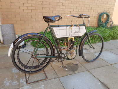

Interesting isn't it.
Once you commit to going after a project.... then things have a way of falling into place.
My friend Dennis proves that anually.
Set himself a goal of restoring a pre 1931 bike a year for 10 years.
Year now?
For one bike that is now the oldest registered motorcycle in Western Australia, the 1903 Minerva Romania.
He bought a kerosene headlamp then sent a message to a fellow restorer.
Got the headlight, just need the rest of it!!!
Next came the ignition unit.
A trembler coil. (And they work well)
Then the engine and it was on for young and old (me to)
20231006 100717
Posted : October 15, 2024 8:15 pm

Posted by: @brstr
how come i cant post the picture of that cool minerva?
heavens
that minerva is way out of my league.
are there any brakes on that? im not seeing anything, unless theres a coaster brake in the rear hub
maybe it doesnt need brakes, like you just drag your feet?
i do that on my race bike, because i pry the pads away from the disc after the safety people look the machine over. then the brakes dont work well, but i dont use em anyway.

Posts: 524
I that is such an amazing thing to be able to use the same specialised tools from a decade or more ago.
Maybe with the magneto you could go really old school.
Fit a manual advance and retard lever....
The Minerva got a simple bicycle front brake after this picture.
It has a back pedal brake from the period.
Dragging the feet works best from 30kph or so cruising speed.
Posted : October 21, 2024 6:34 am
