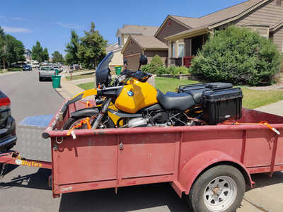

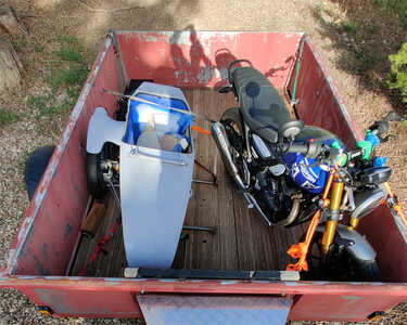

I have an old Big Tex utility trailer 7' wide by 10' long.  Bought used for a good price.  It is ugly, heavy, and works.
Purchase Pic
Home Safe
Posted : September 3, 2025 6:23 pm

Important things from my perspective are:
  • Proper load capacity.
  • Wide enough to fit the sidecar rig.
  • Long enough that when loaded the tongue weight is correct.
  • Solid tie down points.
  • Total weight within the tow vehicle limitations.
  • Not so wide that the tow vehicle mirrors can't see around the trailer properly.
In the picture above with the yellow sidecar rig, you'll notice the rear motorcycle tire is pretty close to being centered over the trailer tires.  Sidecar rigs are very rear end heavy.  If the trailer is barely long enough to fit the rig, chances are the tongue weight is going to be too light.   I like long trailers for this reason, and also the longer the trailer the easier it is to back up.
