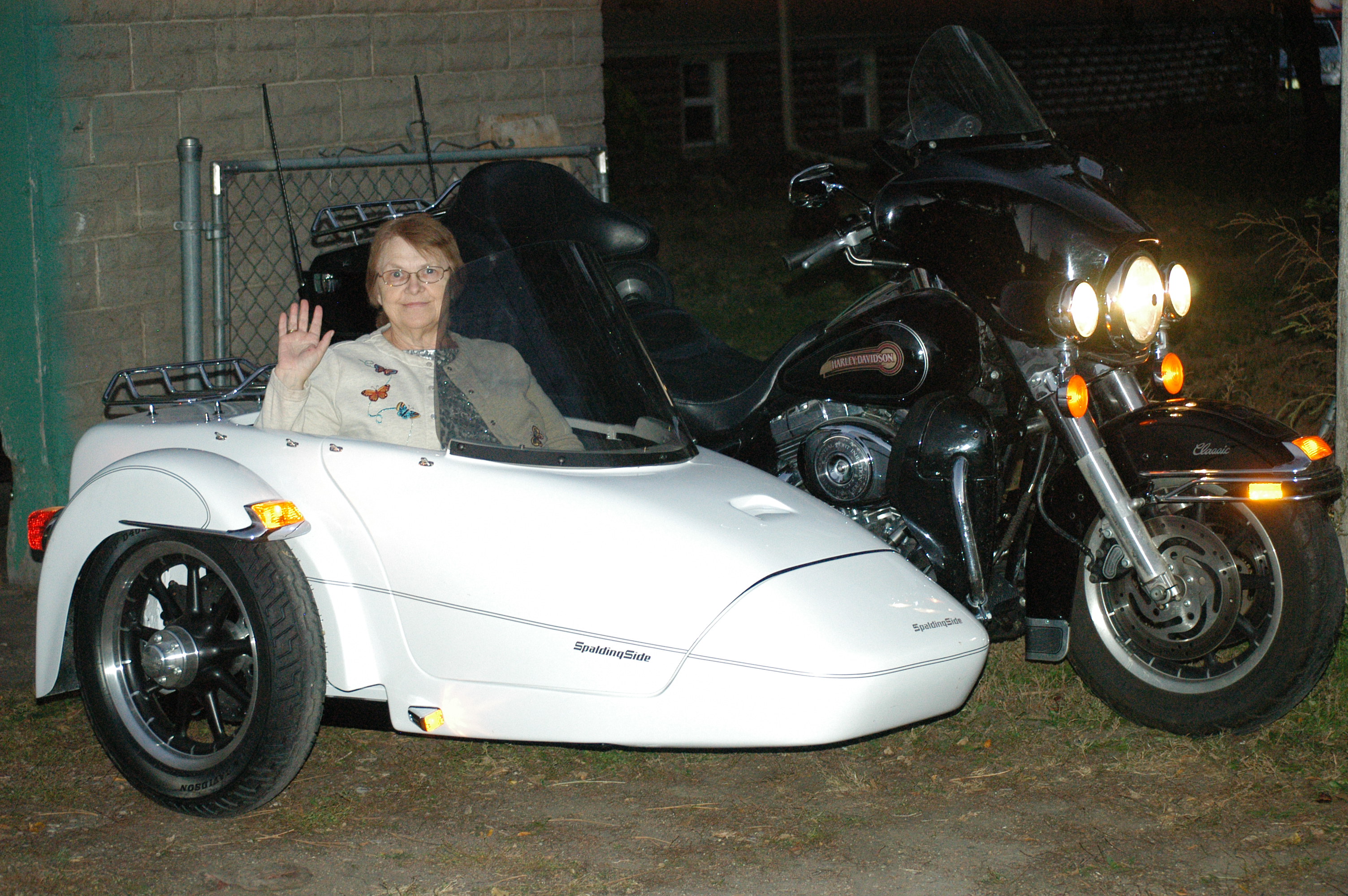

My Doris and I had our Spalding sidecar installed yesterday. Learning to drive it. Pulls the right most of the time worse under acceleration and then to the left when braking. Getting alittle better driving it. Practiced in the cemetery, lost of right and left turns and no traffic. It seems like it is a lot of work to drive the rig.

 The Spalding should be a comfortable sidecar for Doris. The offset dynamics of all rigs results in pulls right under acceleration and then to the left when braking - it's something you become accustomed to with experience. However, you should be able to minimize the pulls right most of the time by "tweaking" the alignment. It can take several adjustments to find the optimum alignment.
Yes, rigs do take more physical (and mental) effort to ride/drive than a 2-wheeler. A little extra air pressure in the front tire can help. "Raked trees" -that is, modified triple trees to reduce trail for 3-wheelers- make the steering much easier, as well as minimize the effect of changing load/road conditions and handlebar "bucking" on bumpy roads. I'm a proponent of such modifications - after installing on my Sportster rig, I went from riding 1/2 day breakfast/lunch rides to comfortably riding all-day on back-to-back days.

As you gain experience, you'll learn to anticipate and even use the yaw introduced by the non-symmetrical nature of the beast. And I agree with SwampFox, modified steering makes a world of difference and is the way to go if you plan to dedicate the bike to sidecaring. Some pilots like to keep factory steering geometry for those times that they want to dismount the car and ride solo. Something I would NOT recommend once steering trail is removed.

A bit more bike lean out should take care of the tendency to pull to the right if you have 3/4" toe-in.
You must compromise if you don't have the ability to raise or lower the suspension on the fly.
Freeway riding will add wind resistance. The faster you go, the more pull to the right.
Passenger or other ballast weight will also add to the right pull, as will crowned roads.
Pick your most used scenario to tweak the lean out for your best neutral steering (usually 1 to 3 degrees with 3/4" toe in). I use a magnetic protractor for this placed on a brake rotor.
