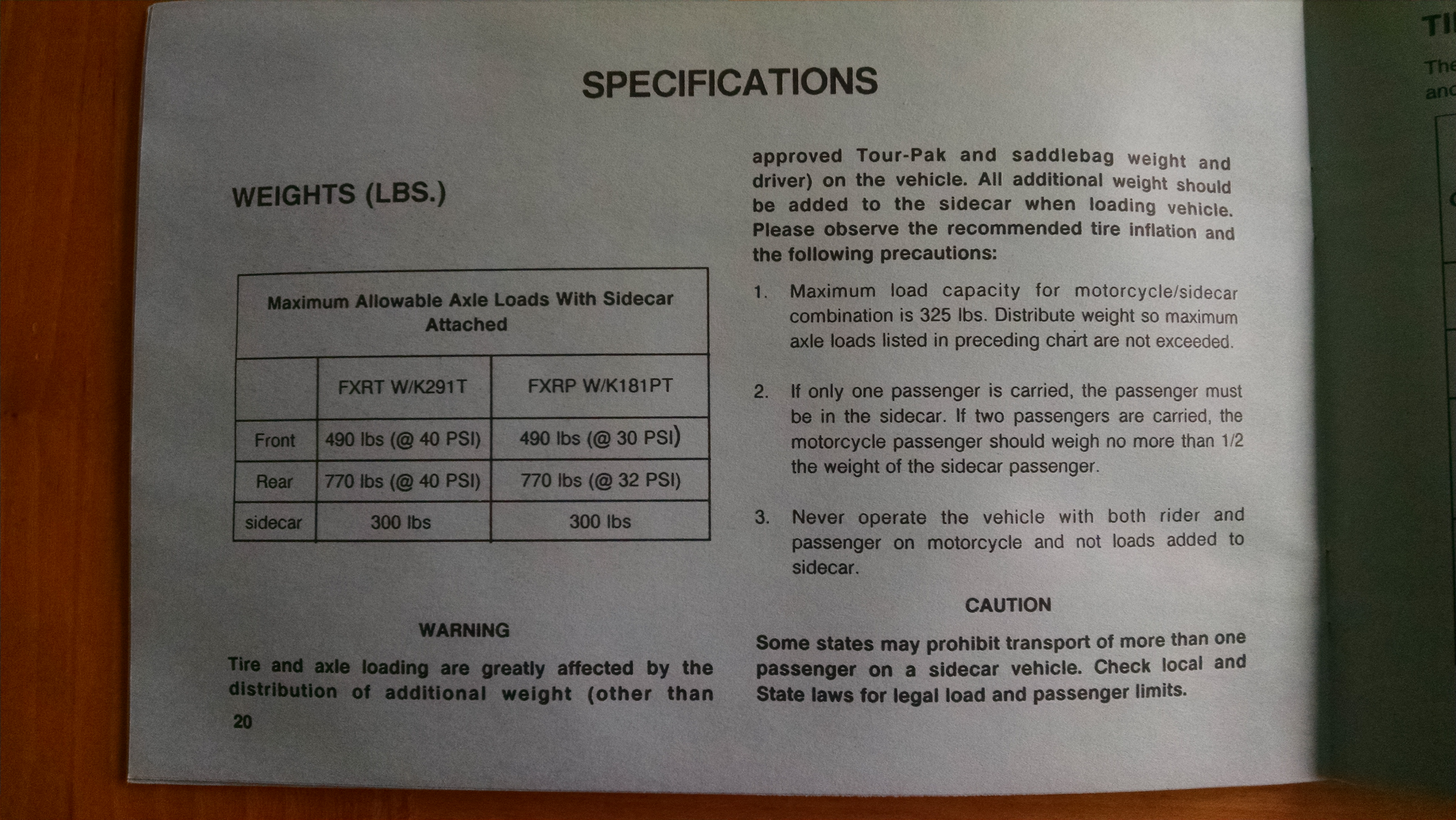

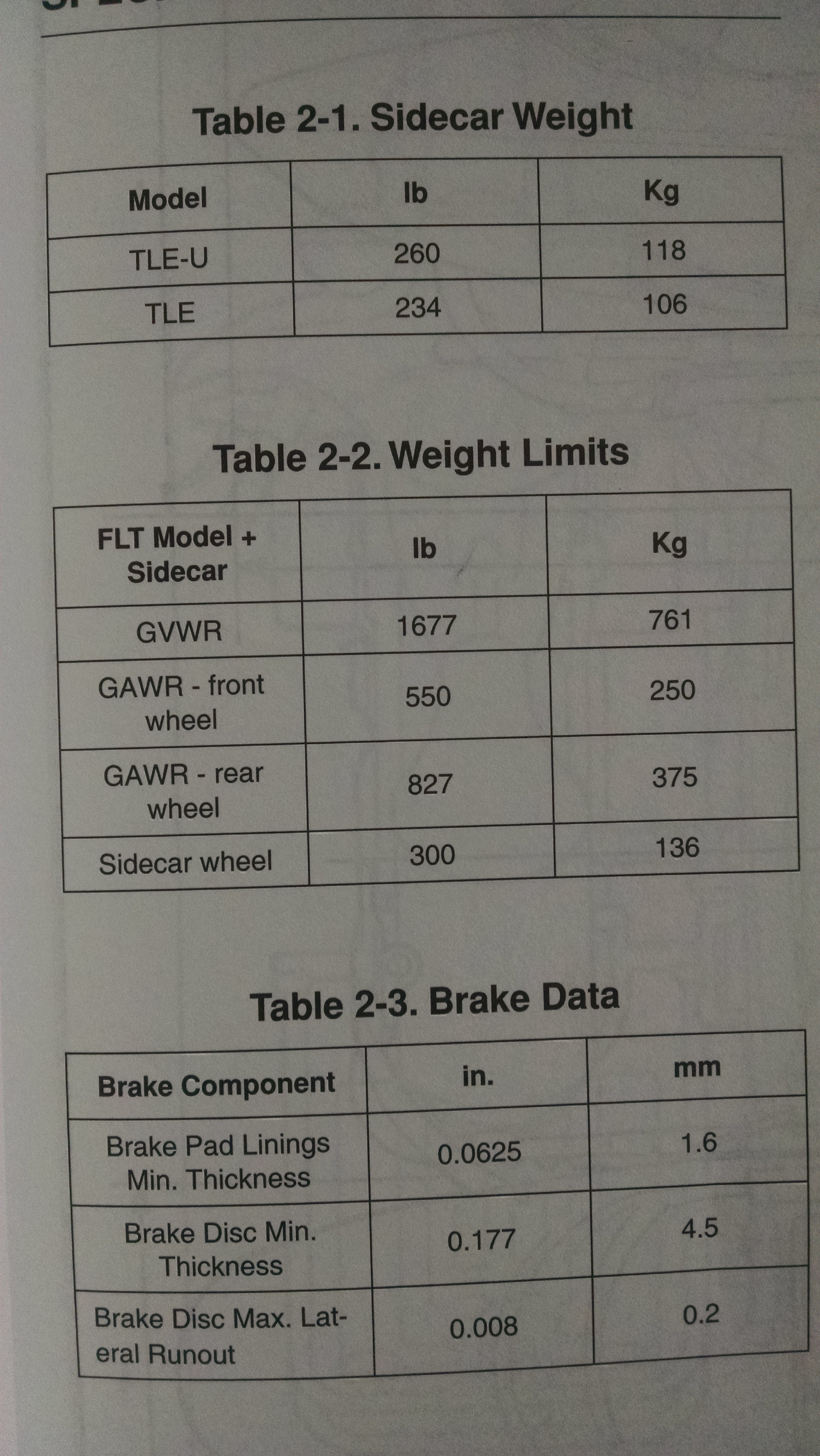

I'm not sure how helpful this will be, but I'll post these anyway. First is a page from the 2005 Harley sidecar service manual. The service manual only has this information, gross vehicle and axle weights, not specific load capacity for the sidecar. The second page is from an RLE sidecar owner's manual (the sidecar model they mounted to 1980's FXRT) That page gives you some general loading guidelines but the numbers won't be right for your combination. You can probably find a sidecar owner's manual on eBay that will give you the information for your bike's year.
