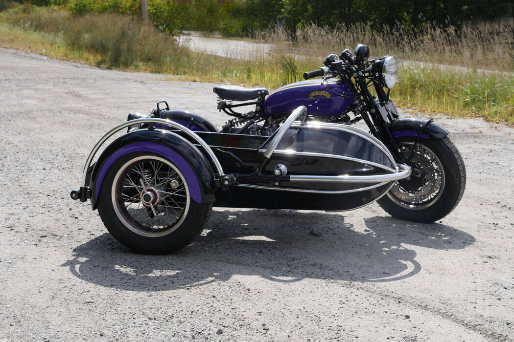

Mine is a 1952 Vincent Rapide with a 1952 Bender chair.  I built it over many years while riding solo with a mind to needing it when managing vintage bikes became questionable.  It's not stock......

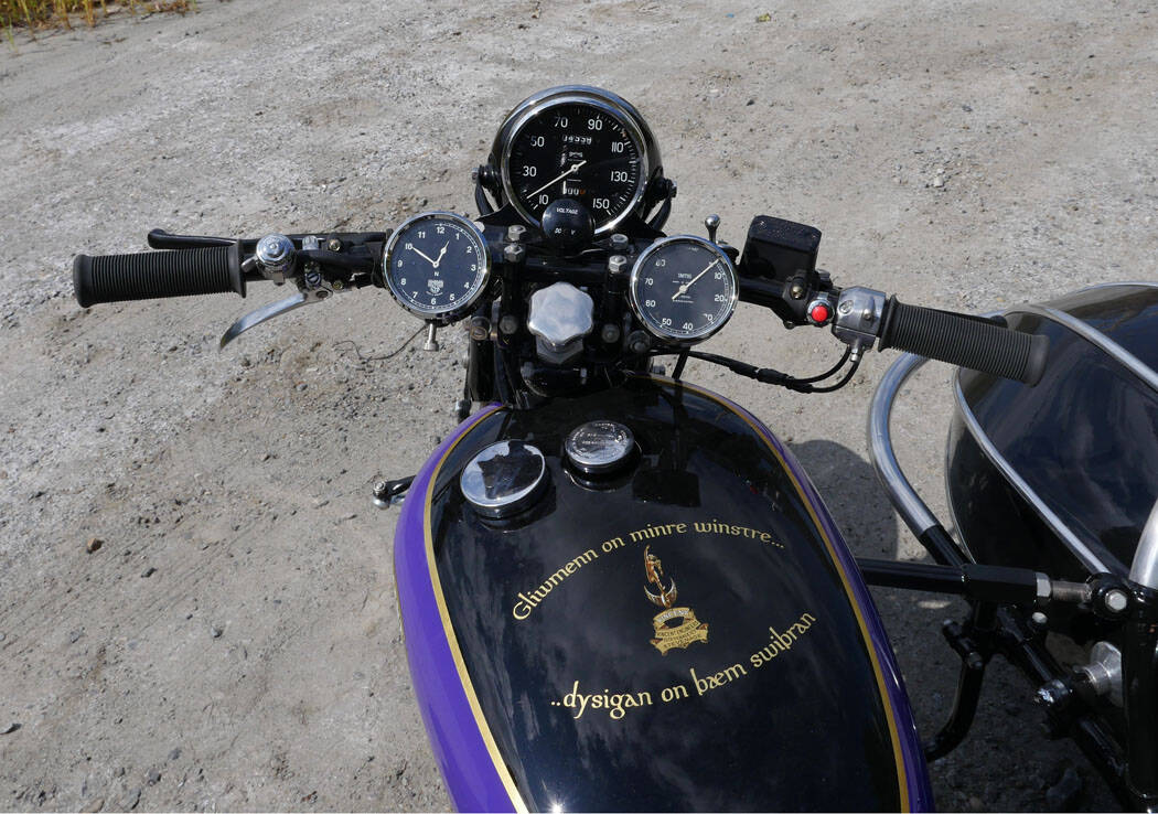

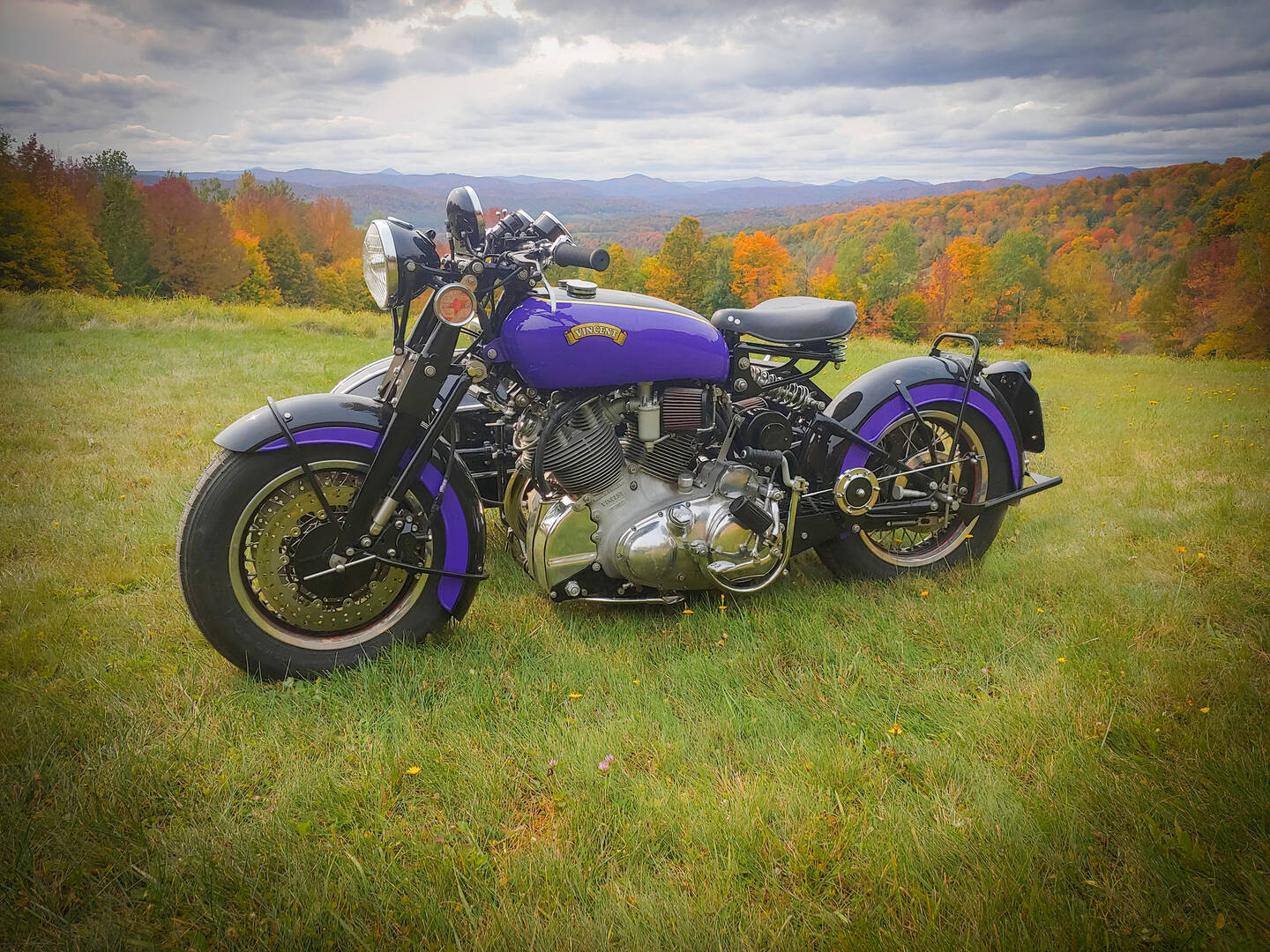

Jim Young Sidecar 1 2
JVY4
JVY2
Posted : September 22, 2026 6:04 am

Thanks for that.
Great to see it being used.
Mods done in keeping with staying alive on the roads. (Disk brakes)
There's probably?
Ignition,  carbs? And the best would be the electric leg?

Regarding outfit safety, a good friend and long time fellow Vincent rider commented, "When an 18-wheeler can stop faster than you it's time for an upgrade", hence the dual 310 mm rotors forward.  They were the only ones I found dished enough to allow fitting without mods to the stock hubs and forks.  They are actually more than enough and I may remove one.
Ignition is by a modern BTH mag and electric start is fitted along with the left hand kickstart crank (just in case.....belt and braces you know).
Carbs are stock small bore to guarantee fuel vaporization at low revs while 6.8-1 pistons and Lightning cams provide lots of torque. It pulls like a freight train.
