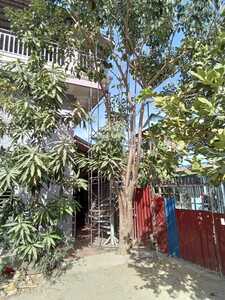

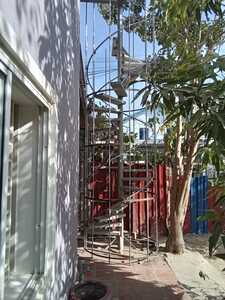

This mornings pic shows some flatbar bands so I can sheet it for weather and security.
More to come.

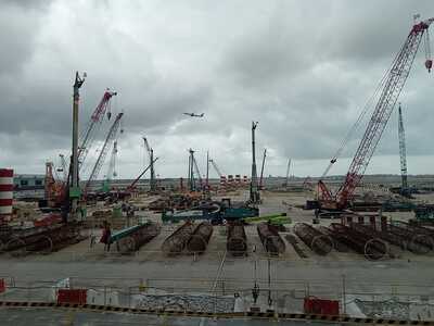

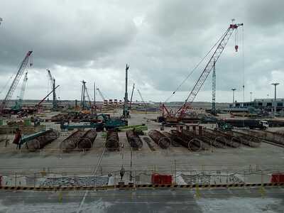

Changing airport.
Always something happening

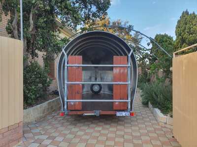

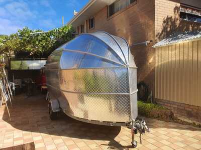

Satisfied with way the trailer took shape.
Welded a couple of brackets to the ramps.
The hinge pins came from a mini skid steer loader I had years ago.
Waste not etc.
Holds the back of the body very rigidly while travelling .
Just need to load it up and put it over a weigh bridge.
Pretty sure I'm within limits but need to see for sure.
Heading to the Bunbury 2 day bike run.
Will see how it performs as a loaded rig.
Put on by the Indian Harley club.
Yeah bizarre taking a vintage  car to a bike run....
Should get some attention on the total rig though.

Very well done, Bruce. And you can fit your antique Fiat inside there ?
Can we guess, in advance of you weighing it, what we think the weight of the empty trailer will be?
640 Kilos.....or 1,408 lbs.

Looks great!  Besides the really cool design, and build quality, a couple of things grabbed my attention, the center mounted rear stabiliser, and the pivoting hitch.
Very well done Sir! 😎
I'm under-bidding Sir Miles and going with 601.01 kilos (1,325 lbs).   Whatever the all up weight, here's to positive vibes that it meets your expectations! 🍻

The little Fiat fits with a couple of inches to spare length wise. Should be able to squeeze along the sides as well.
Miles 640 kg is close to the mark.
I'm thinking just on 600kg but need to take it over a weighbridge to be sure.
The car is supposed to be 650 kg but is just on 750kg for some reason.
I think when the body work was redone they went heavy plywood rather than whatever timber was originally used.
It was shipped with a wire mesh and canvas body apparently.
And an Ali body was fitted here.
Twice.
Max on the trailer is 1400kg so while I maybe able to load the car with a full tank.
Extra jerry cans would be pushing it.
There is a possibility I think of a weight upgrade
More capacity would be nice but discipline will work.
The Dodge will have to make up the difference.
It's rated at 6000lb loaded with another 4000lb towing capacity.
So water, tools, camping gear etc go in the back.
Have plans for a lift up door for camping etc but will check weights 1st.
Overall it seems to have worked out OK.
