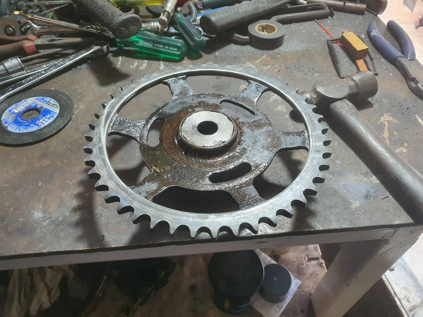

Cut the teeth off the new yesterday.
And cut the old sprocket back yesterday and today.
Did a slight step cut on the new.
Different diameter one side to the other.
Meant when it went over the old it was already true...
Well to a point.
Wondering how to fineness it a bit as I weld it.
Here it is.

Posts: 730
It seemed good at this point.
But
And not a good but.
Didn't do the weld right and it pulled out of round a fair bit.
Wouldn't have thought it could.
May need to do again.
A bit frustrating in that there's so much other stuff needs doing........
No idea how I had time to go to work...

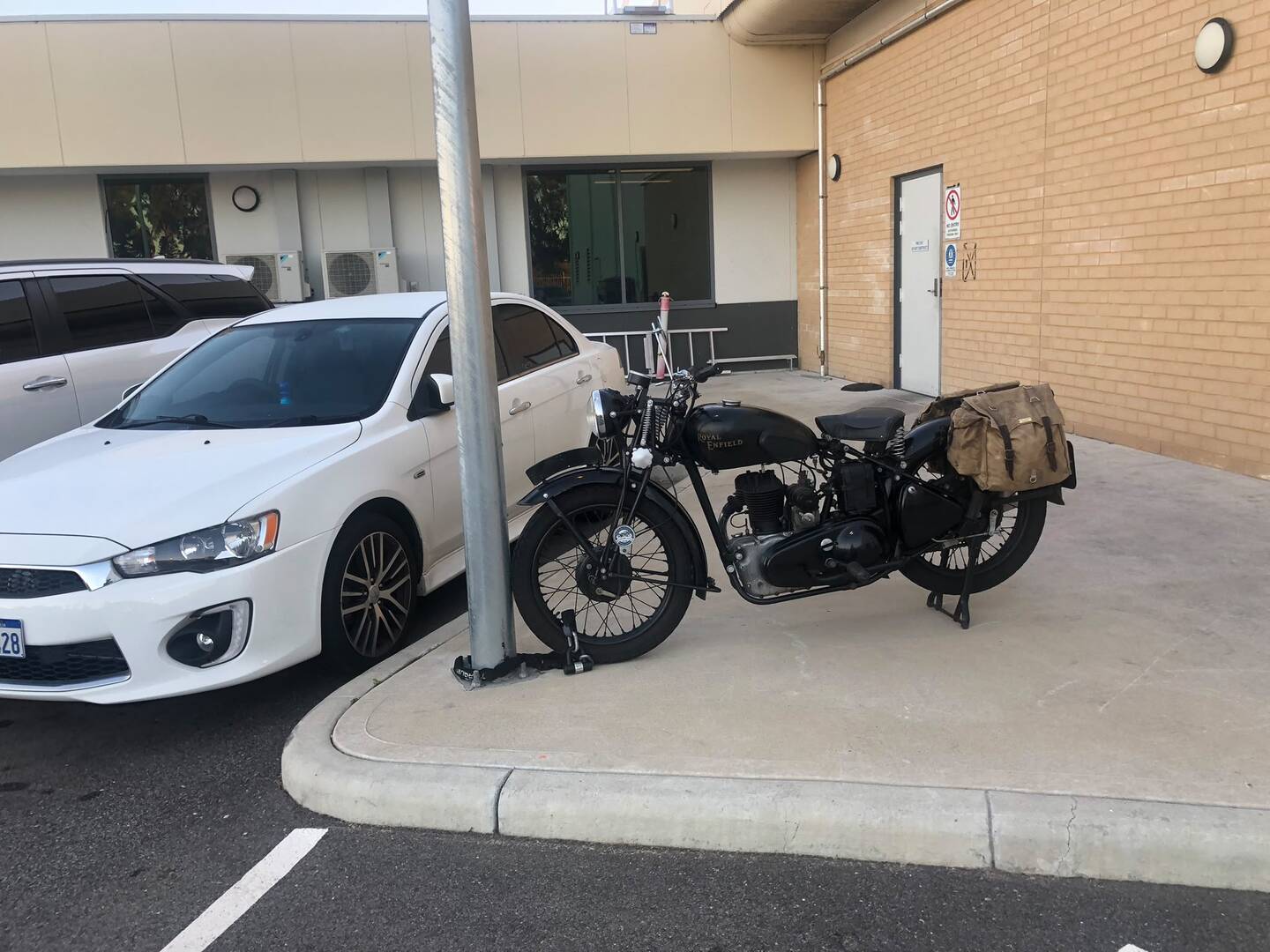

Speaking of going to.work Dennis decided to ride a couple of his old historic registered bikes to work.
1st the 39 military spec royal Enfield ( 350 sidevalve  )
Including the dispatch rider specific saddle bags ( again 1939 ).
Then the RD350.
IMG 20260604 WA0001
IMG 20260605 WA0000
On historic club licence the vehicle is basically only to be used on club runs.
Or for testing and tuning.
The test was how long it took to get to work.
16 mins on the 39.

The sprocket pulled out of round rather than just buckled sideways.
Which caught me out a fair bit.
Should have preempted it but not so this time.
So cut of and replace as it's already heat treated.
Annoying but that's experience gained and Dennis is paying.
I just wasted a couple of days.

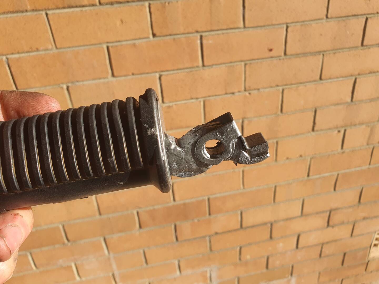

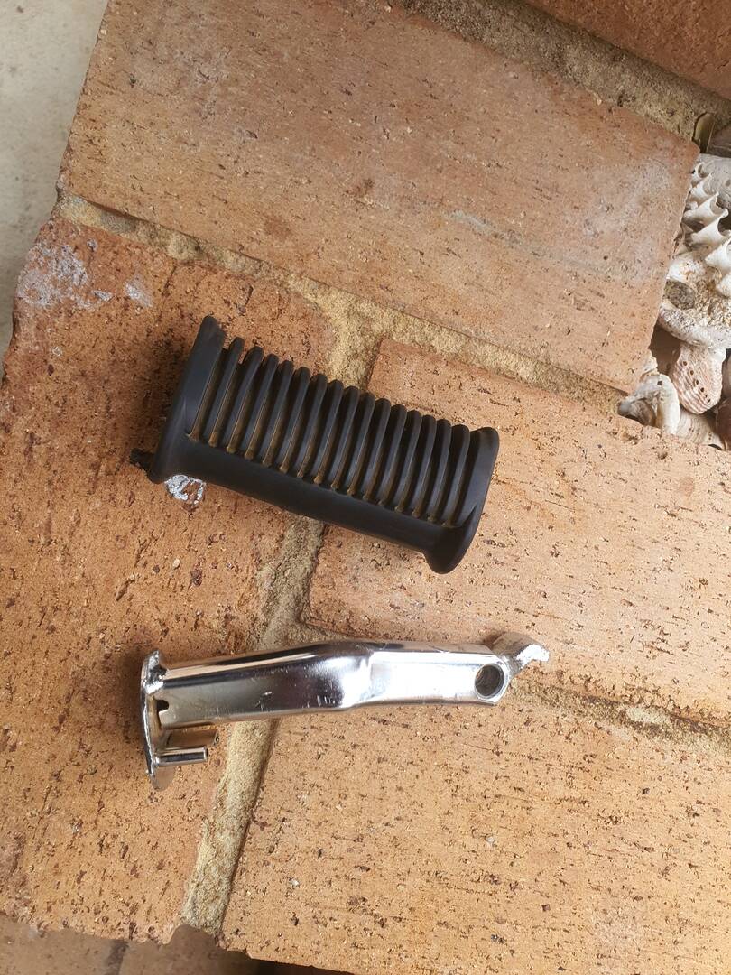

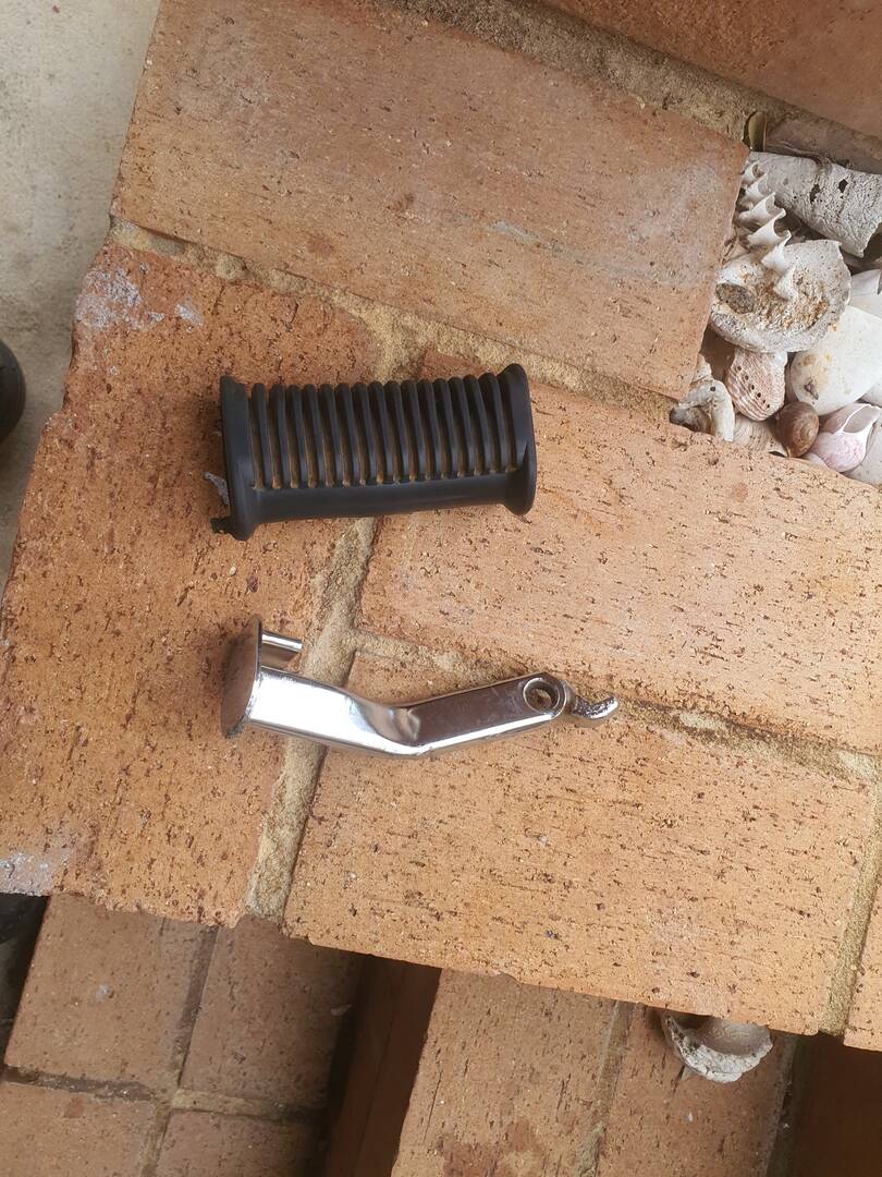

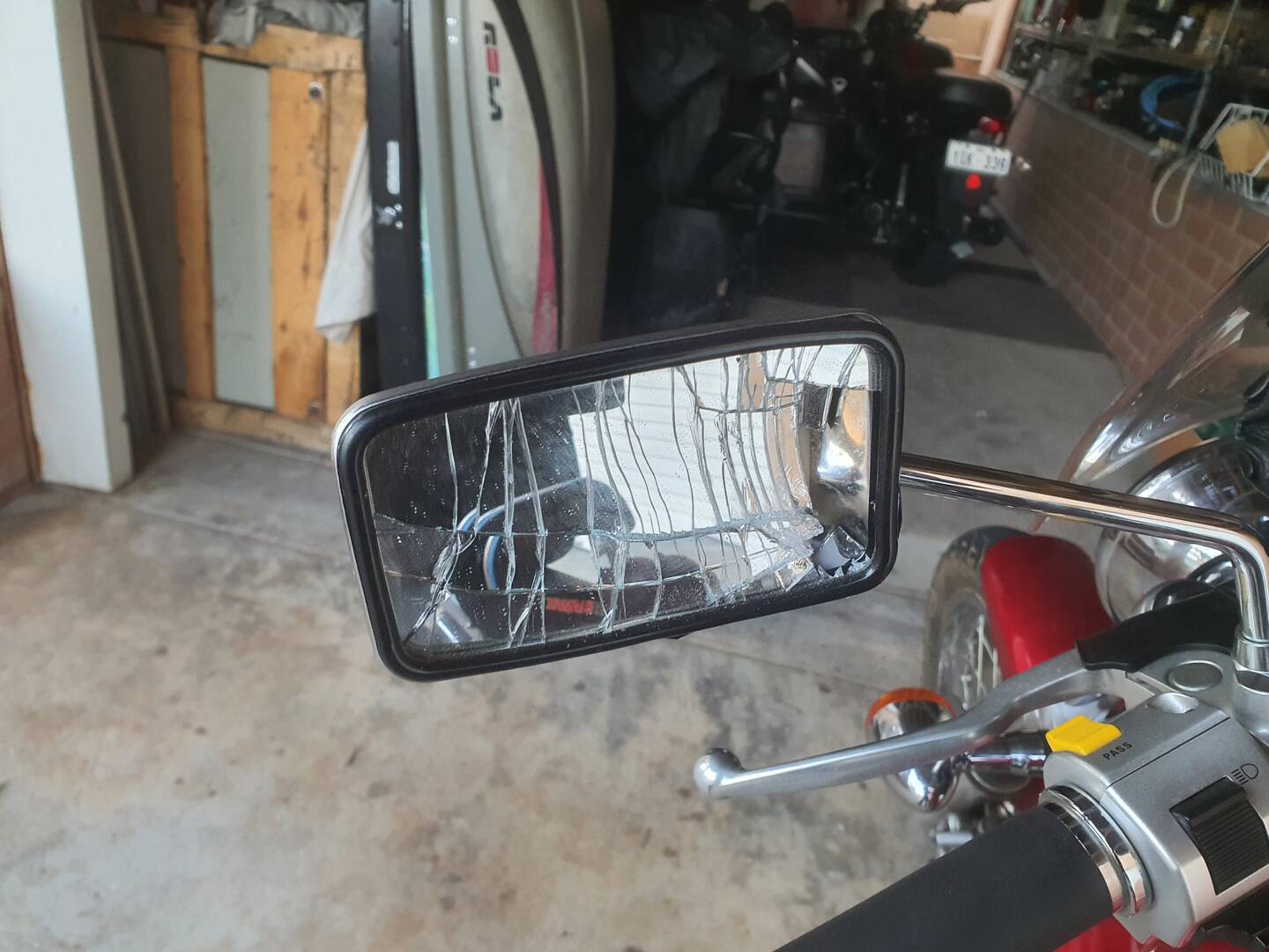

Damage in pics.
Banana bent peg and smashed mirror.
I had noticed those forward pegs touched easily.
But the minimal hinge ability I'd not realised
Will see if it can be opened up some.
Had already been thinking a chair would suit this bike.
Thoughts confirmed.
Embarrassed?.. meh too old for nonsense.
At 70 you have to consider on going skill levels etc.
But pretty sure this was a bike specific fall.
Press on.
And the peg out.
And replace the mirror.

Might head out today to see if I can find some simple round mirrors to replace the little rectangular style ones..
The actually foot peg may straighten depending what I find with its rubber removed.
But to prevent a recurring episode I will be looking into how the pegs can be made to hinge more then the current setup.
Not sure how Suzuki got away with that and for 30 yrs making this model.

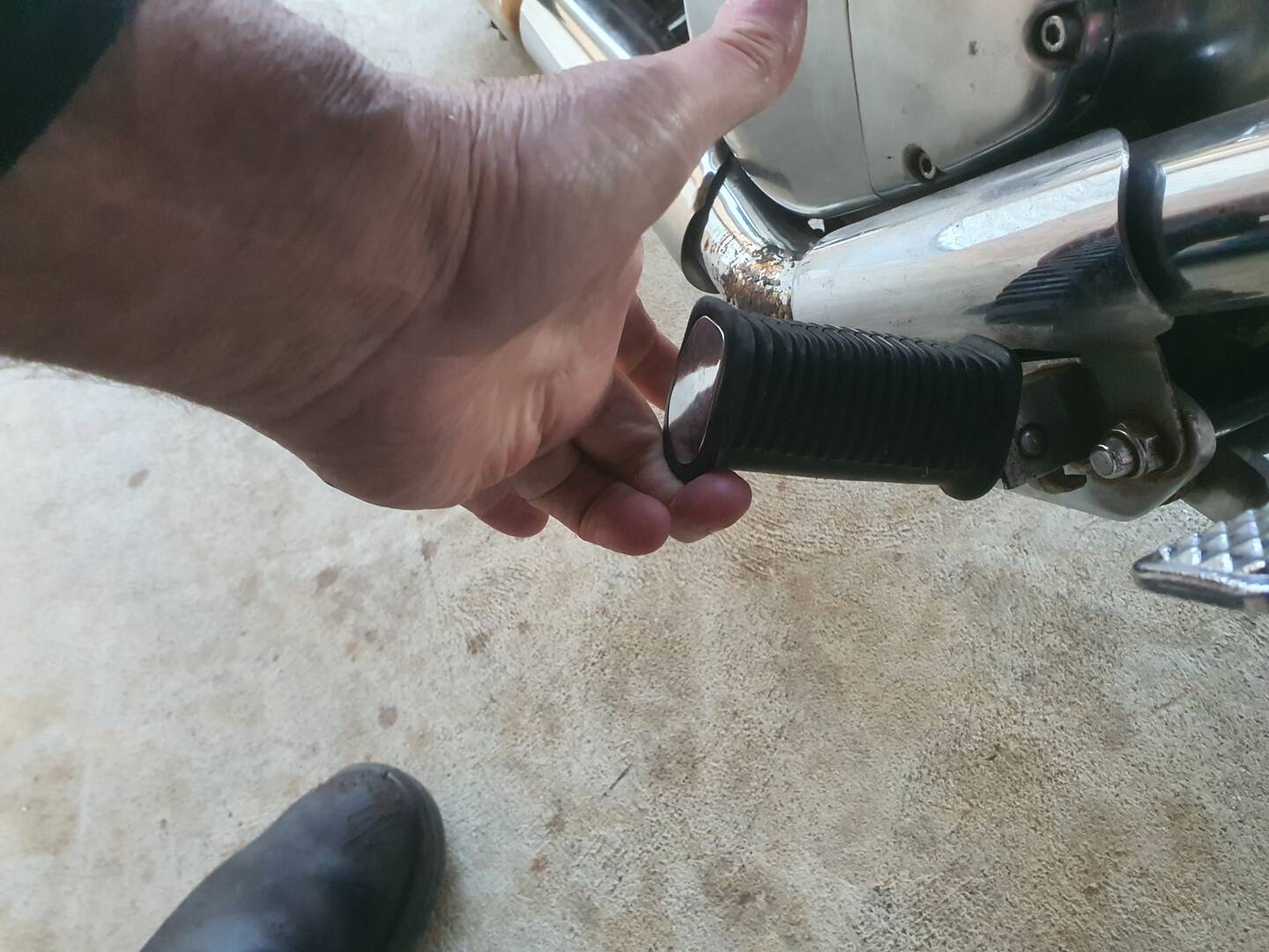

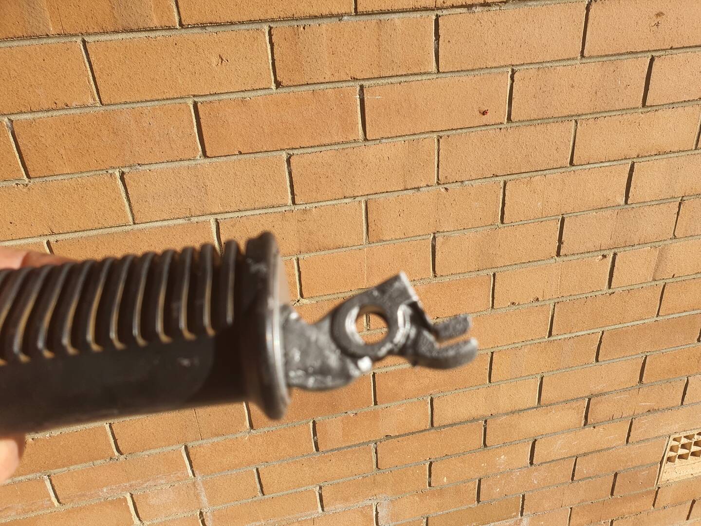

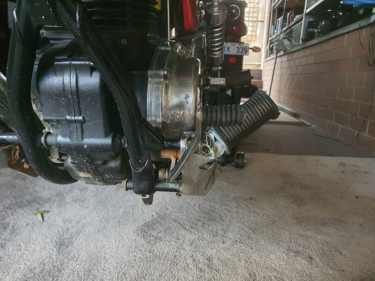

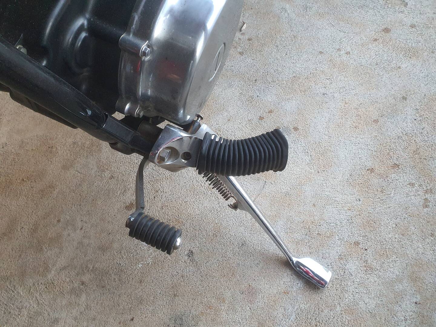

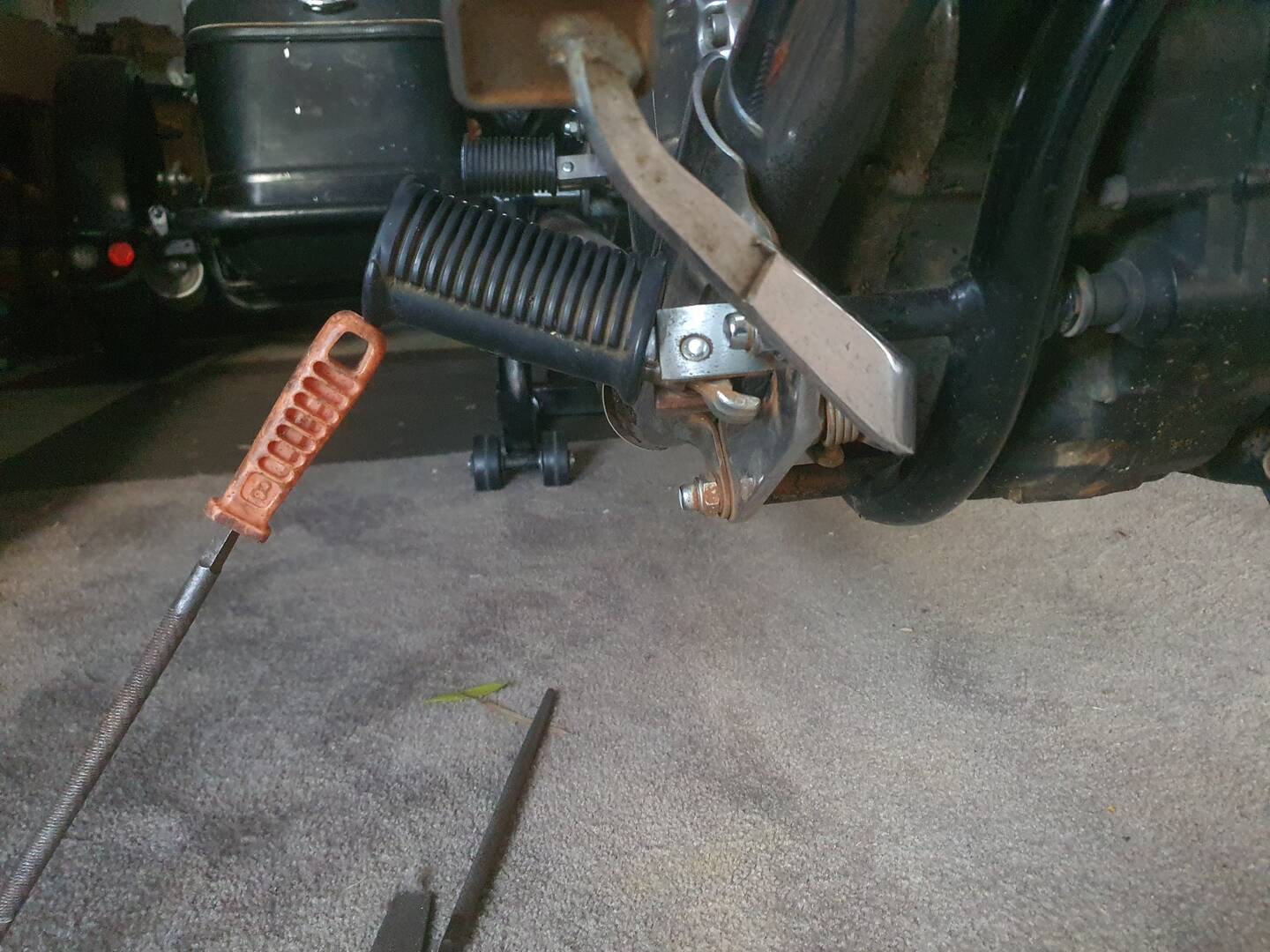

Posts: 730
Ok the peg is straightened and bends up further,  though not as much as I would like.
Took all week to figure a simple solution.  ( read cheap ).
Was actually given  a pair of mirrors though there maybe a favour involved at some point.
Solution was to add a bit of metal one side and notch the other.
The chrome mounting block it fits in also houses the sidestand.
I think designed not by engineers but by the stylists.
Possibly not a huge amount of saki involved but some.
A fair bit for the engineers as while the mounting block does its job it isn't hugely practical.
Looks good in a chrome kind of way though.
Ok.took all day making it fit.
And work better.
Lots of grinding, fitting, filing, fitting and repeating.
It's about 17mm longer which is a slight backward step but necessary and good for the big boots ( size13 )
20260630 153306
20260627 153112
20260627 153117
20260630 153303
Hard to see the angles but should he enough to stop another carpark laydown.
On the left anyway.
Will sort the right latter.
Famous last word.
Right peg is stock and modded left peg.
20260630 165000
20260630 165043
Posted : June 30, 2026 4:47 am
