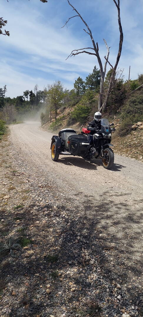

Got out today for a leisurely romp in the desert out and around Florence, AZ. Some familiar roads and a few that were not.
It was a lovely day, started out about 68 F (20C) and at peak, hit about 93F (34C). Really couldn't have asked for more pleasant weather.
Met up with Greg and headed out, with no specific destination in mind, other than turn off and take some of the roads we ride by, but don't take.
Turned down one such road and found it to be kind of slalomy with ruts that alternated from one side to the other. Lots of little washes with either regular sand, or occasionally washed down to black basaltic rock beds. Plenty of Cholla to help you plan which lines made the most sense.

Overall, it was a very pleasant day and found a few more roads to go explore when the mood strikes!
Nothing broke or fell off, so there is that, as well!

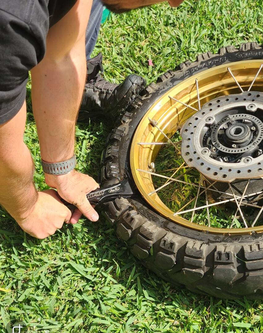

Motion pro bead breaker levers worked well:
capture temp

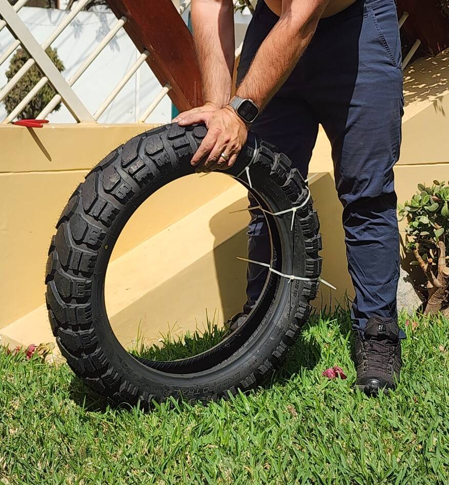

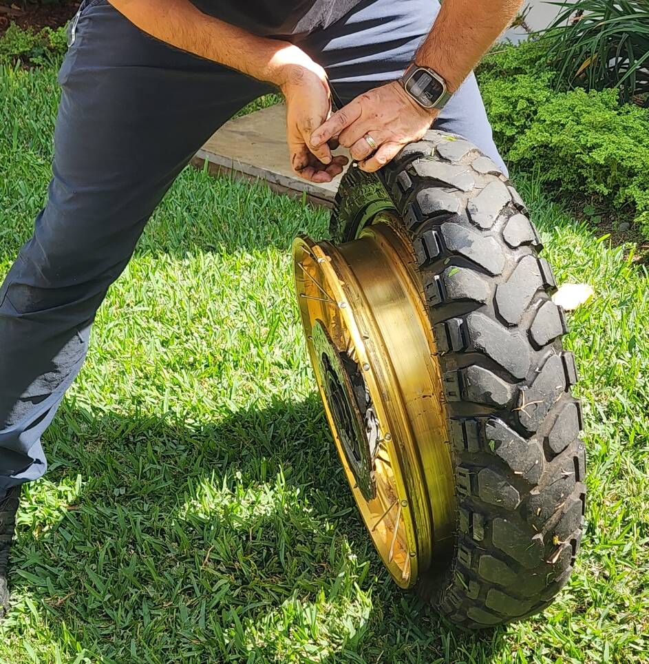

Used the zip tie method to mount new tire:
capture temp
capture temp
Beads seated with mini-battery rechargeable compressor at 18 psi (plenty of lube in kit.)
