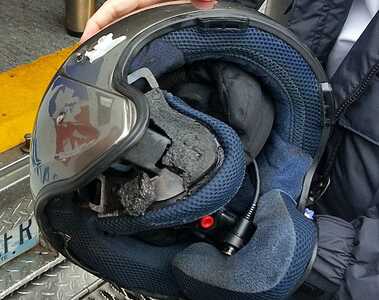

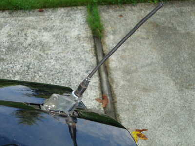

As an example for comparison:  My 2013 Honda F6B that I was on when struck by lightning, and the lightning proceeded down my helmet headset cord, through the bike's audio system, through the ground system of the bike, and shot out the small antenna of the bike....it too was put into Limp Home mode, but even in Limp Home mode I still had enough power to hit 75 mph. That bike was a manual 5 speed, not a DCT, so trans was not affected, but I am surprised that the Limp Home mode on your AT-DCT only allowed speeds up to 30 mph, and would only shift into 1st gear, and not a higher gear.
All caused by an abraded ABS wire............................Hmmmm...............
Lightning went IN here:
Russ Brown news lightning hits rider
And came OUT here:
DSC01005
Oh, and everything in between, was a $ 10,200.00 barbeque Head Explody
