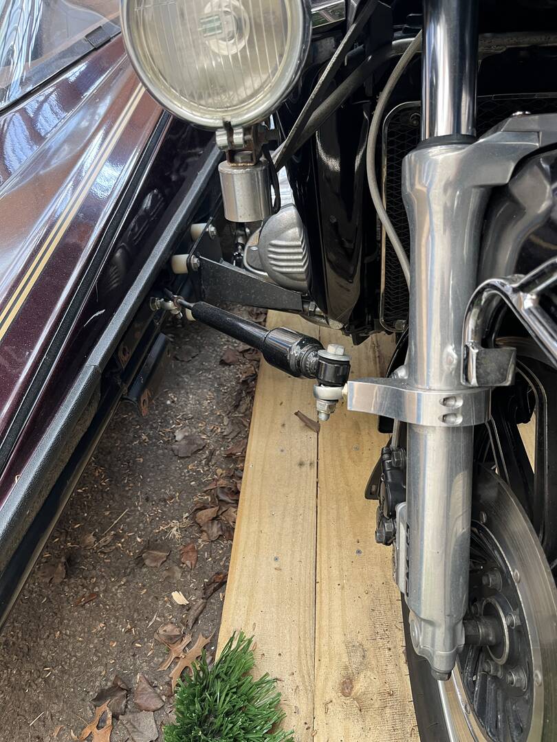

Looks time to figgure out a steering damper? It looks like i have 8"+ from the leading link fork to a support strut. Any ideas for a source? the VW style damper are quite long
IMG 3526

And to answer your question. I use the VW cylinder from fork to car front corner.  Pic soon
Posted : April 4, 2026 6:34 am
