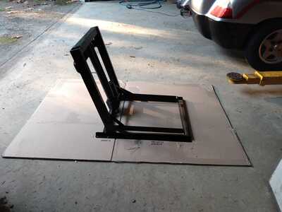

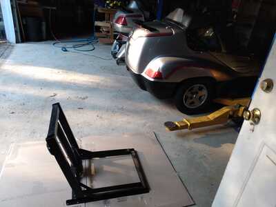

And now.....a preface to the surgical operation:
If you remove an organ from the human body, it could be as simple as an Appendectomy, or as complicated as a Hysterectomy.
In this surgical operation, I shall be adding this:
IMG 20241204 134856251
To the interior of this Sidecar:
IMG 20241204 134905821
Therefore, we have the new surgical term:
Addalifttome

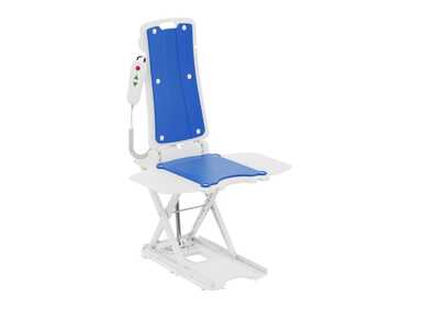

I bought a bath tub lift for my MIL years ago and thought it would make a great start for a sidecar lift.
IMG 1731
Cheap enough (as little as 300 on Amazon) to just scavenge the base part that holds the motor and lifting mechanism and adapt to your hacks floor and chair. No wiring needed if you use the built in rechargeable battery.  There are also floor lifts that might be better but I’m not familiar with those.  Search  “bath lift chairs” on Amazon. AFAIK they are all 12 volts and have everything one would need. Some DIY engineering would be necessary.

Posted : December 7, 2024 1:07 pm

Well..........the electric chair lift job is done...completed...finished. !
I will say, that of the 12" of actual lift that this electric chair lift offers, when NOT installed in a sidecar, we are only able to use 4"  to 5" of that overall 12", because of how it needs to be installed inside the cabin of the sidecar.
However, when all is said and done, that 4" to 5" is enough to make it much easier for my Boss Monkey to get into, and out of the seat.
I do need to state, that this electric chair lift is almost useless on any of the sidecar rigs that have the large wrap-around windshields, like the Hannigan GTL, or the Hannigan Astro models, because....when installed, and even in the lowest position, it raises the seat at least 2.5", and brings the seat forward 3" from what it was before the electric chair lift, so....with the large wrap-around windshields it now places the Monkey's helmet in the very middle/center of a rather small opening between the windshield and the back of the inside of the sidecar.
This electric chair lift would be much better with a sidecar that has a flatter windshield, like my Hannigan Dream sidecar, or any other brands of sidecars that have a flatter windshield.
Frankly, a much better electric chair lift CAN be built, and it would be one that not only lifted the seat, but at the same time also tilted the seat slightly forward, much like some of the electric recliners do for home use.
I would politely suggest that if anyone is interested in these electric chair lifts offered by Hannigan, talk to me first, as it may save you a bunch of money. If it works for you, great, but if it won't work for you, let's discuss it first, before you spend the money.
Posted : December 7, 2024 5:41 pm
