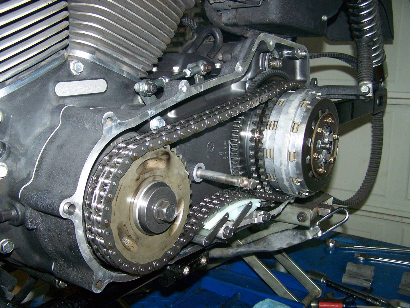

Here is a pic of the latest style adjuster on a 06' Harley Dyna. A model with many first year designs, and many first year problems. Self adjusting, but only tighter, via a toothed spring loaded bar. Many aftermarket alternatives available, including Hayden Enterprises.
